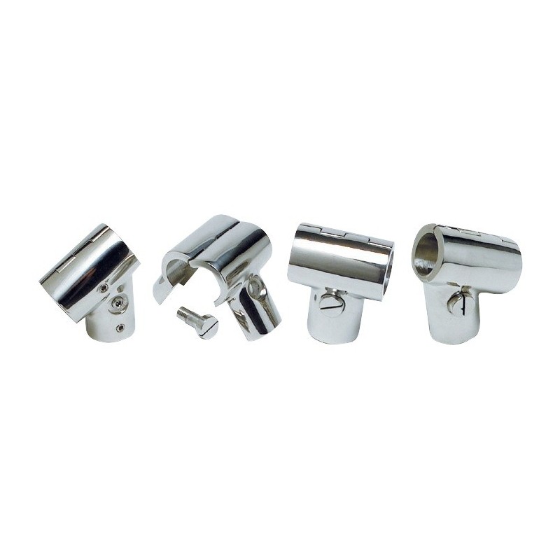

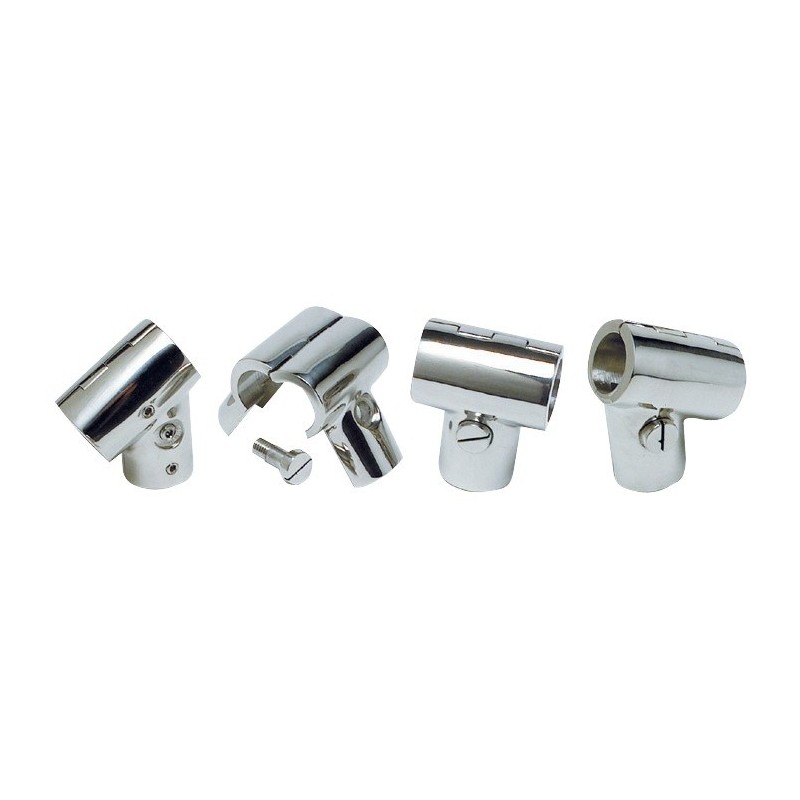

To keep my pulpit rail aesthetically clean looking, I would likely go with a matching set of these: Top Caps Extra
Two of the right size to match your tubing on each end, one side as a hinge, the other as a latch of sorts using a SS pin/clevis.

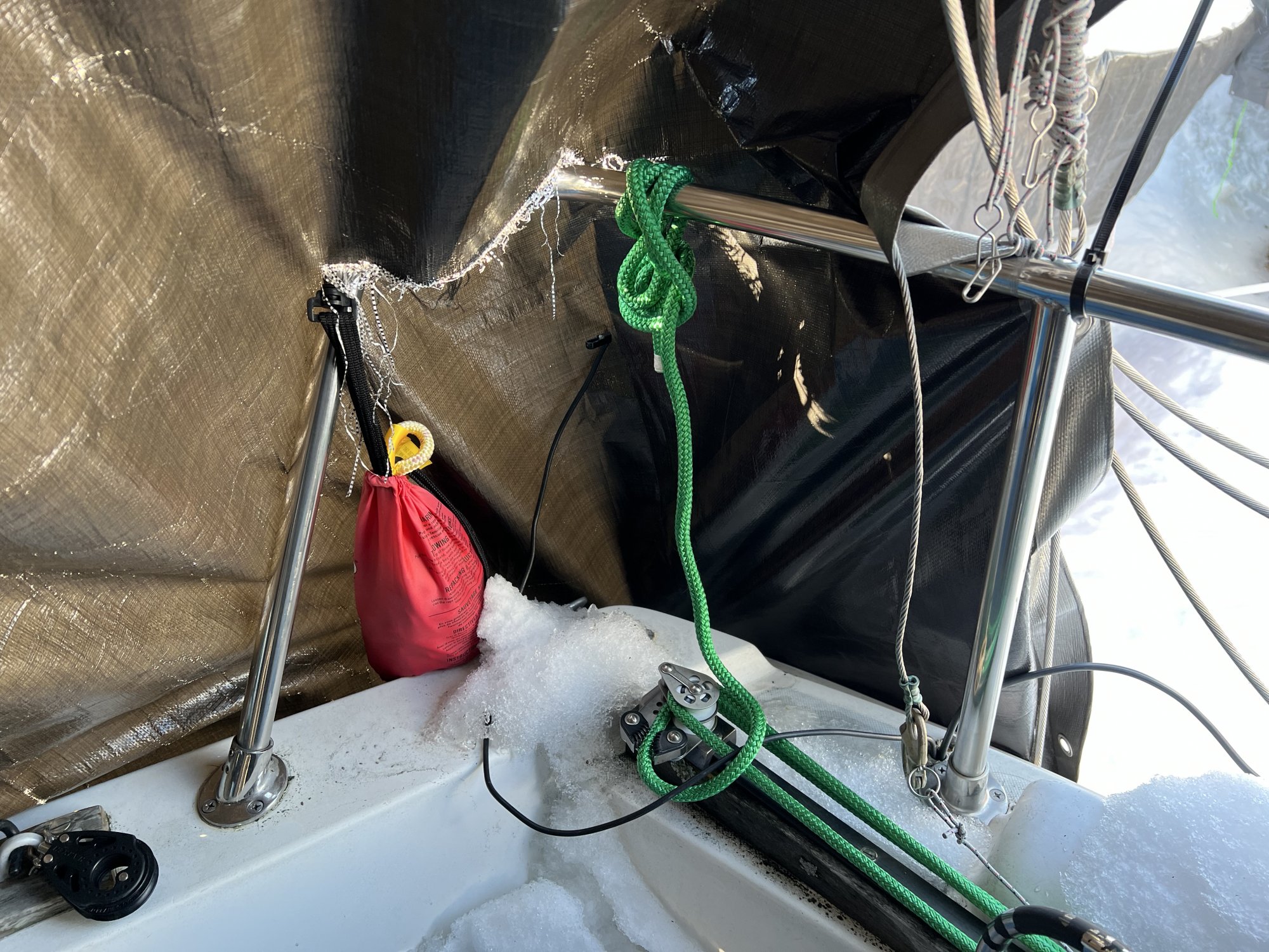

Sorry about that, there was no angle brace... I sold the boat fifteen years ago. There is only the intermediate tubing.
You can see the line to pull the swim ladder down from the water just beside the flagstaff.

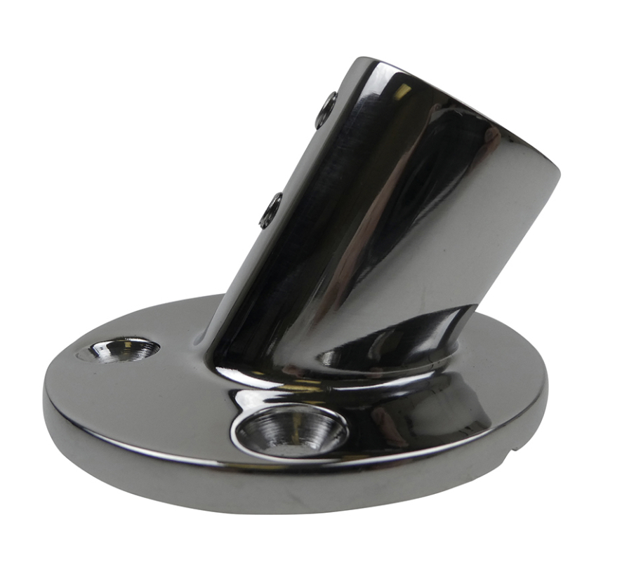

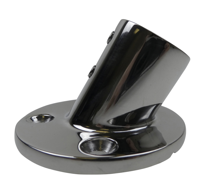

23,951
I would attach a piece of straight SS pipe to the vertical stanchion with something like this
rotate it so it aligns with the pulpit horizontal toward the side of your boat, and fit this on the end of a piece of ss pipe as the base.
Through bolt the base to the deck. It will brace against the vertical stern pulpit from being bent by someone grabbing the side life lines.

I understood you were cutting the center piece out between the two stanchions.
This would open the pulpit for your ladder access. You would use a dyneema gate when not accessing through the gap. With the center bar missing the stanchions would be vulnerable to being pulled towards the side of the boat if a crewman fell against the lifeline. The brace would attach to the vertical stanchion facing out towards the side. It would brace the stanchion from being bent by crew.
