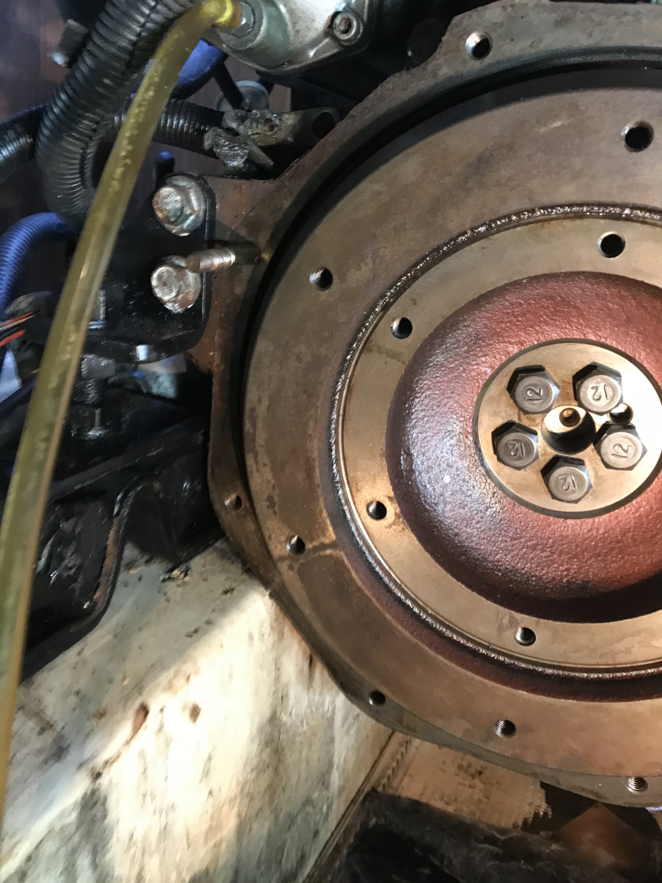

Yes boat in water and I have dripless so was careful and needed to move engine forward as forward as will go until it hits the bottom pan and did want to slide back so tied rope to mast support pole to keep motor from sliding back.
Needed to remove a lot of stuff exhaust and tranny and fuel cables and fuel lines.
remove bottom lag bolts in motor mounts and raw water pump hoses and water heater hoses.
Than remove bolts holding bell housing and tranny will slide back and out and tan clutch plate and fly wheel and removed
seal with proper small screw driver and put new seal in and tapped in with PVC pipe same size as seal from hardware store.
fly wheel very heavy and had to remove wood panels and leaned over engine from front engine to put flywheel back in and everything back together.
I realigned the engine with feeler gauge in between the 2 couples and fan engine but did not test drive it and see if any bad vibrations.
