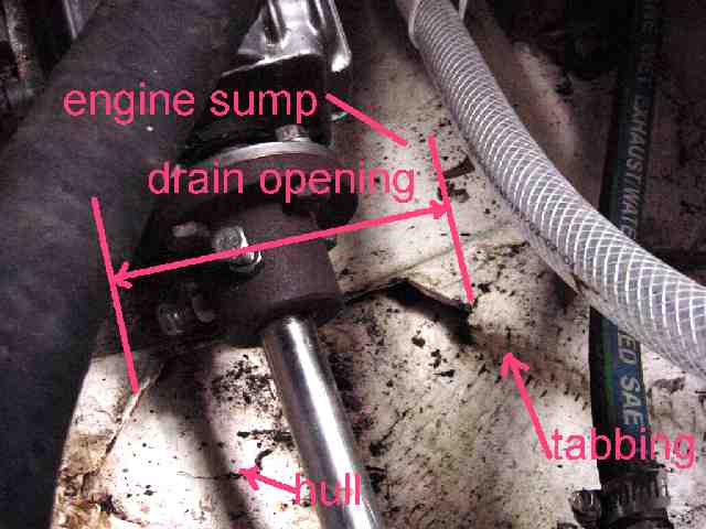

More on H33 aft drainage
Greg and Bill: Too rainy for me to paint non skid this afternoon so I took a couple of photos of the area. The drainage slot between the engine sump-pan and the hull is very small, probably not over 1/4"-3/8" high and perhaps 4"-5" wide so wouldn't be any trouble to get plugged with crud in which case you would have an aft bilge with water standing under stuffing box and into the engine sump. It's supposed to run under the sump in the space shown. make a hook in a coat hanger and rake the crud out of there, It'll drain right right to the real bilge.

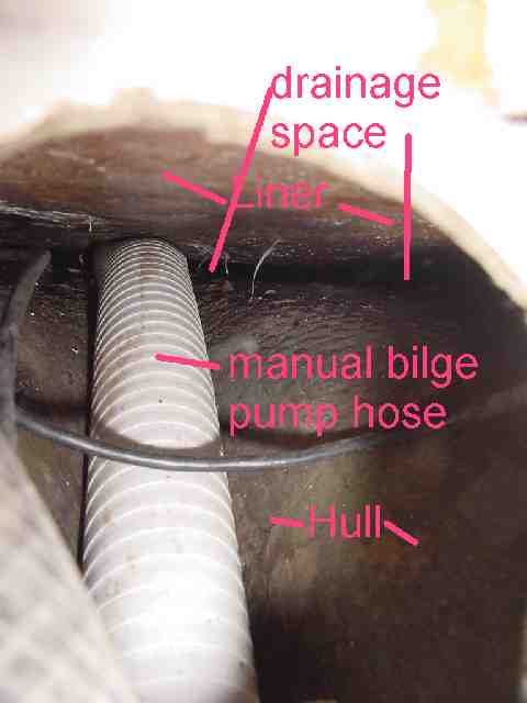

H33 drainage view
Photo here is from aft end of bilge looking aft. I believe that you can see the space between hull and lower liner. I have a manual bilge hose 1 1/4" which exits up through the liner underneath the ladder when the space between hull and liner gets smaller than the hose diameter. The space is continuous though and you should be able to feed a wire from the bilge all the way up and out the drainage slot aft of the engine.
