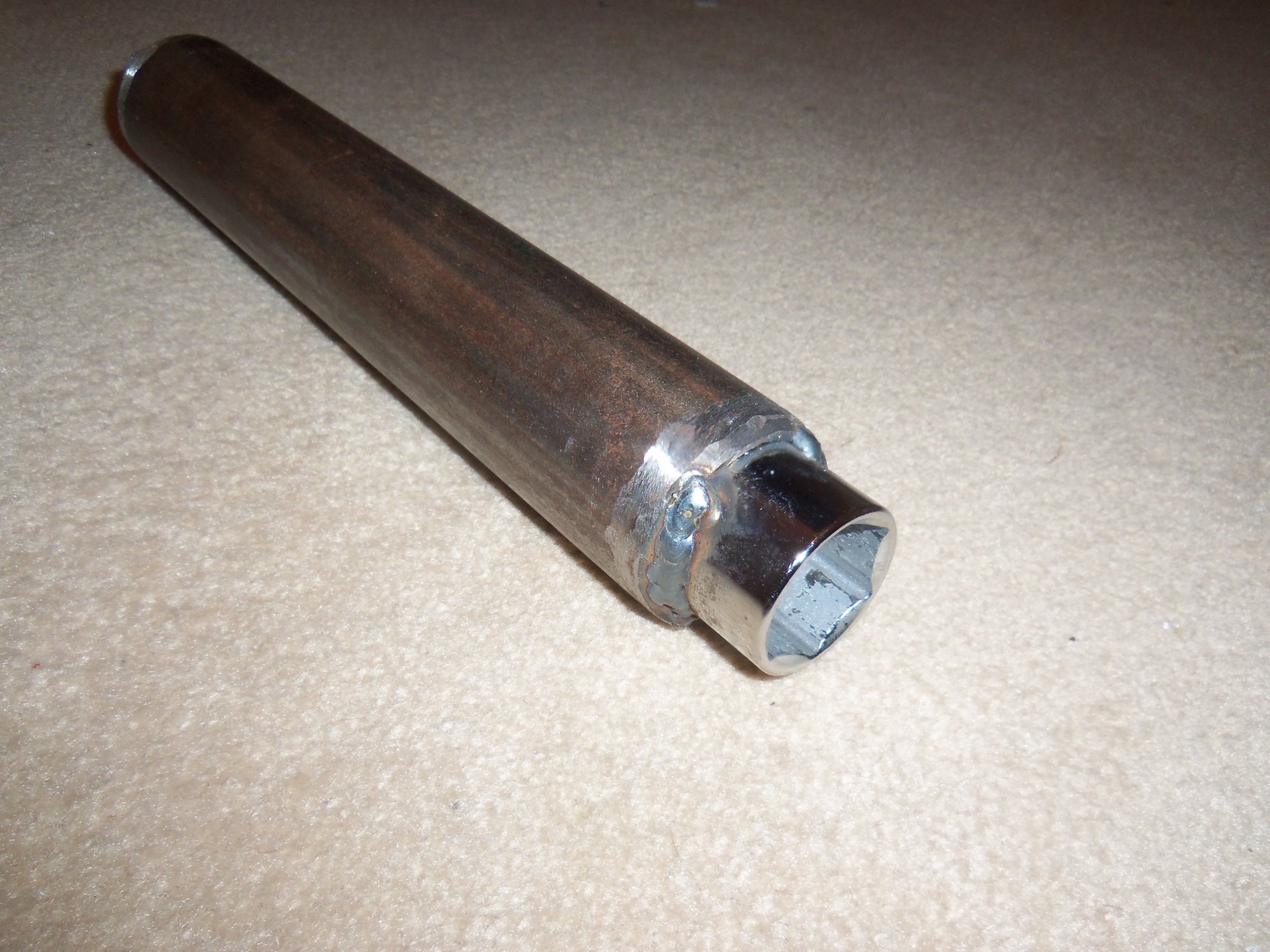

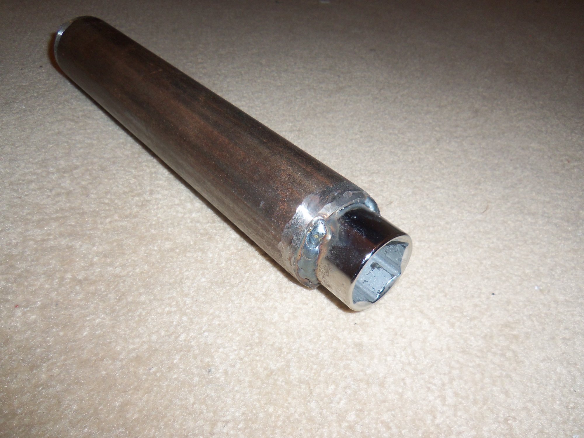

I was forced into having a 20 year survey in 2019 by my insurance company. I contacted one of their recommended surveyors and wound up with a very experienced and well certified individual. One of the things he required was checking the torque of all of the keel bolts. I could be responsible for supplying the torque wrench and heads or he could supply a subcontractor who would do it for time and materials ($$$$) but it was required. He only wanted to see a torque of at least the torques shown on his sheet to order to pass. His sheet was within a few LB-FT of the numbers supplied by by Hunter. If I over-torqued it, that was my problem. An interesting learning experience so I supplied the wrench and welded up the required heads:
Other surveyors will have different approaches.
