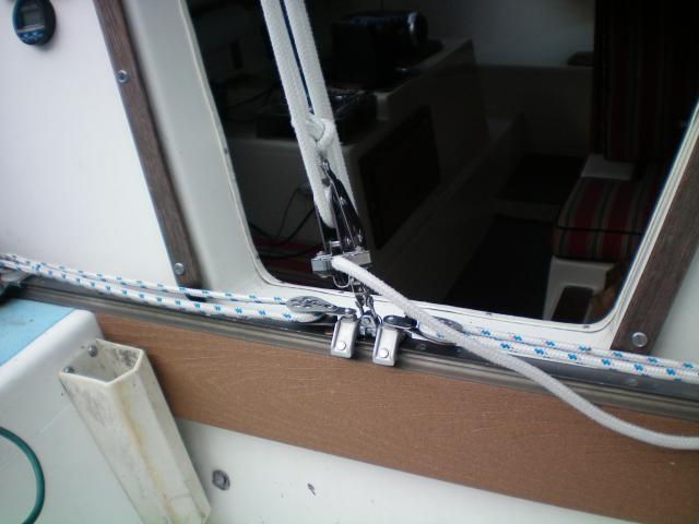

Has anyone replaeced the wood trim on thier boat with TREX? I ned to replace the teak the holds the companion way dor and the poptop in place and I thought of the TREX, I love wood but would rather sail than work on the boat and I thought this might save me some time. I appreciate any input

Is trex the faux wood used to make decks etc.? If so then I made hatch slides out of trex. Too early to tell if it is a good idea but it looks okay to me.

The trim you have looks FABULOUS. Where did you get the "fake wood" Do you remember the name? Thanks for the pics and the info. As I said ,I am looking to save on work so I can sail more =).

The ladder is oak because The bottom step is only supported at the ends.
Handles and rails have no grain and is just fake redwood decking from Home Depot, sanded with 400 and stained with mahagony (red?) using the wipe on, wipe off style.
I like the fake wood because it is full size and easy to work with
The facia on the slider is oak.
Hint-- To get stain off your hands use baby oil and then just dish soap.

I bought this composite decking from HD. Not quite the color I was hoping for, it doesn't match the teak at the companionway(closer match to teak on deck......go figure) The teak I had under the traveler rotted at the screw holes, and this is under some stress when underway.
I'm re-sawing some 5/4 to place under my pulpit bases(bow to aft of pulpit toe rail). It does machine well.
