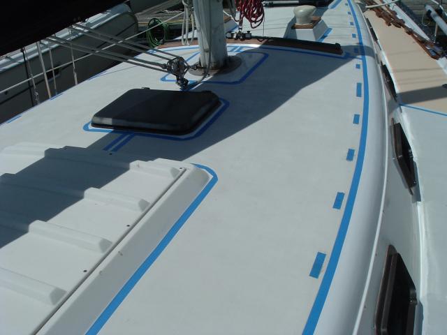

You will want to sand first and then paint the "gelcoat" areas second. A good sanding of the entire deck/cabin surfaces followed by a very good wipedown just before applying the paint is all that I did. I started with 60 grit in the orbital followed by 200. Then I finished with 600(by hand) leaving no scratches. I did the "white" using Interlux Off-White. Two-part is best but I was working alone and it sets up too fast, you need someone to follow with a good brush to "tip" after the roller. But my one-part Interlux Toplac looks good after six years. Then mask off and do the non-skid. You will find a favorite product here in the SBO store. But I used an Interlux product that is pre-mixed called Interdeck. Here are a couple of pictures.
P.S. Notice a white 2" stripe from the mast to the companionway. That stripe also extends forward to the anchor locker. This allowed me to paint the non-skid on one-half of the boat at a time. Made it much easier to keep a wet edge working from front to back.
