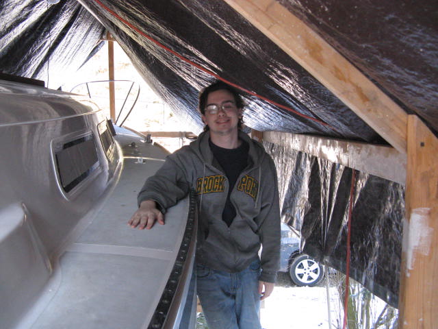

Gelcoat unwaxed and 50% Duratec High Gloss Additive and 5% Duratech thinner, 2% MEKP-9 and a Kobalt HVLP gun from Lowes. Wet sand and buff with Aqua Buff and viola. No magic or special recipes or other garbage, just science.

Forgot about the Duratec. I have a friend who's used it, not for boats though, and raves about it. I've only sprayed waxed gell but will give that a try next time... How was the intial "peel"?

Hi Mainesail. The peel wasn't as bad as I was expecting. I am a rank amatuer and obtained good results with a cheap gun. I suspect a pro with a good gun can save a lot of sanding though. Your sanding and buffing tutorial was an essential part of this, and I followed it to the letter with the exception of the Aqua Buff.
