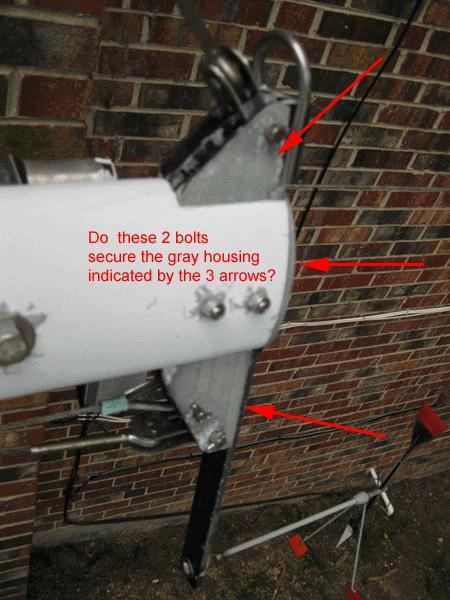

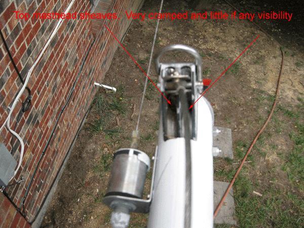

Thank you very much for this picture. It ties in excellently with some serious concerns of mind so I had to wait until I got some pictures before responding.
If the 2 photographs uploaded properly, in the first - Top masthead sheaves1 - you can easily see there's very little room to see down there, let alone being able to reach in to pull anything out. In the second photograph - Two bolts1 - I'm considering if those 2 bolts on the side of the mast hold in the gray section that's over the sheaves and if so, perhaps if removed I'd have access to the inside of the mast as shown by your pictures. What's your take? Don't want to make more of an unnecessary than I've already done.

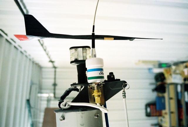

Of course my mast cap looks somewhat different but it does look to me as if once the two bolts are removed the cap will slide out.
Of course in the future you'll do this differently - leave a messenger line in the mast so it makes it easy to restore the line.

Thanks for this latest picture but yeah most definitely ("... it does look...as if once the two bolts are removed the cap will slide out").
