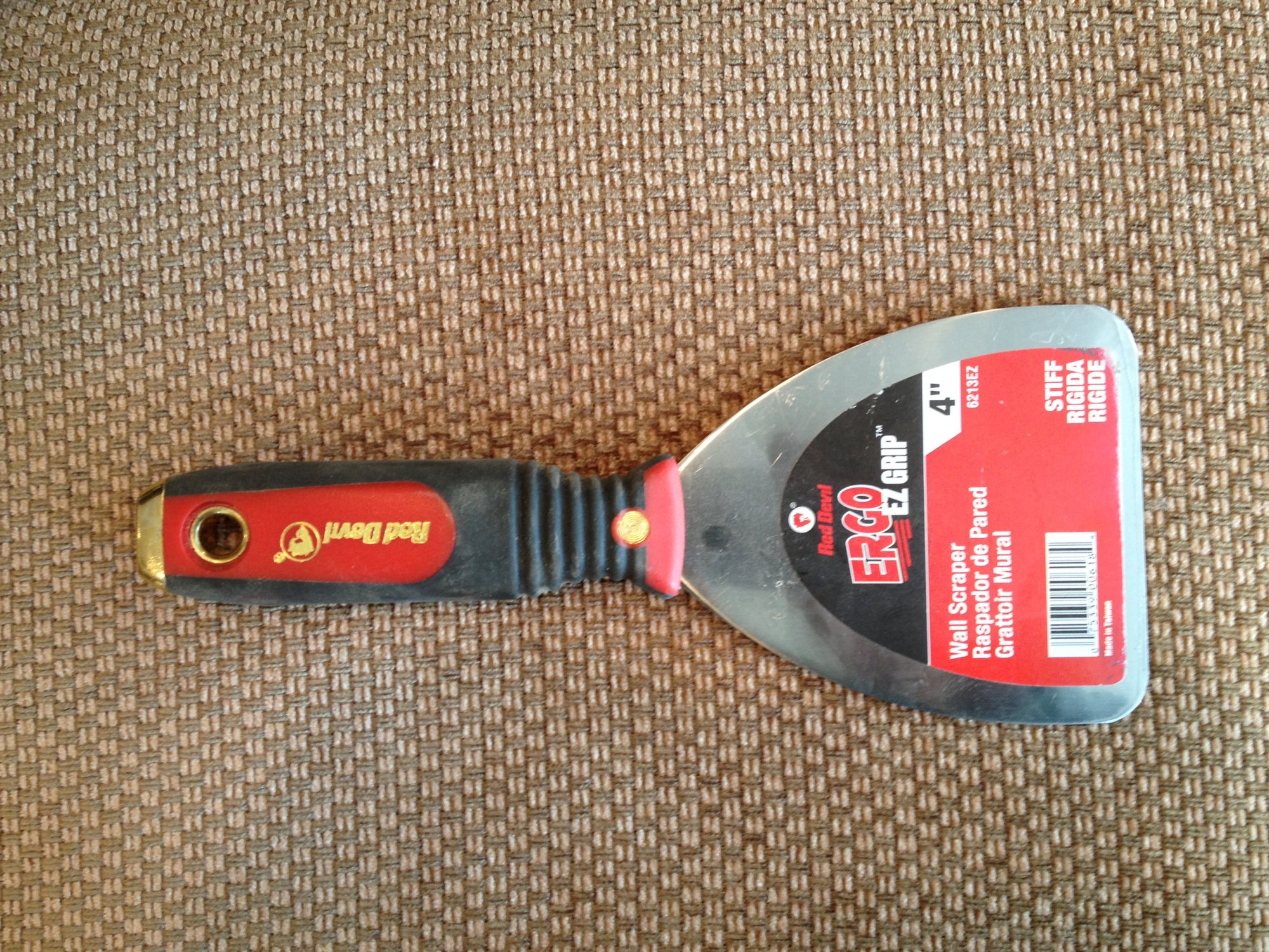

Art, I agree the liner is daunting both to remove and replace. I have used your removal technic with success. However, for replacement I use a "dulled" putty scraper with the edges rounded. One large for long runs and a smaller one for tighter areas. Picture attached. However your grease idea has some concerns to me. It seems to me that the grease could eventually "bleed" thru the fabric and stain it. Your thoughts on that! What kind of grease are you using?
The grease is actually a Teflon based and it’s from Starbrite. It is totally inert.
I keep 3 small Jars on board for everything.
Sail track guides, hatches, putting hoses on fittings. Really an excellent all around product.
It doesn’t stain the headliner
The putty knife is a perfect tool, but the friction of trying to get the material back in the track can lead to ripping, etc. The Teflon makes it just pop back in with zero resistance.
Just run a thin bead. It’s all you need.
If you think about it, putting the material into the track means :
Bending it 180 degrees back on itself
Sliding 2 coarse material edges against a fairly high friction track
And stretching the material.The lubricity of the ptfe takes most of the friction out.
Also, really important when you re-insert.
After every material “tuck”, slightly pull on the fabric in the direction you are installing it in.
This gives it an even stretch, and ensures you will have enough material when you end up at the corner.
Without the ptfe, stretching is almost impossible, and risks tearing the fabric.

What I use is actually ptfe grease.
I would not use a spray for this.
The trick is to lay it into the bevel of the track. That way the fabric carries it down into the groove. Just lay it on with a qtip. Not too light. Use enough so that you can see it on the surface.
Guarantee you won’t believe how easy this job becomes
I do like using a dead blow hammer behind the tool, as it really pops the material right it. I feel it’s less stressful to the fabric, as the fabric itself isn’t being used so much to open the groove. A light tap does the trick. Don’t use a heavy hand
