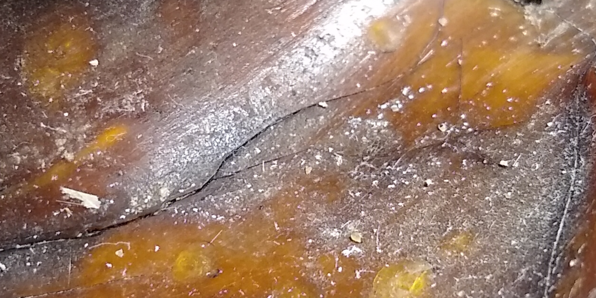

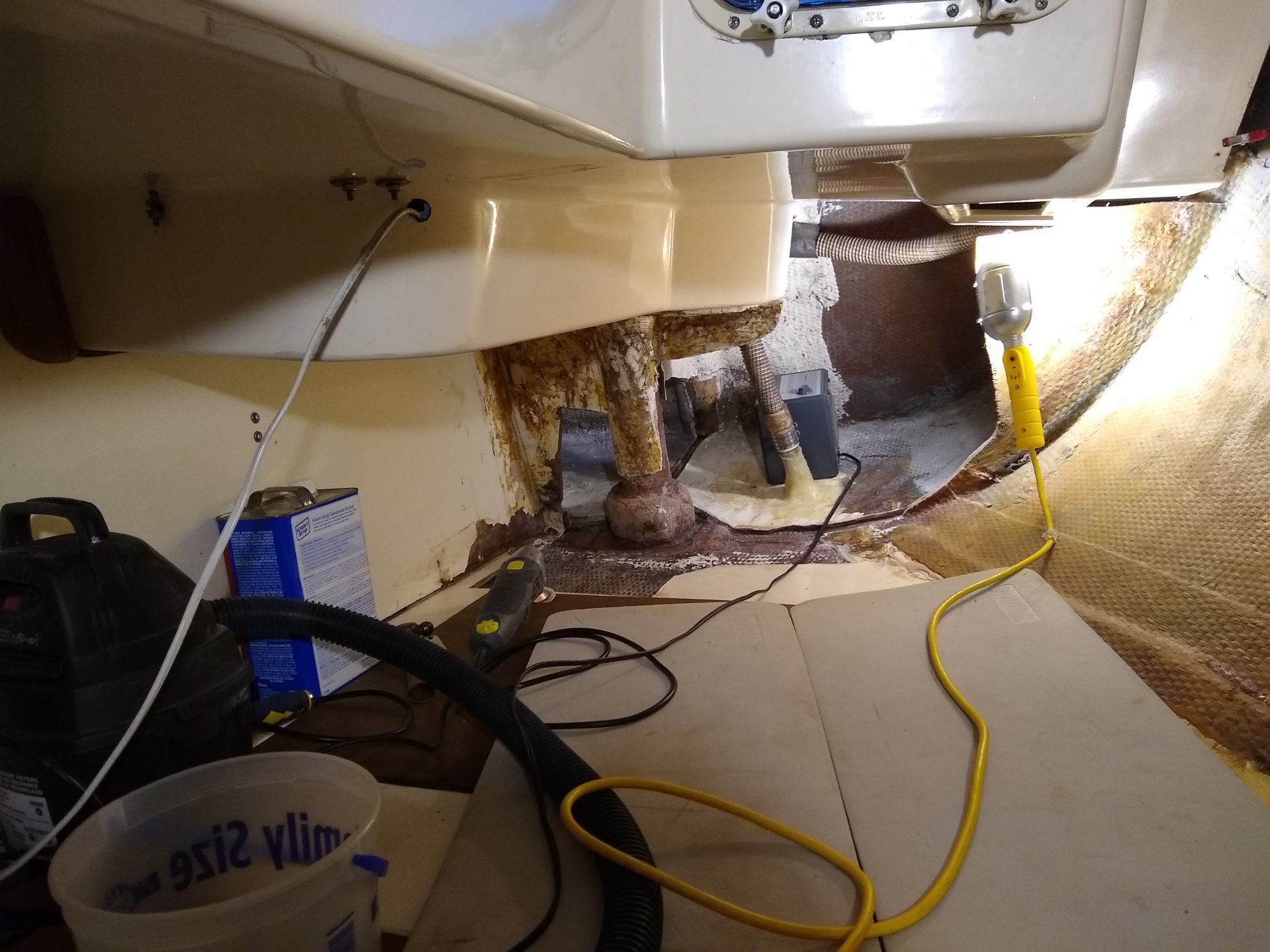

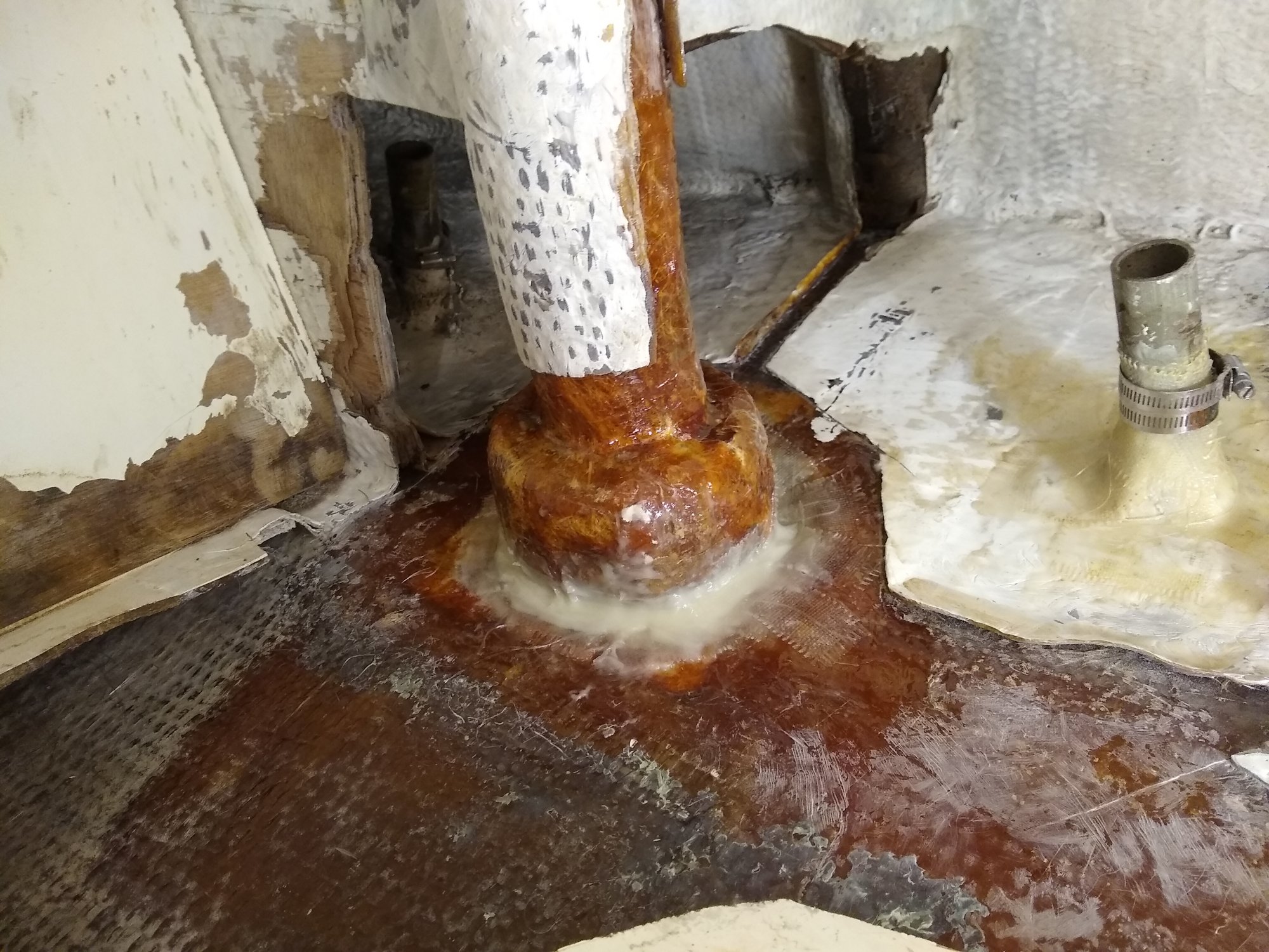

Found spider cracks at base of the rudder post bushing where I believe water was coming in while underway (when bushing goes below waterline).
Currently on the hard, but I'd like to launch and confirm my re-glassing fixed the leak before reinstalling the bulkheads. Any idea if this would be a problem?
