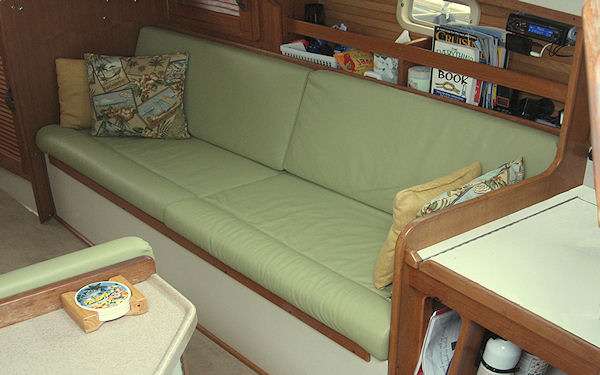

Picking the right foam makes a huge difference. We used firm in the salon and medium in the berths. Go too soft in the salon and you'll bottom out after a while when you curl up with a book. Too firm in the v-berth and your back will not be happy.
For fabric we used UltraLeather Brisa in the salon and a soft fabric recommended by the upholsterer for the berths. We wanted something in the salon that could handle a wet bathing suit, suntan lotion and minor spills without staining. After six years of use most weekends it still looks new. For sleeping we wanted comfort so soft fabric was important. BTW if you're sleeping aboard often the Froli Sleep System is some of the best boat bucks I ever spent.

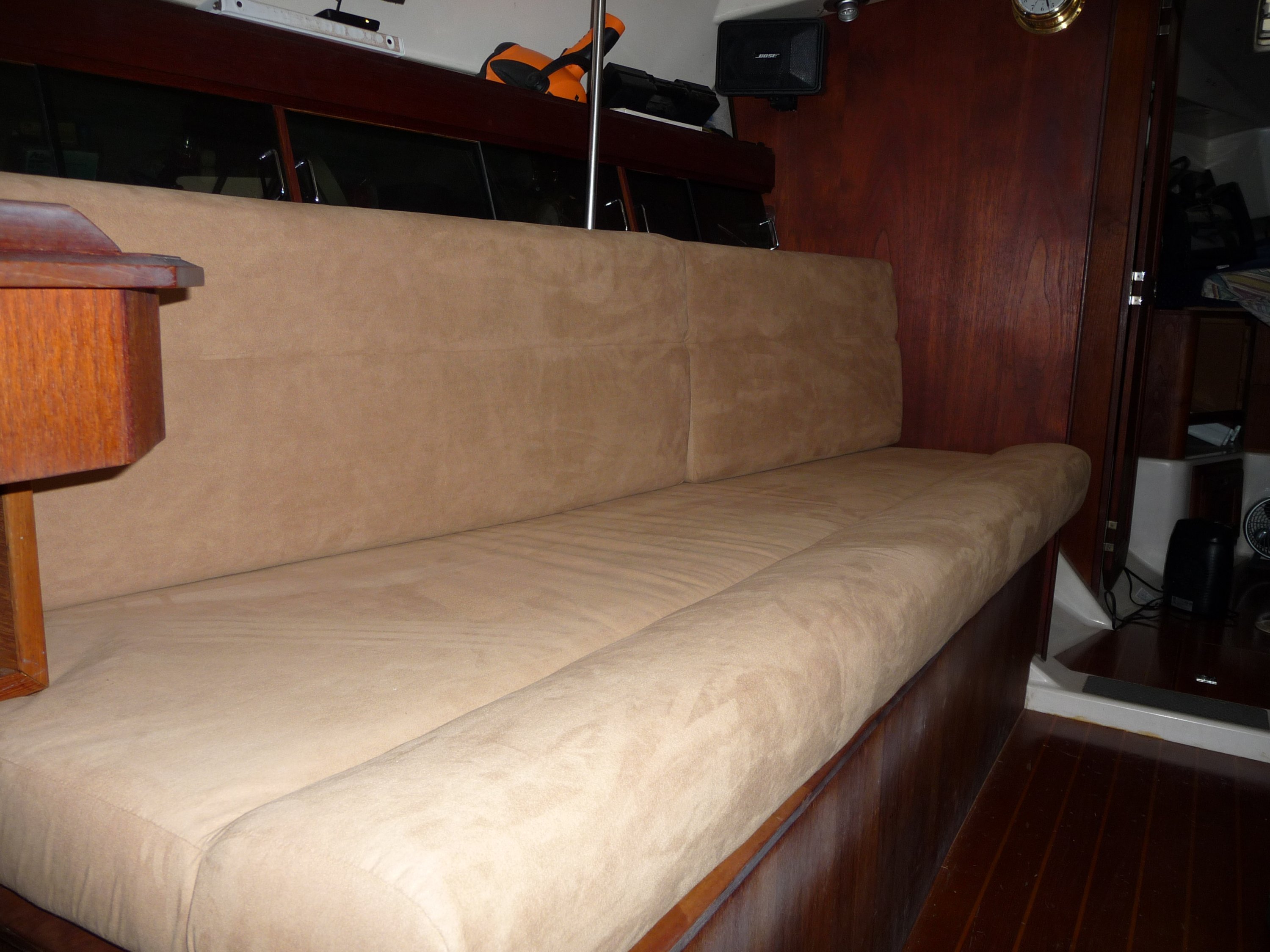

10,043
Used Ultrasuede for our new salon cushions. tough material that is non-staining .. P1040404.JPG
