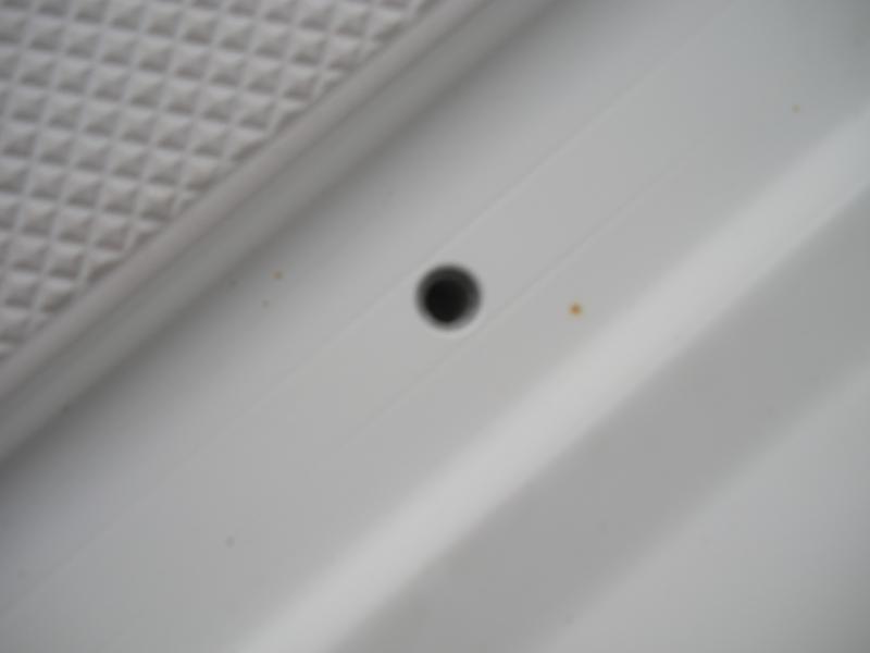

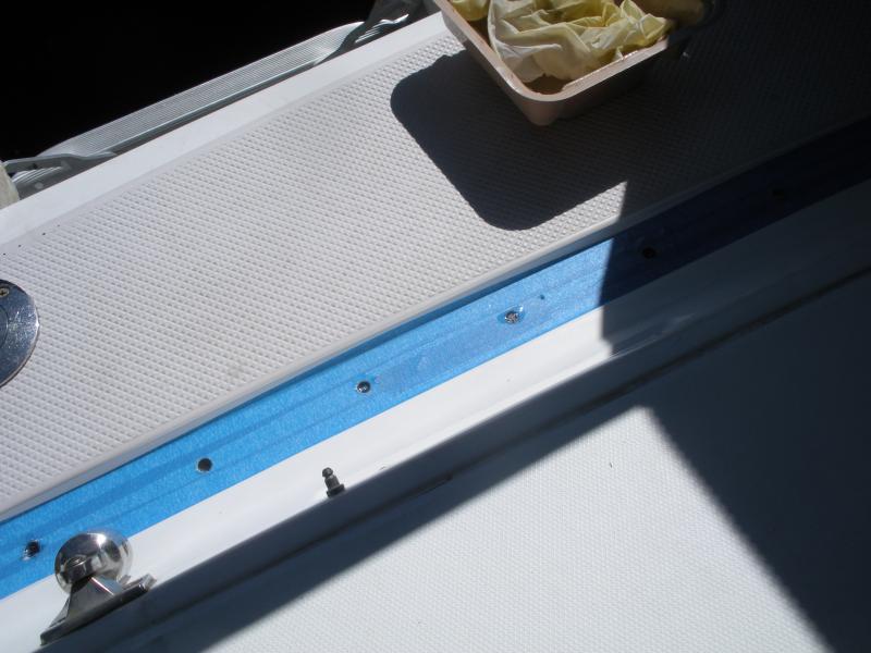

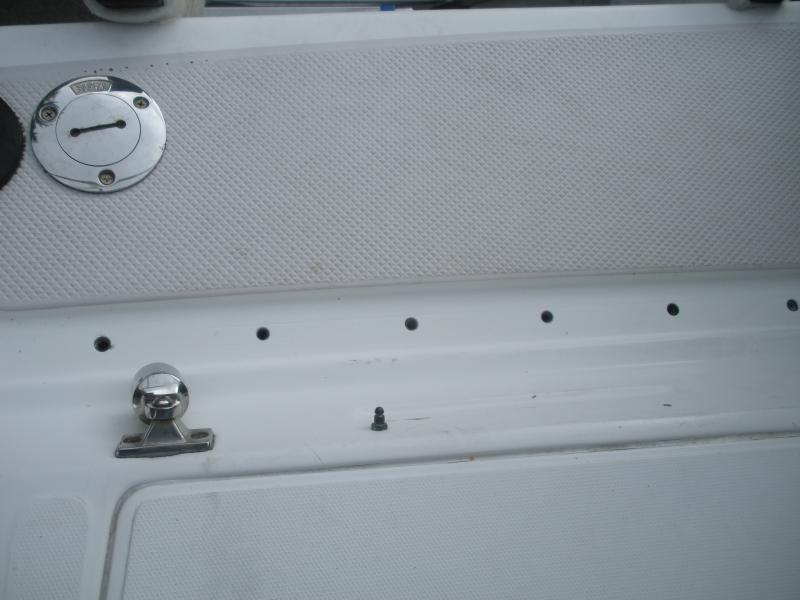

If you want to use butyl this is at least a two person job and requires top and bottom cones plus strips of butyl between bolts. There are no short cuts with genny tracks/butyl and it does get dropped in as one unit.
*Bevel / countersink the deck holes slightly.
*Wrap the bolt heads then press each one into the cleaned track.
*Next wrap each bolt under the track and knead the butyl cone into the bolt threads.
*Now place butyl on the underside of the track between butyl cones on each bolt
*Drop the track, with bolts, into place and so the bolts are in each hole (cleaned
& prepped of course). This may require a third person if the track has lost pre-bend..
*Place a 3' long board over the track and walk back and forth, then move it up
the track and repeat. This compresses the butyl and also keeps the bolts from
popping up.
*Get a partner to hold the screws with a screw driver and you go below and
slowly tighten the nuts. (multiple events)
*Don't over tighten and do allow the butyl to "oooze out" it may take four or
five small tightening events . Be patient...
BTW I did send you or someone this same info via email. Perhaps wound up in spam?

I did this last season when I added Garhauer adjustable tracks. My Catalina's track is recessed. I had the track re-anodized. I did not add the strips of butyl between the screws but did wrap it around the top and bottom of the screws. I was able to put the track back in place carefully myself. It did loose it's bend. Definatly a 2 person job tightening. The hardest part was cleaning the excess butyl from under the track. Had to do a good job in order for the adjustable track to slide easily. Has not leaked in the first season. I believe it should be dry for a long time.
