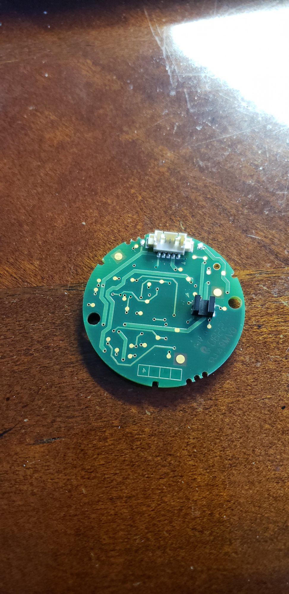

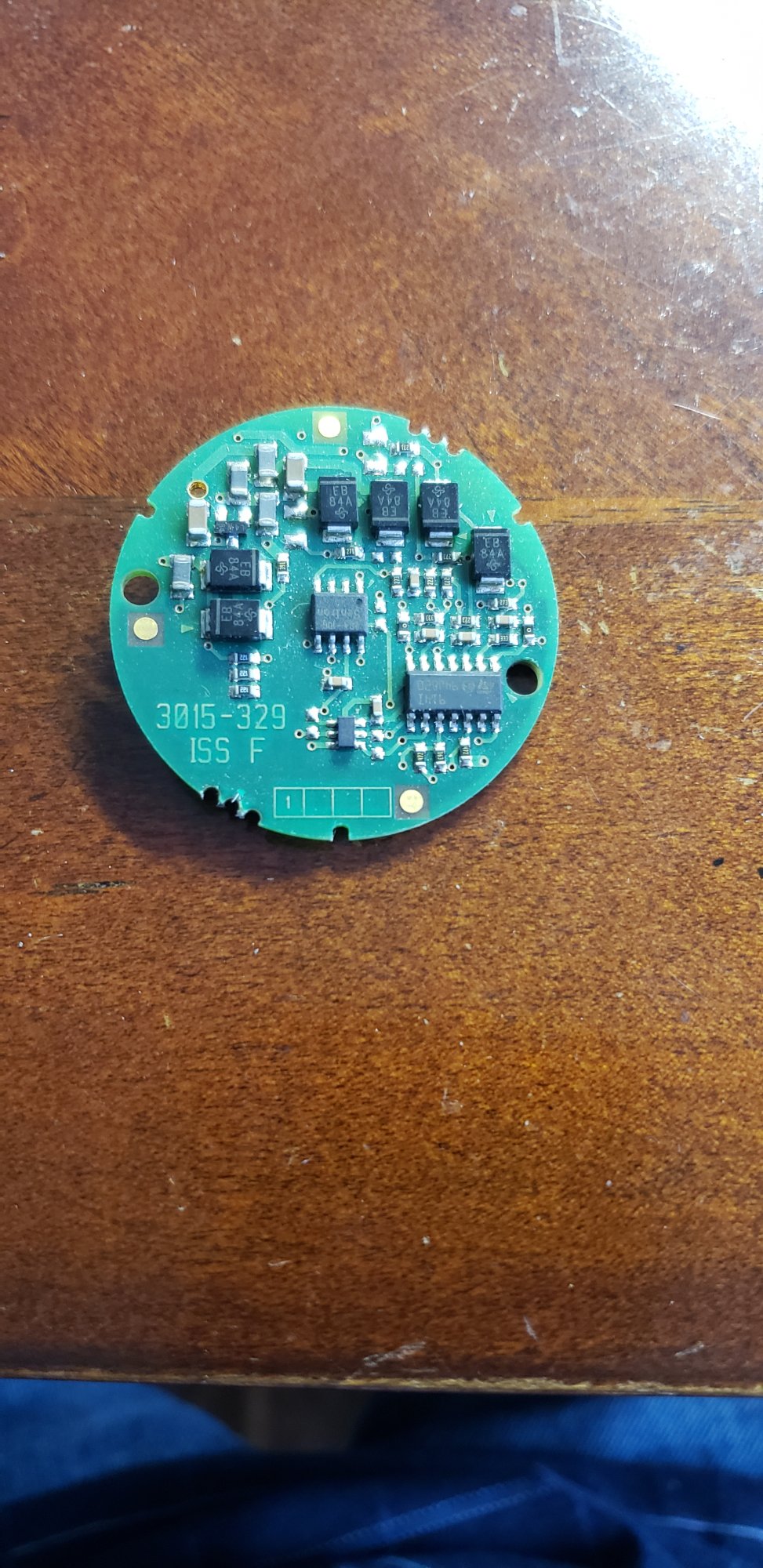

I finally managed to do some testing using a voltmeter. All readings but one, seem to be within the correct range. I spoke with Raymarine and after doing a quick Factory reset of the display unit, the said the issue seem to be with the wind vane unit. I ordered a new wind vane, so as soon as it arrives I will climb the mast to change it. Hopefully that will take care of the issue. @RitSim thanks for the info on the PCB. That would probably be my next step if changing the wind vane doesn't fix the problem. Good to know the PCB is available.
