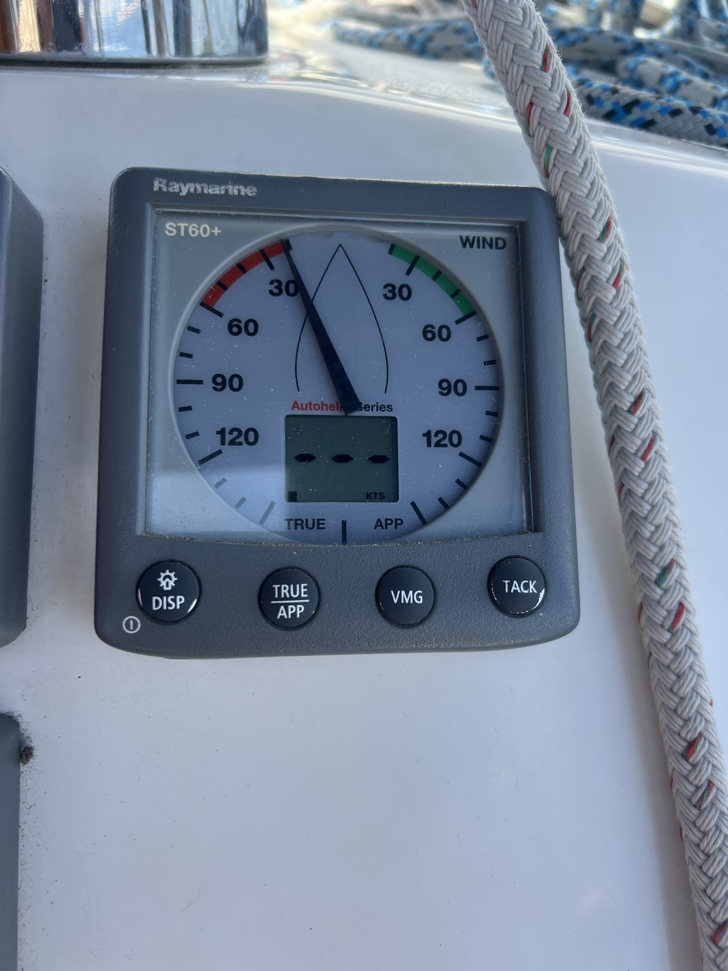

The display mostly shows the correct information, but will occasionally lose all info and just show dashes instead of wind speed, and no wind direction.
just the other day the indicator needle was pegging to port, and the dashes would occasionally show the correct windspeed. Power cycle it sometimes helps. Anybody know what the issue might be?
