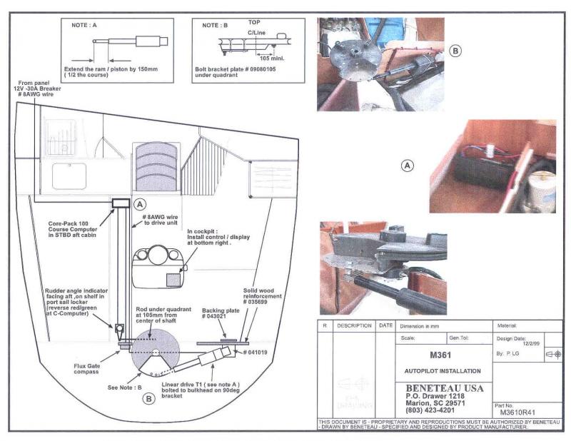

Hi, I have a Beneteau 361 with ST4000 wheel autopilot and I also find it inappropriate for my sailboat. I bought a Raymarine EV200 with a Type 1 electric linear drive which I am planning to install this spring following Beneteau's diagram attached. I have ordered Beneteau's part for this installation but I am not sure if I will go ahead with the install because I wanted to move to a Beneteau 423 since last year but the market was not very good and no one showed up. Last weekend I had 2 persons that visited my sailboat so I have put my project on hold. If I sell my 361 I will keep the Raymarine EV200 kit for the 423 and will sell the Beneteau installation kit. If I proceed with the install I will send you picture and tell you how it is performing.
