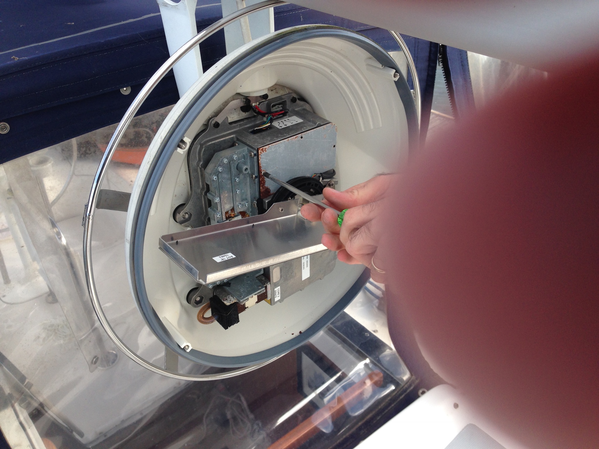

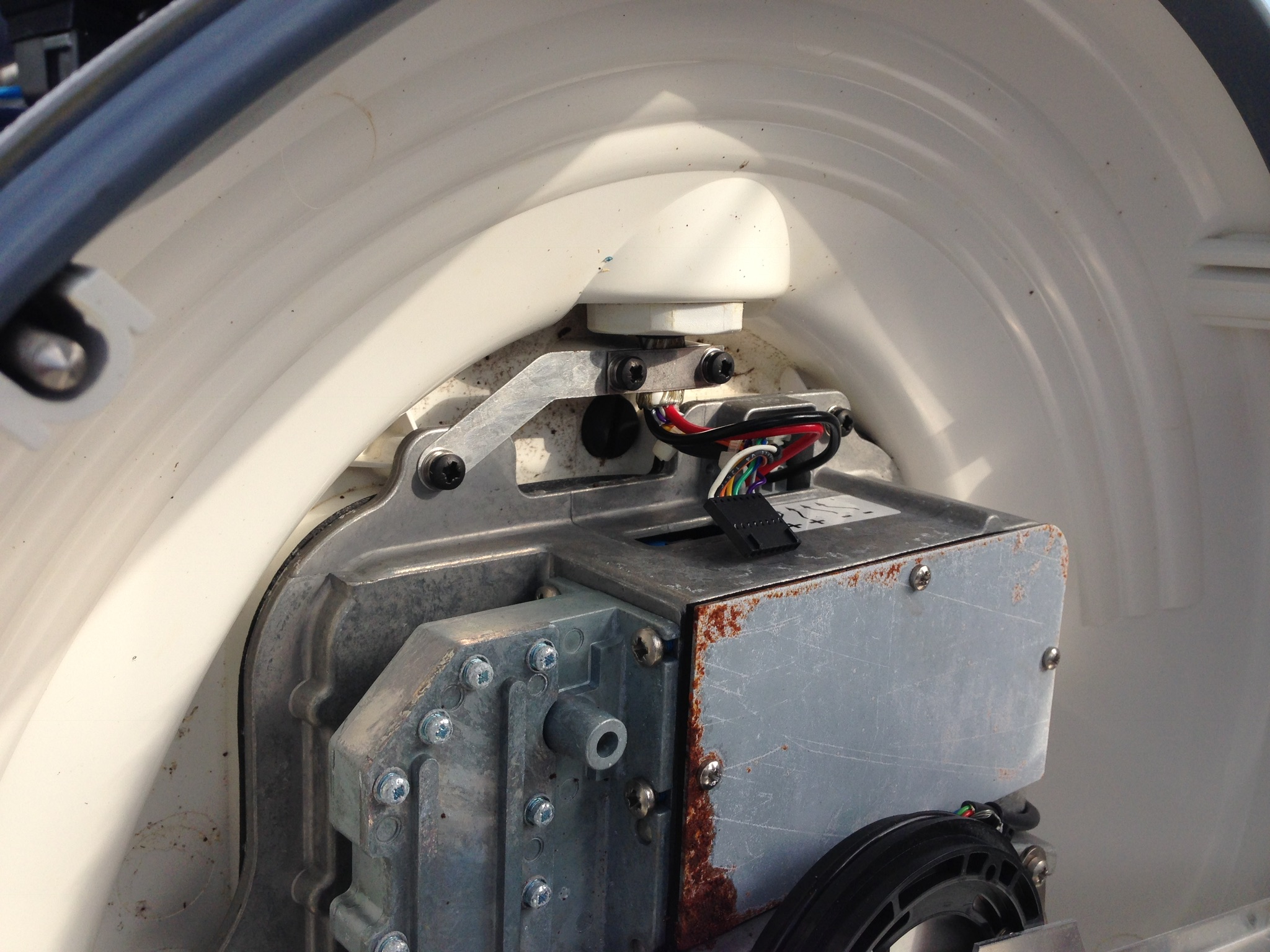

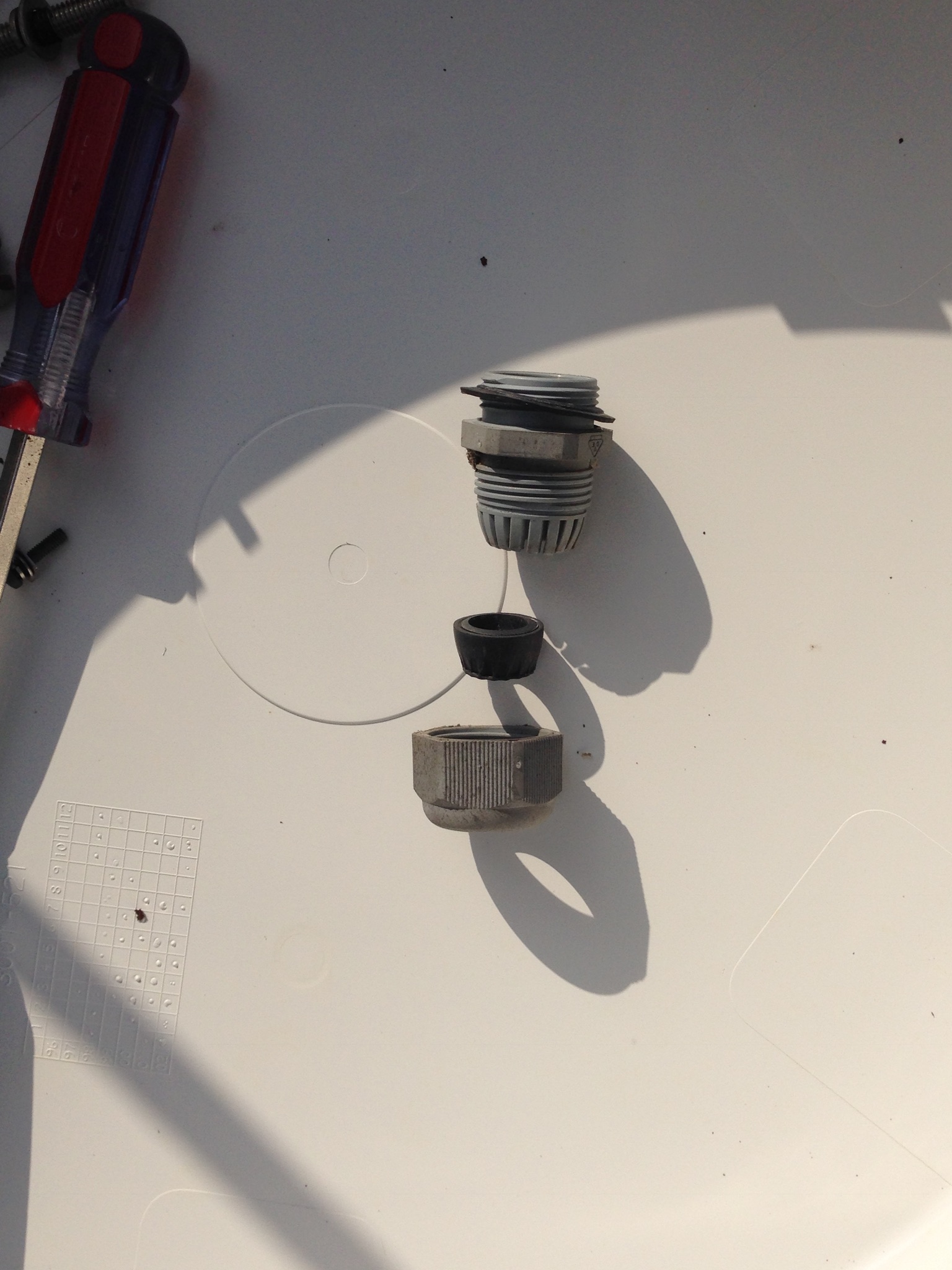

I have the Pathfinder Raymarine Radome and it is the predecessor to the 218. Both of these are analog units. There is a plug that the radar cable goes through and the actual connection on mine is a flat plug with multiple wires. To access the plug requires that the Radom be taken apart and the top half removed to access the plug. If yours is like mine, would be a tedious job up high. I took mine apart and remote mounted when my mast was on a cradle going up and down the Tenn-Tom waterway cruising from Ky Lake to Fl and return so I’d have radar on the river. There is also a cable clamp justbinside the radome. Not too difficult when the radar is on the deck. Here are some photos of mine.

I have the Pathfinder Raymarine Radome and it is the predecessor to the 218. Both of these are analog units. There is a plug that the radar cable goes through and the actual connection on mine is a flat plug with multiple wires. To access the plug requires that the Radom be taken apart and the top half removed to access the plug. If yours is like mine, would be a tedious job up high. I took mine apart and remote mounted when my mast was on a cradle going up and down the Tenn-Tom waterway cruising from Ky Lake to Fl and return so I’d have radar on the river. There is also a cable clamp justbinside the radome. Not too difficult when the radar is on the deck. Here are some photos of mine.View attachment 149347View attachment 149348View attachment 149349
I’m afraid you are probably right.
