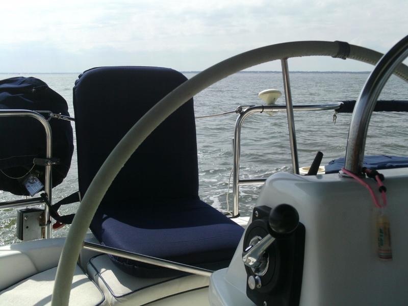

When I find the sun angle on me on a very hot day, I let Captain iPad (see his pict) run the helm while I sit in the shade in the cockpit and sip a beer.:D
