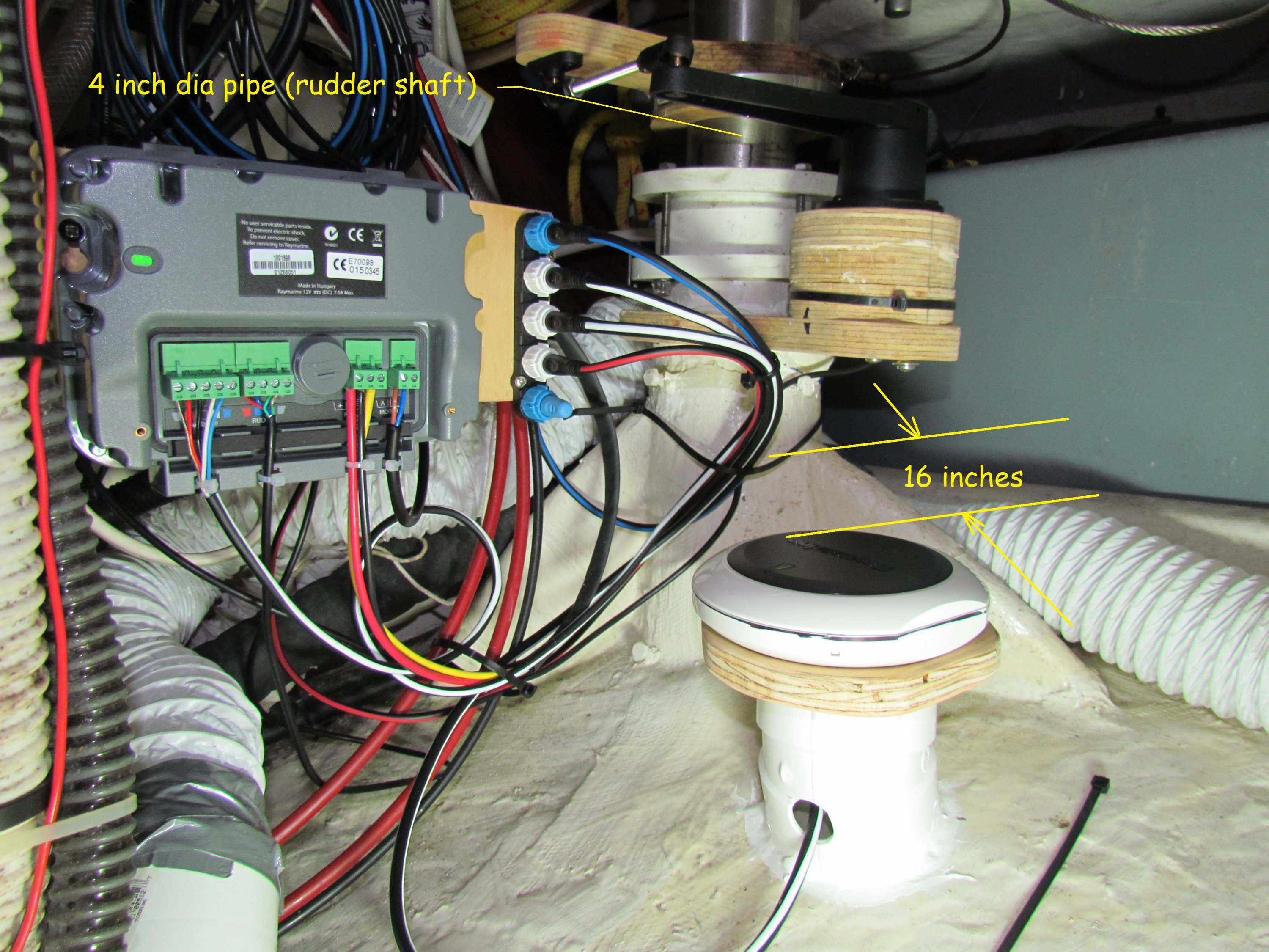

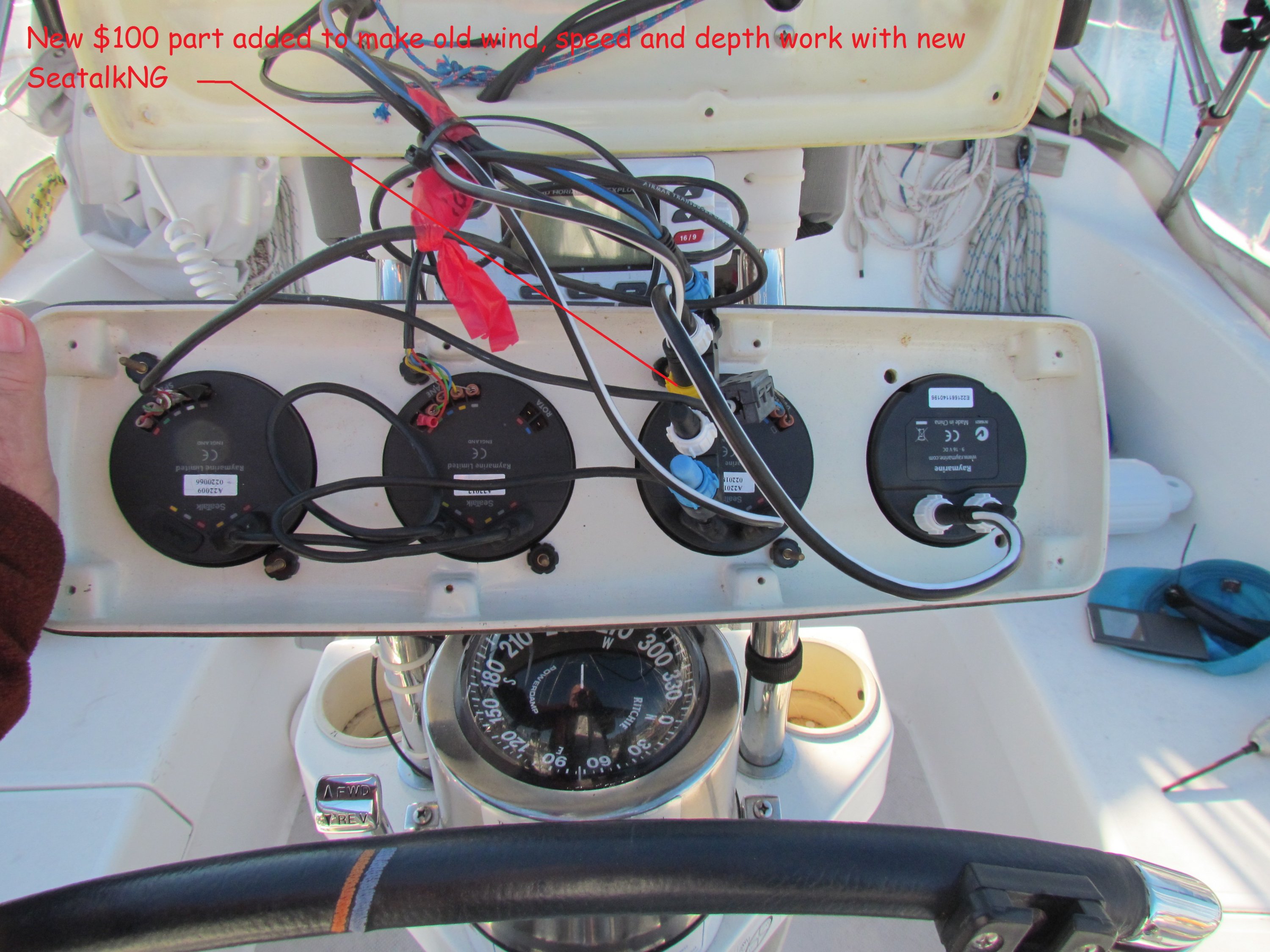

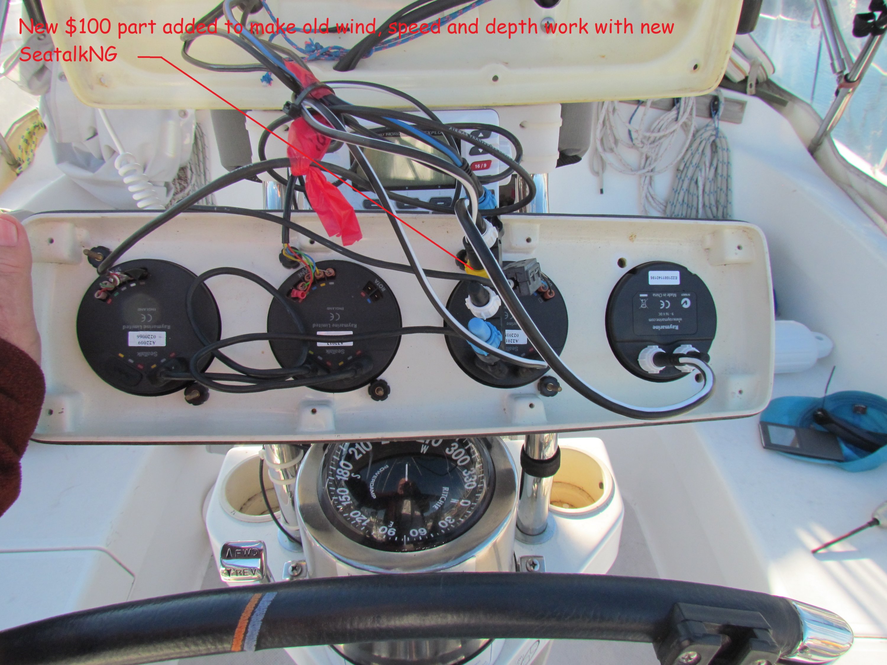

When I installed my unit last year, I had to buy a $100 part from Raymarine and at that time Raymarine suggested I have the firmware of the new EV checked for latest version.
Had to run new cable up to pedestal.
Since I had an existing rudder sensor, I hooked that up also.
I used double sided tape to install autopilot in pedestal housing......you will know what I mean when you get there.

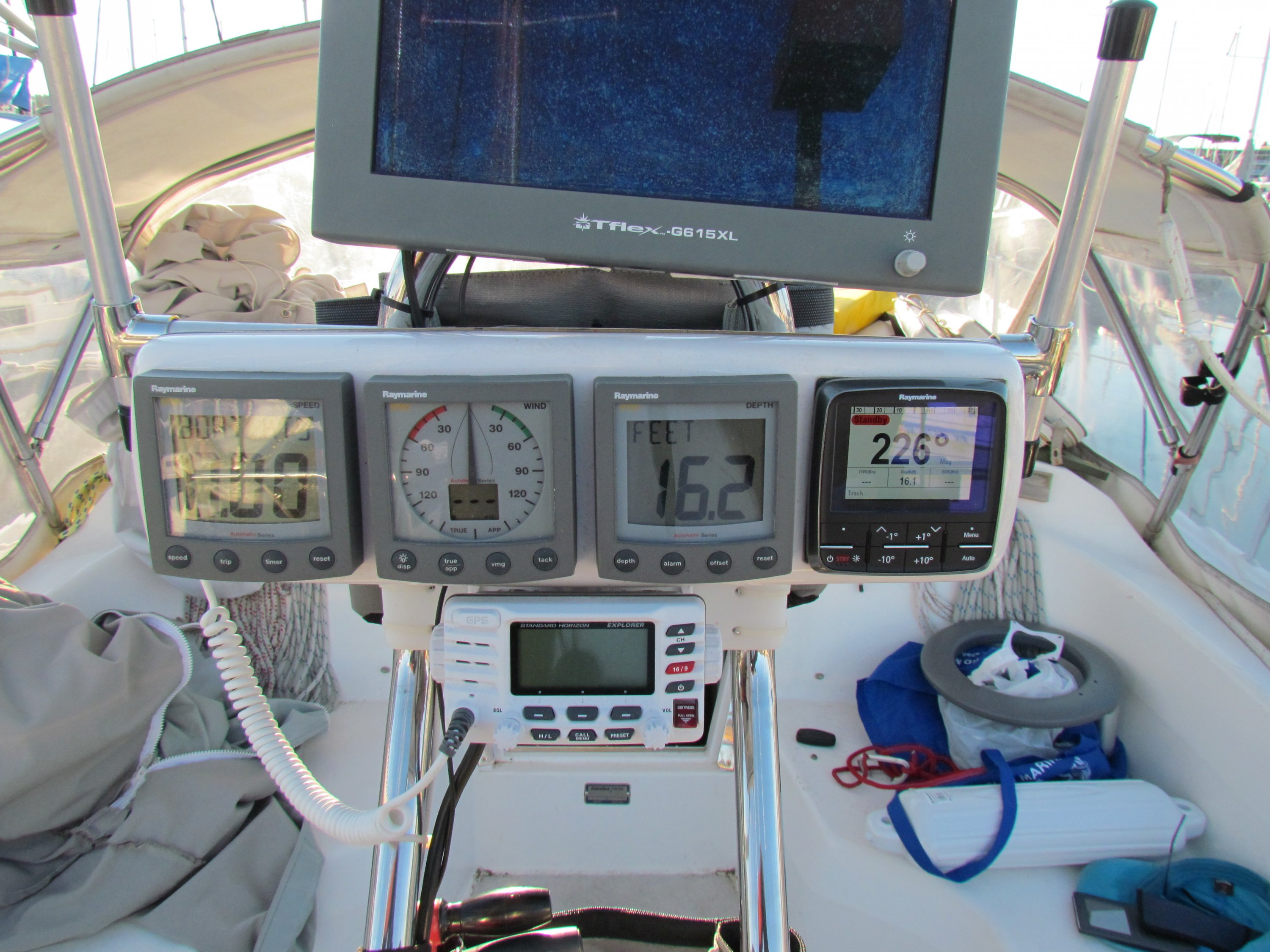

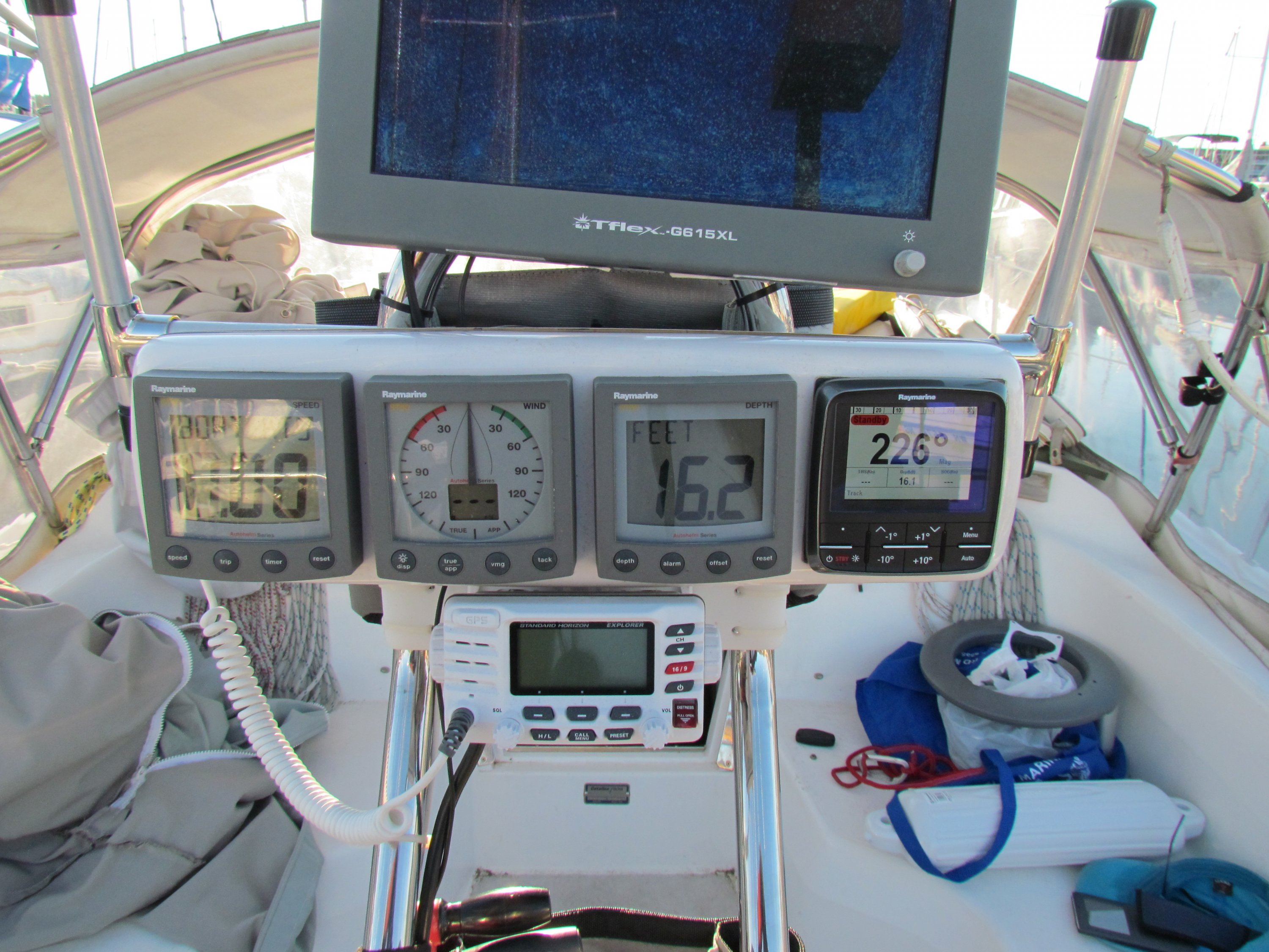

Good to hear. Are you controlling it from a p70, an MFD, or both? I've got an e7D, but am thinking that having the dedicated p70 display might also be nice. Besides, the p70 comes in the package.
Jul 14, 2015
840
Catalina 30 Stillhouse Hollow Marina
P70 is what i use and it works great.

I've already got that Seatalk to Seatalkng part-used it when I installed the e7D MFD so the old ST60s would talk to the it. Your wiring gives me some good ideas on how to connect all of this together. Thanks.
The back of your boat looks so much cleaner than mine. I've got some work to do!!

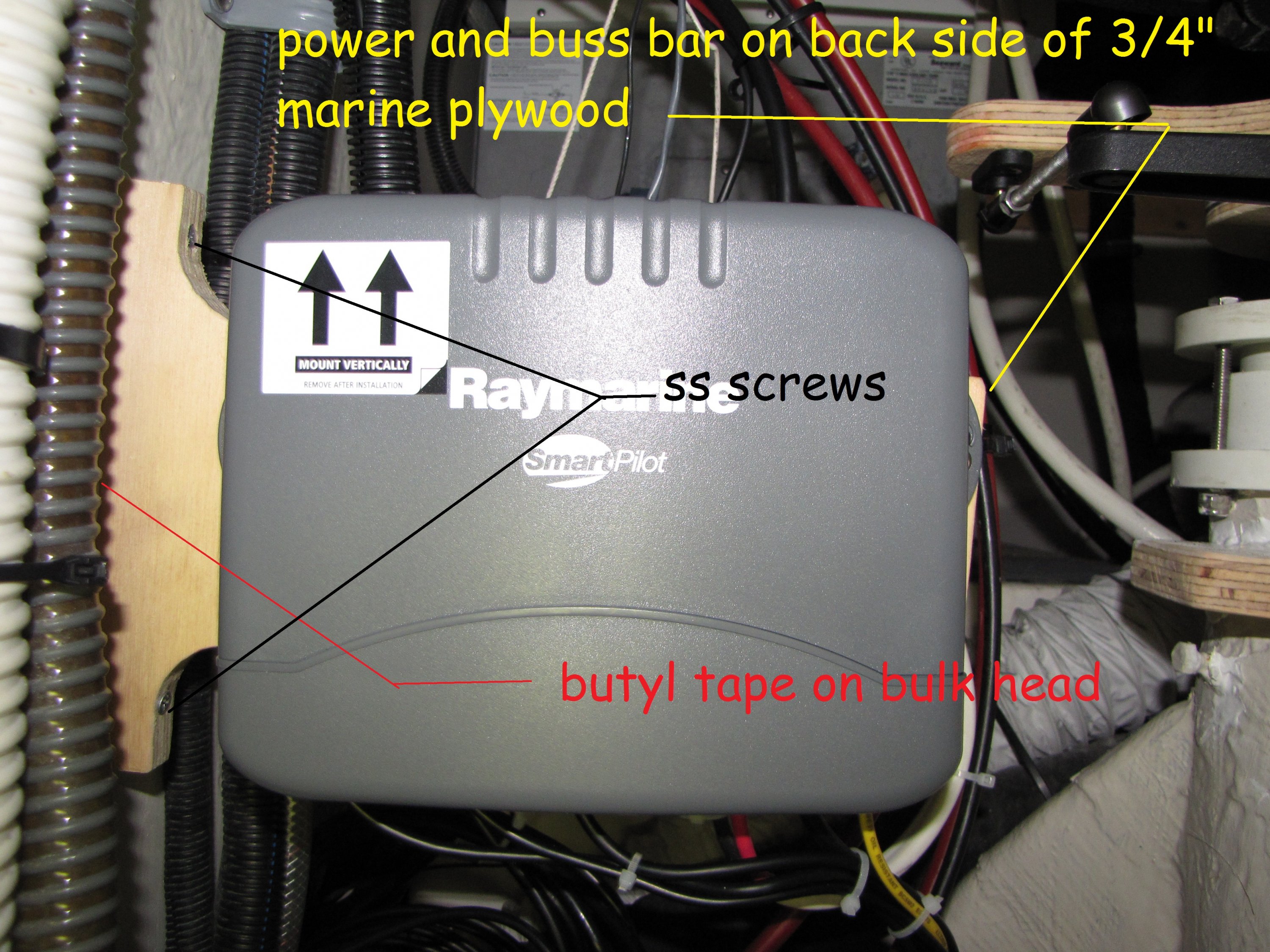

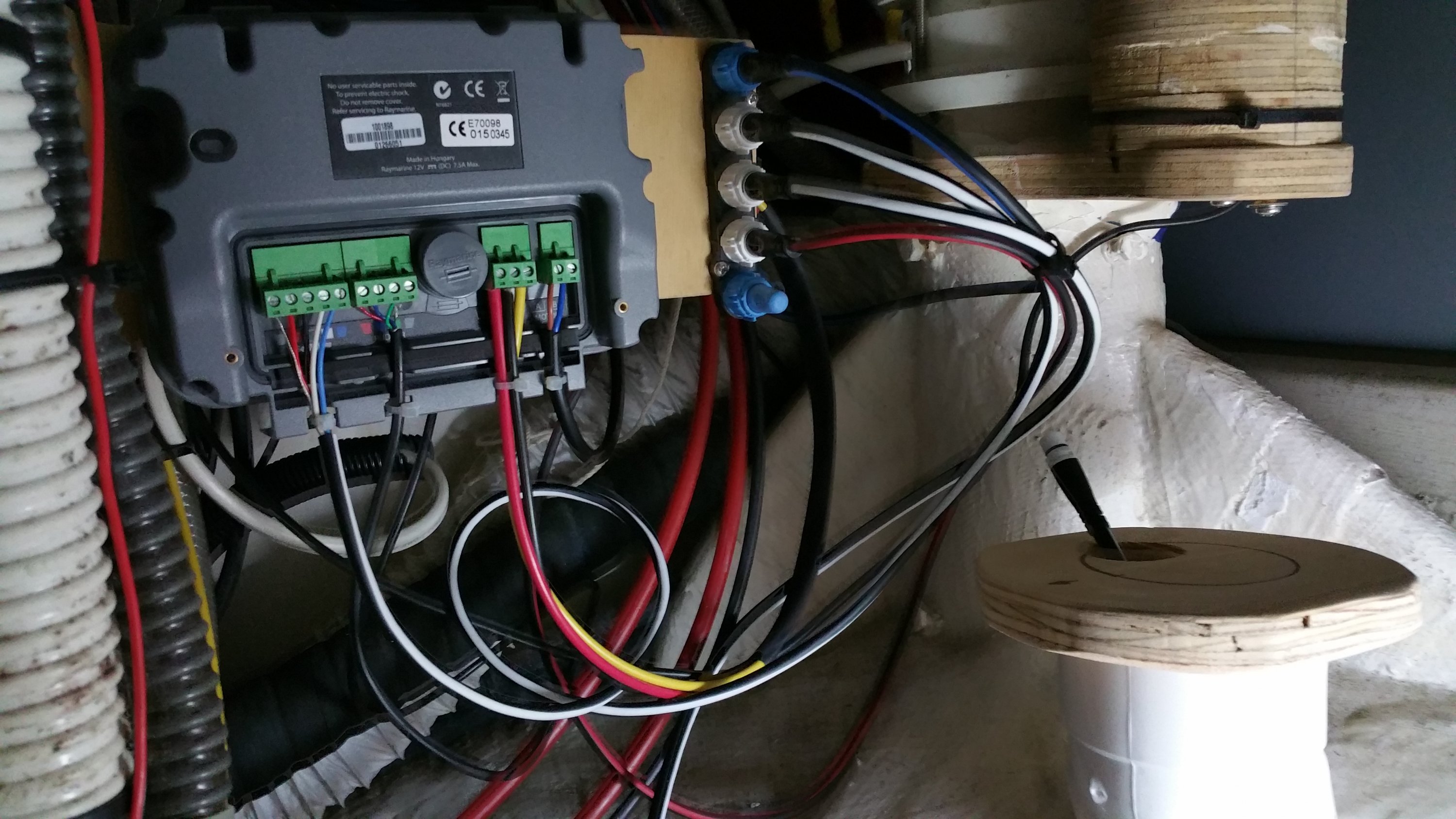

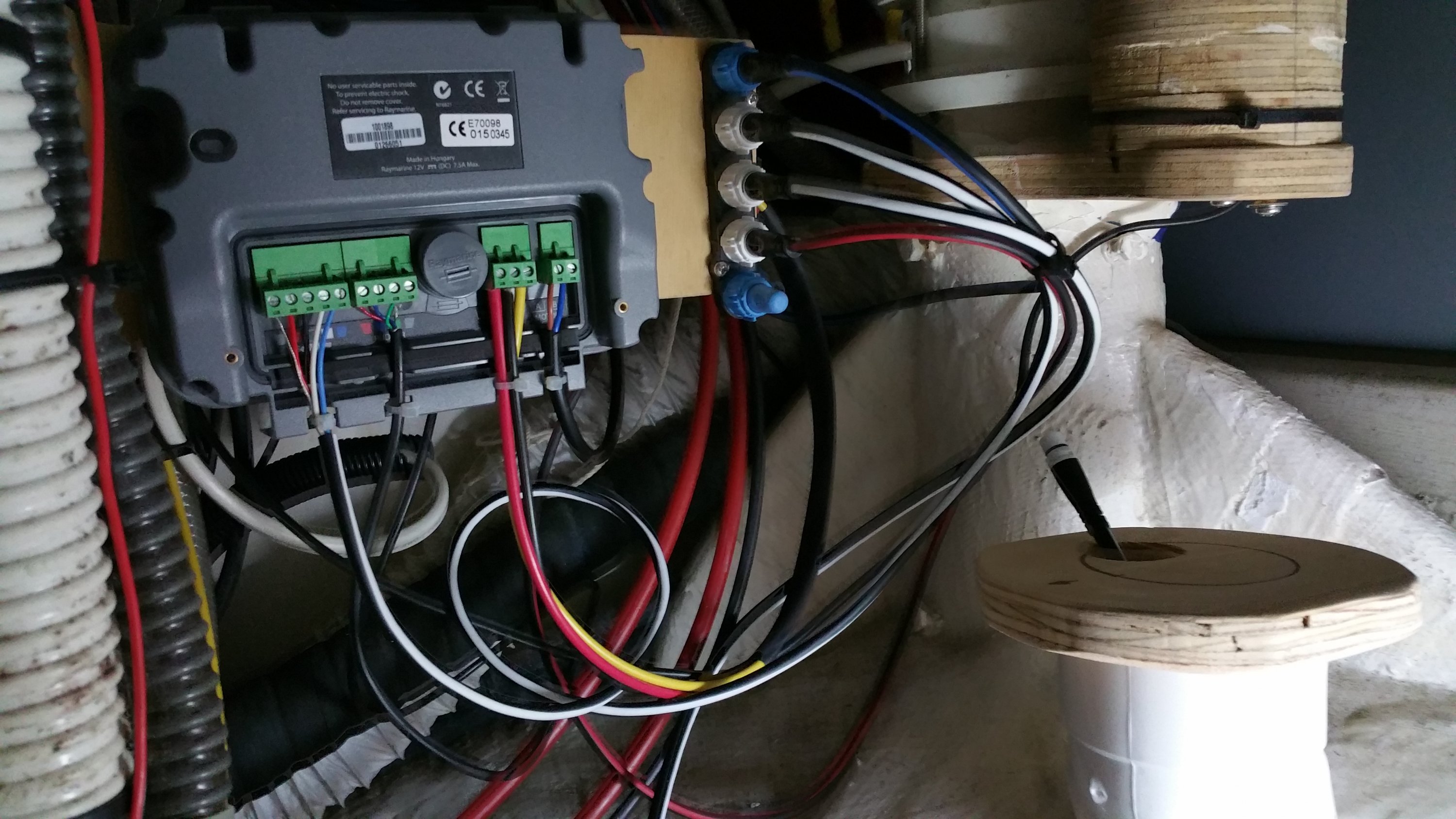

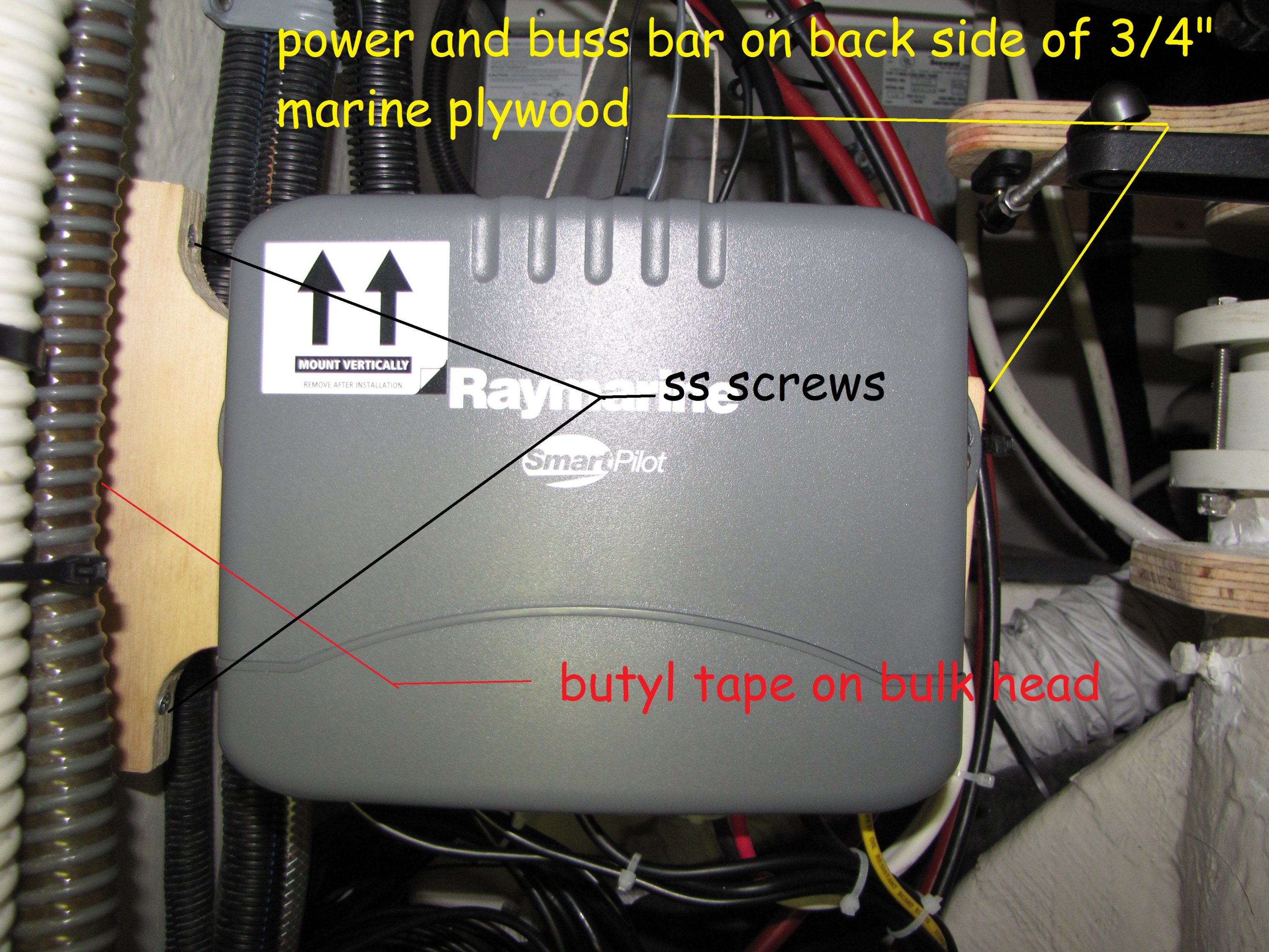

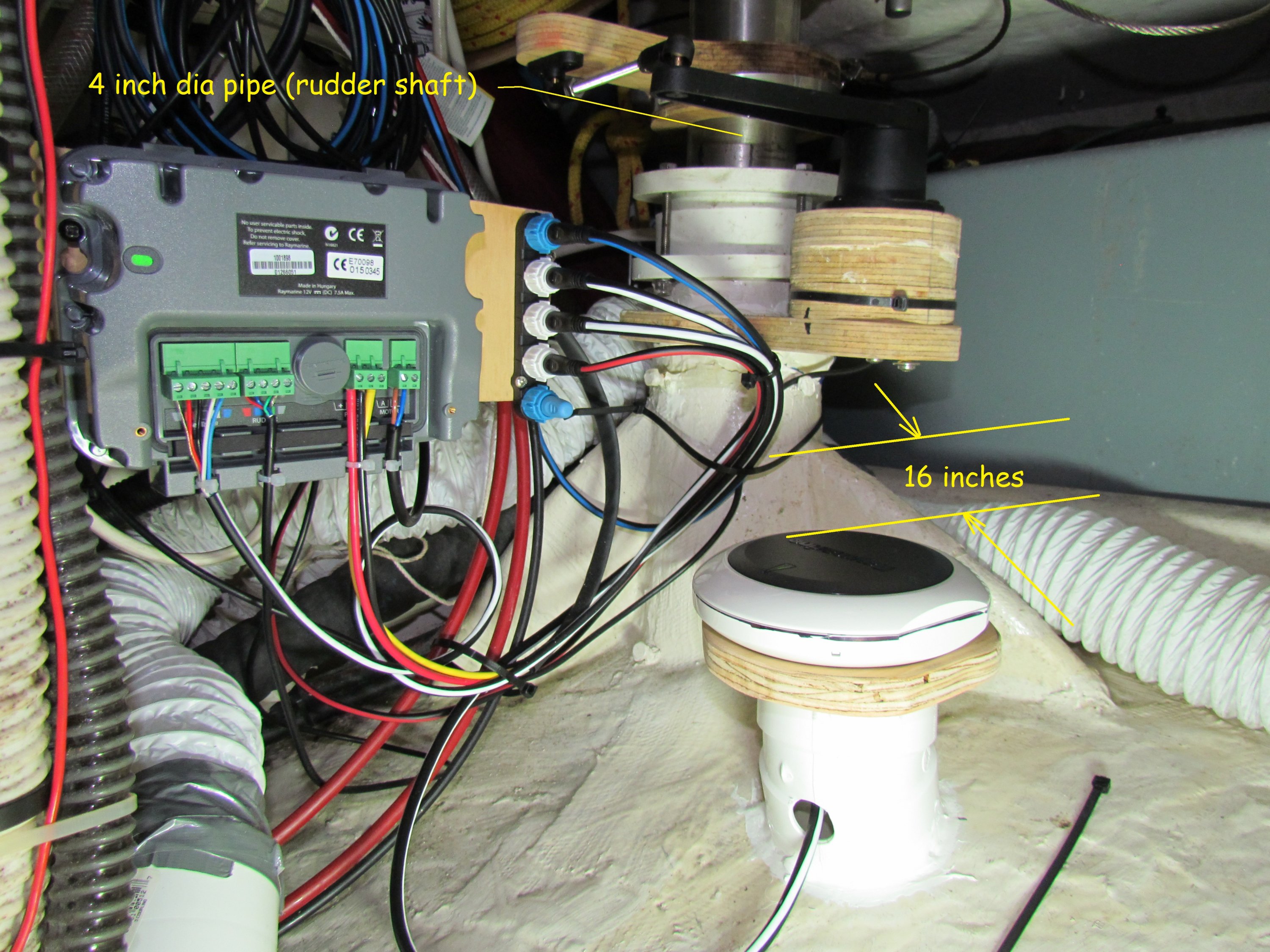

Paul, from your pictures it looks like you mounted your ACU controller on a board perpendicular to the aft bulkhead. How is the board attached to the bulkhead? Did you consider mounting it on the forward face of that bulkhead, in the aft bunk area?
Nov 16, 2012
1,055
Catalina 310, 2000, #31 31 Santa Cruz
marchem
No .
See picture.
paulj
:hook2:
Thanks. At first I thought you mounted it on the bulkhead, but there's too much on there already. Have you noticed any issues with the sensor mounted so far aft?
paulj
Mar 16, 2007
1,361
Catalina 310 Anacortes,Wa
It works.............
paulj
:hook2:
