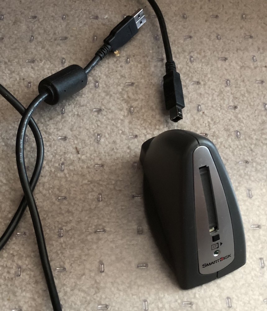

CF to USB. The thing looks like a little box with a CF slot in it, and a short USB cable.
Here's what mine looks like, your experience will probably be different but the end result will be the same.
