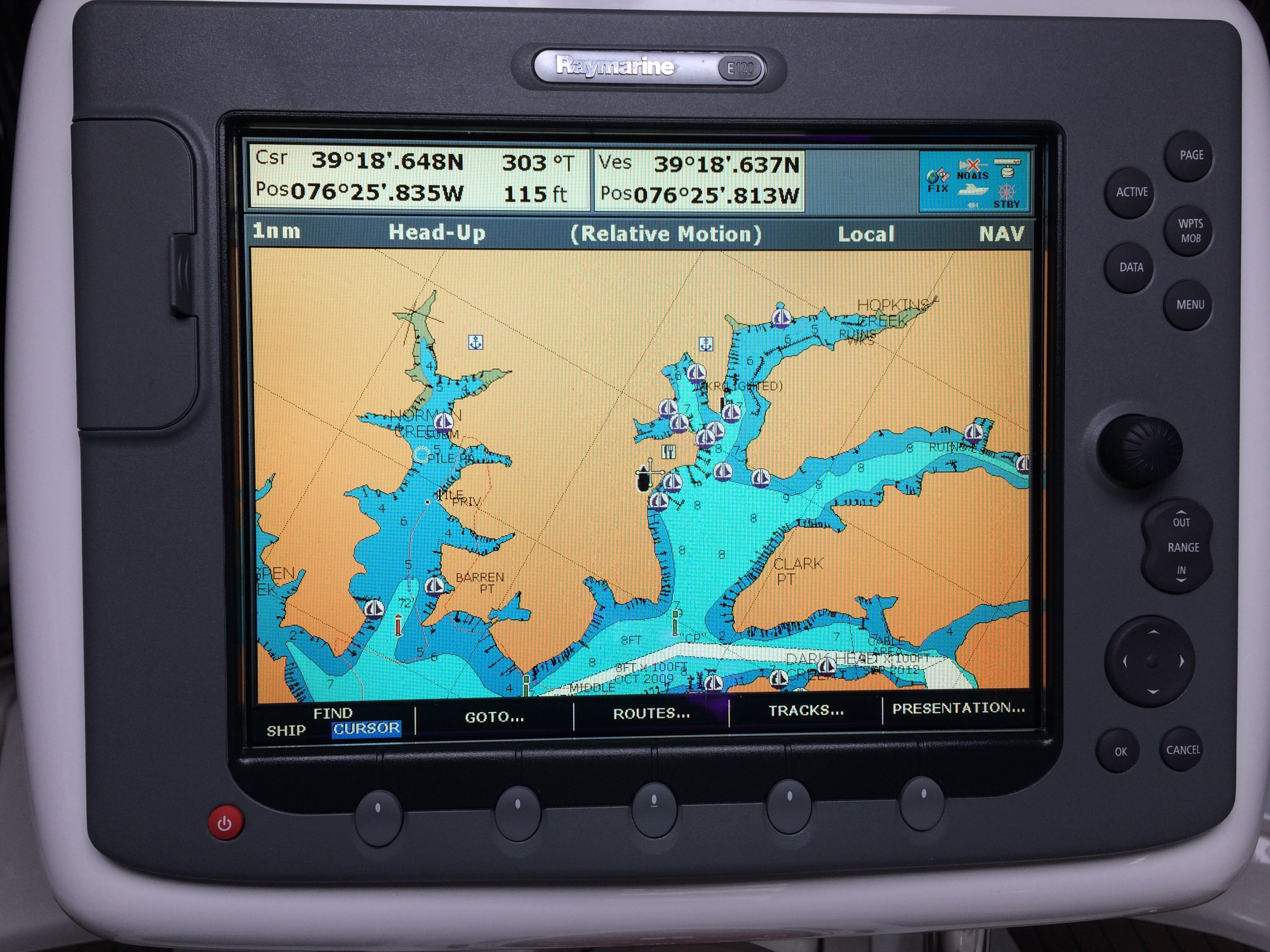

I have a circa 2007 raymarine E-120 MFD chartplotter. I just updated to firmware from v 3 to v 5.6. The current map CF card is the Navionics Gold charts. I want to upgrade the charts to cover the US east coast and Bahamas. Looking to see if anyone has done this using the current card instead of buying an entirely new CF card. I'm not impressed with Navionics, their website is a bit difficult to navigate to what I want. Has anyone used a different manufacturer for the chart card? Where is the best place to purchase the pre loaded cards?

UPDATE: OK so what I ended up doing was first I updated the firmware to the latest, which is v5.69. That was pretty easy actually, and was done using my iMAC at home and a blank 512mb CF card. Then after consulting several marine electronic techs, I bought a new Navionics US & Canada Marine & Lakes CF card for $179, and although I had my own CF card reader, it came with one. I could not just use the old Navionics GOLD card and put new maps on it, because the thing was so out of date, the downloader program wouldn't even find it. So Navionics tech said that when I receive the card, I can go in a delete all the maps that are on the card that I don't need, which were about all of them, then using the downloader program pick the areas where I needed maps, the entire east coast and west coast of Florida and northern Bahamas. I also downloaded sonar data for the same areas and hopefully the E-120 can display that also. So now I have a new card with the freshest data, an updated E-120 with the latest firmware, and I plug it in tomorrow to see if it all works. Fingers crossed.
