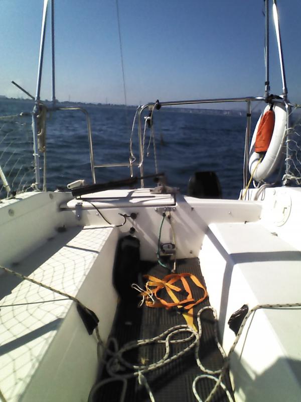

I just installed mr Raymarine ST1000 today. Quite a crappy manual. Unit, while a bit noisy, works fine. Hardest part was emptying the boat to run the wires properly for it and the solar panel. So far, I'm happy with it. I do note the manual says the use a 12 amp fuse...good luck finding one. I use a 10 amp.
