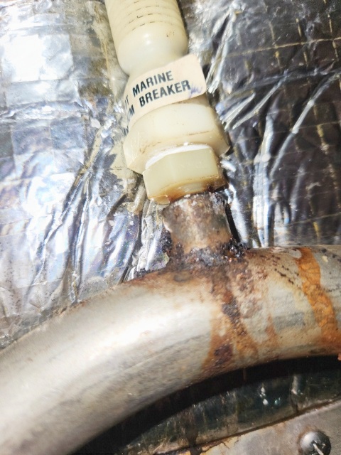

I have a small drip from the vented loop in the raw water line to the Mixing Elbow. I cannot find this loop or the vent on the Yanmar 4JH2E parts manual. Does anyone know the part number for this vent valve?

It is a generic vented loop, not a Yanmar Part. The vent sometimes gets plugged or loosens. Unscrew it, clean it up and test it. It should allow air to flow when you suck on it and stop air if you blow into it. If it is still good, reinstall it with some teflon tape on the threads.

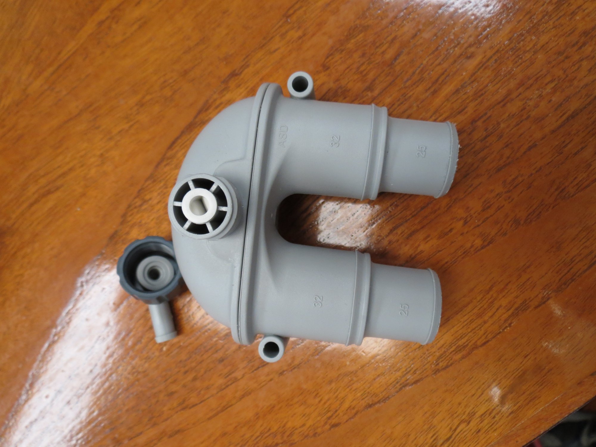

As Dave stated Scot is the part you want. Mine looked liked yours and replaced it a while back. The plastic vent broke off from the rusting.
Sorry, This is the best photo I have of the repair but you have the right source for yours now. You can zoom in on the photo and see the name.
An easy enough job to get back to normal.

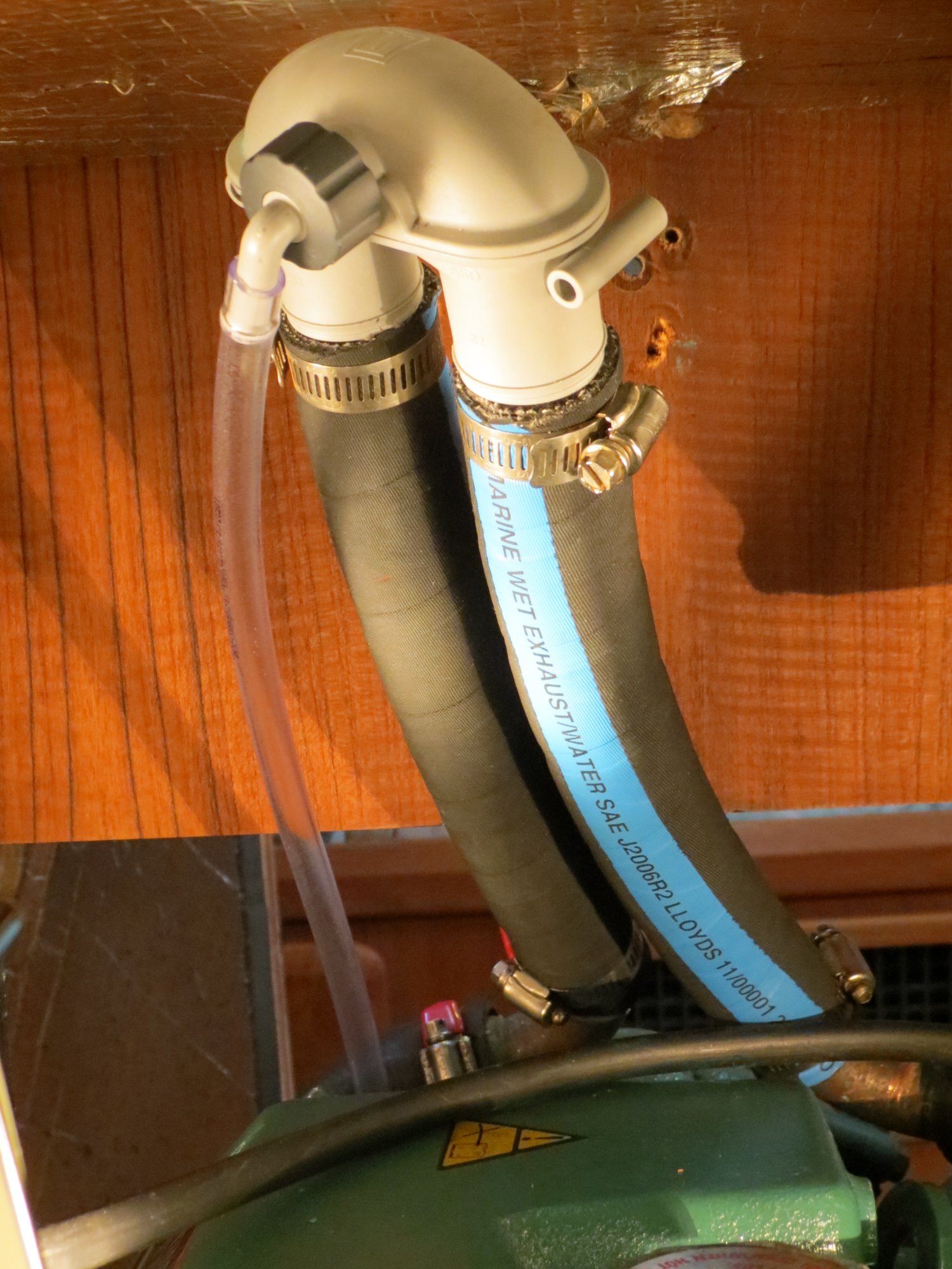

FWIW, I replaced my entire vented loop a couple years ago because I couldn't find or repair the valve. $60 for the replacement. And I also have a small 3/16" hose connecting the vent to the bilge. I too have had a leaking valve make a corrosive mess on the engine.

@Rich Stidger What kind of vent valve do you have that you can install a hose to the bilge? This Scot vent valve is available for about $30. Did you use a stainless steel vented loop or a synthetic vented loop? Source if you have it?

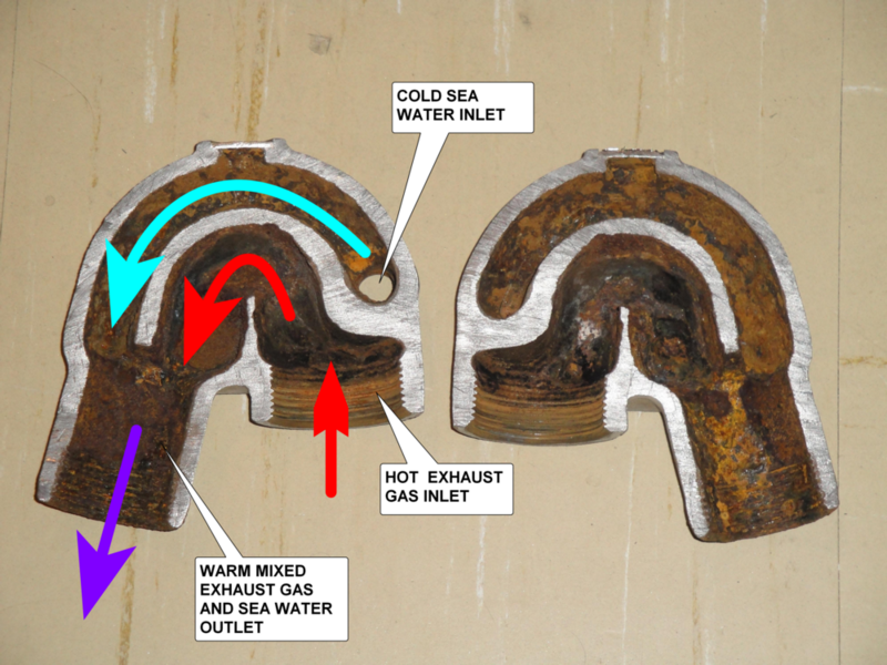

PS in trying to keep things as accurate as possible late at night, please note the correction in my flow diagram in post #8. Anyone who knows the difference between a boat and a barge knows that the exhaust gas cooling water would come from the heat exchanger.

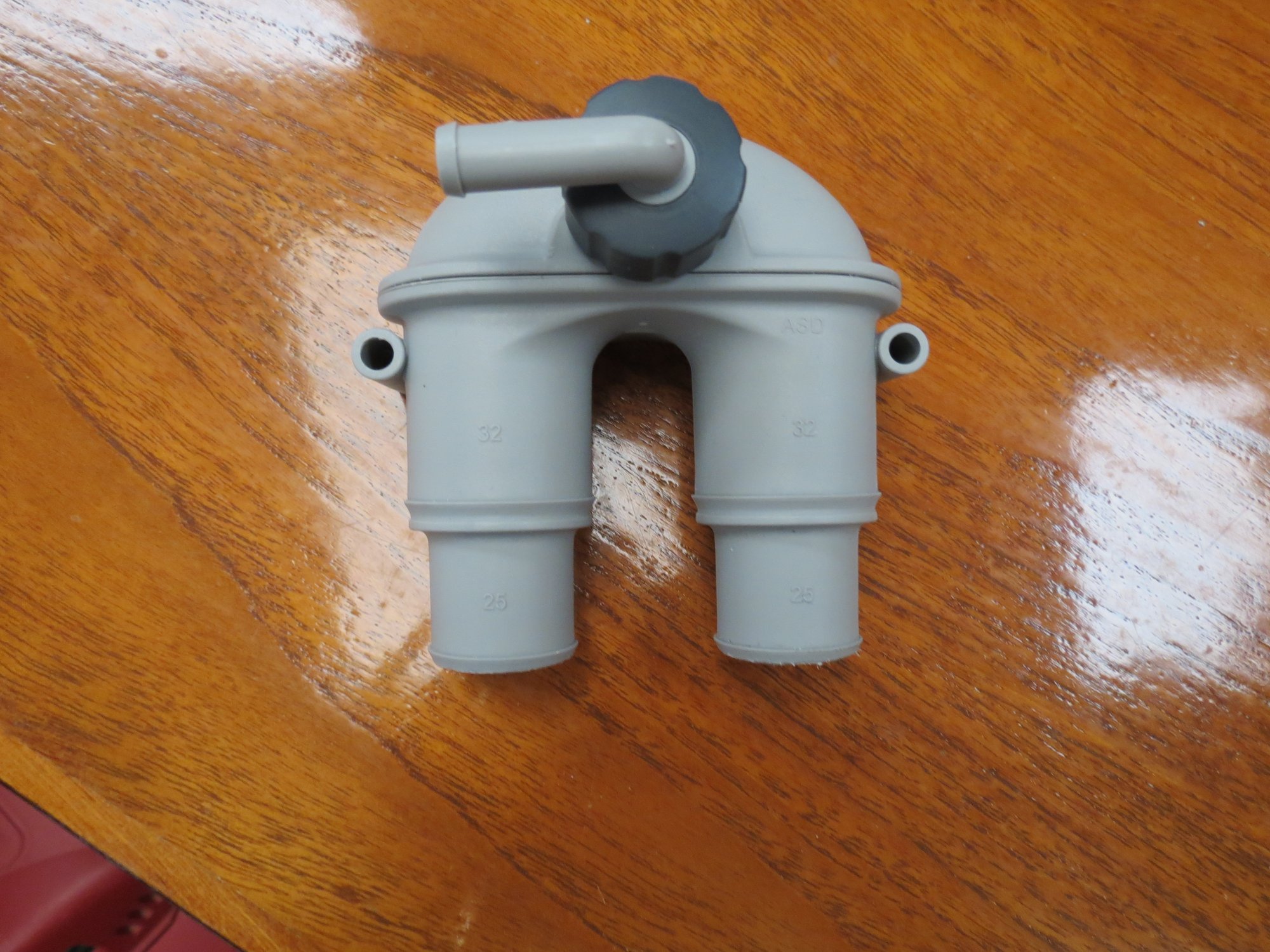

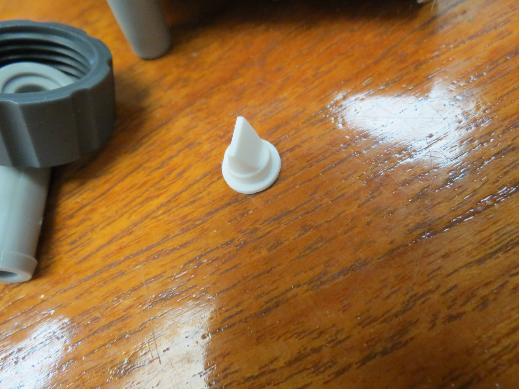

It was a synthetic unit. IDR the brand or source. The valve had a small connection for a small hose. The valve itself used a small silicon duck bill. The brand may have been Vetus. I have had no luck buying a replacement duckbill. I'll see if I have a picture and send later.

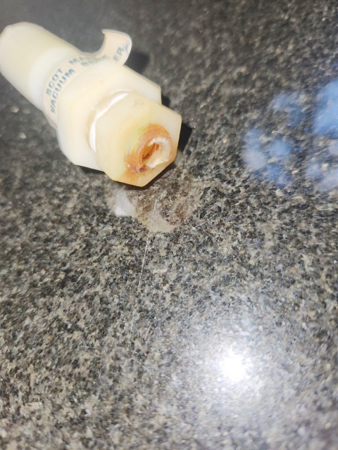

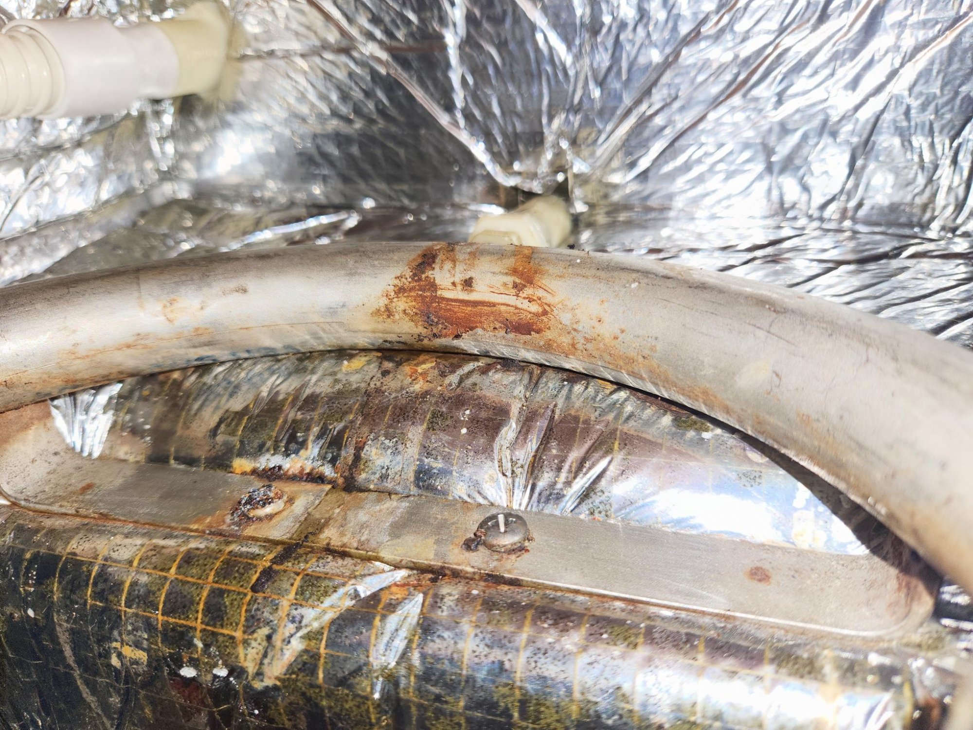

Well, I know what the source of the leak was. It looks like it is an old crack. Now I have to get the nylon (or whatever it is) piece that is still in the metal loop removed. I'm thinking of an easyout. I don't like using them to remove a metal piece from metal because if you break it, it is very hard to get it out since the easyout is hardened steel. On the nylon there is little chance of breaking the easyout.
