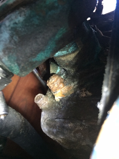

My bilge is normally very dry, so if there's any sign of water something isn't right.
After working on replacing my impeller in the Oberdorfer pump and getting that working 100%, I was inspecting for leaks and noticed that there was water dripping from the lower mounting screw on the flange the mounts to the engine block. As you'll see in the photo, it looks like this is not a new problem, there's lots of visible corrosion there.
So, my questions are... Is this water likely coming from the inside of the pump?
There's no water of any kind between the pump flange and the engine, correct? - Meaning, I could remove the pump completely from the block and there is no water or fluid between the two, right?
IF the water IS coming from the inside of the pump, that means I've got a bad seal somewhere inside the pump, right? And I will likely have to get some new parts for the inside or take it to someone?

I called a local shop and they told me that the seals are just worn and there's a weep hole right there that is supposed to allow it to drip out.
So, now that the pump is otherwise working, what seals do I need to replace to get this water tight again?

UPDATE:
It stopped leaking... lol.
But I know it must leak once in a while because of the visible evidence. My theory is that since messing around with the impeller so much I must have disturbed the old seals, and eventually it settled back into whatever seal/groove it was in.
So, I will not be rebuilding it just yet. I'm going to keep the parts though. I think I'm going to order a replacement NEW pump later this year, swap it out when I'm not sailing or using the boat, then rebuild the old one and keep it as a spare.
