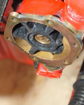

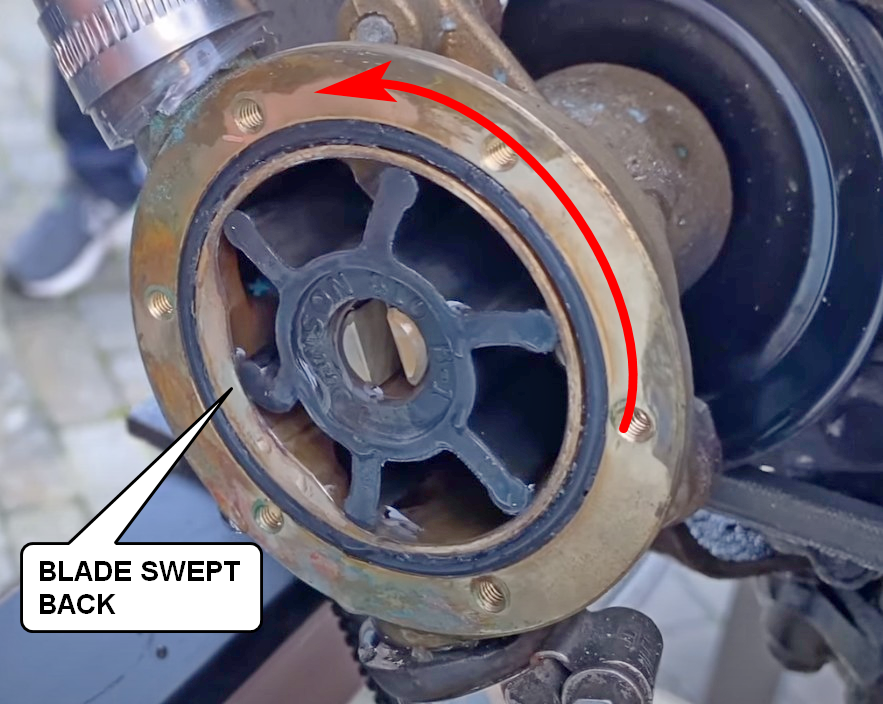

Hi all,
I attempted to replace my raw water pump impeller and when I opened the face plate I saw this (see attached photo).
Now, I know for sure that the sea water comes from the bottom right input and leaves to the top left output.
I would expect that this implies that the pump turns clockwise.
Then, why in the world the impeller wings are facing the wrong way (as if the impeller turns counterclockwise)?
Any ideas?
thanks
Achilles
10,150
Sometimes, as the engine is dying, it will come up on a compression stroke that makes it kick backwards a half revolution or so. That is enough to reverse the vanes. Install the new impeller with some grease and before you put the faceplate on, leave the seacock closed, and hit the starter for a second and watch how the vanes behave.

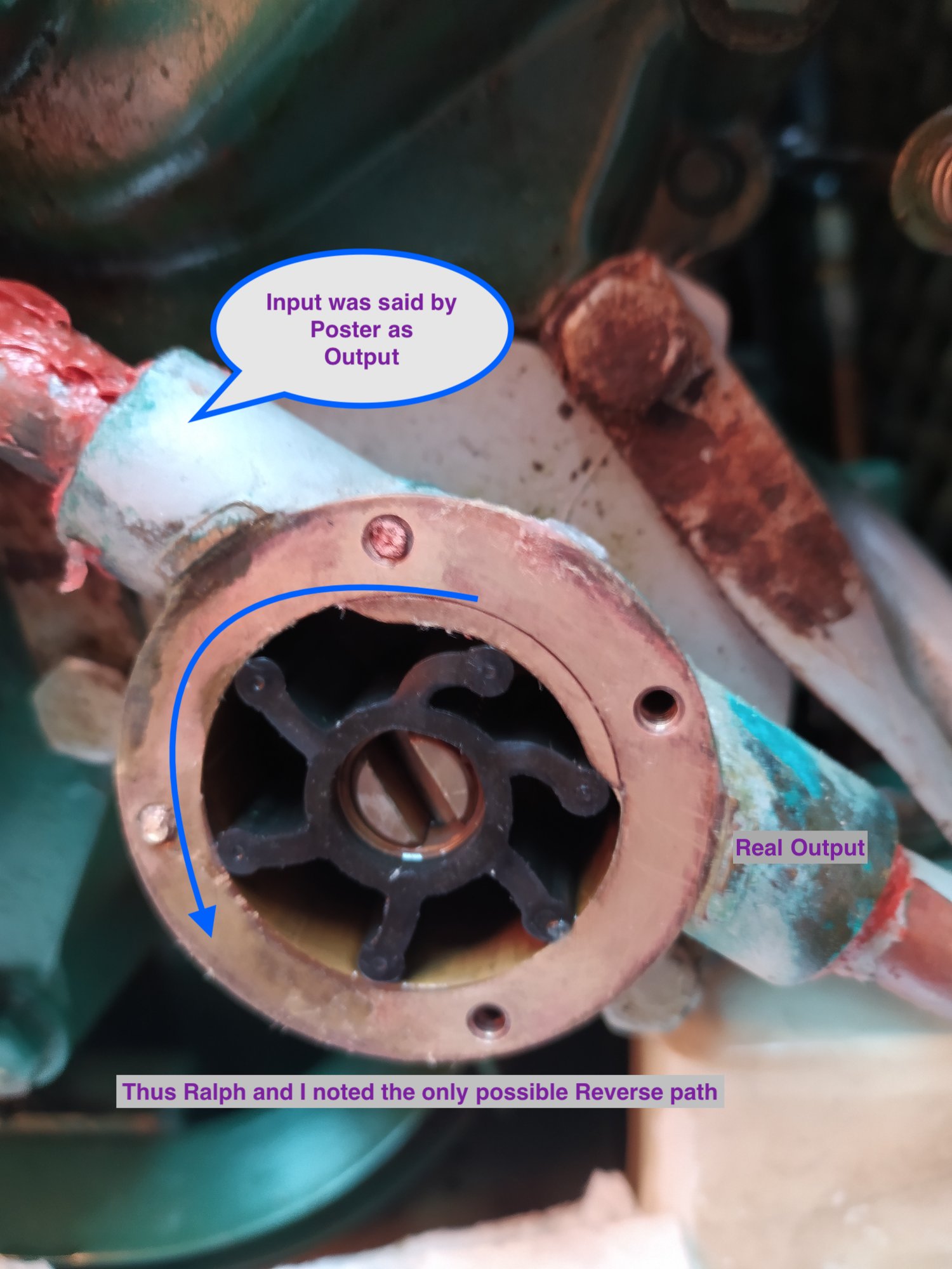

The pump is as kosher as matzo ball soup. It turns anti-clockwise if you want the water to go as @JamesG161 shows in post #4.
I couldn't imagine that thing turning CW even in my last acid flashback from the 60's.
If I could suggest, first place an arrow on the pump sheave showing the CCW direction of rotation for the impellor. Then lubricate the impellor with hand soap (must be water soluble) and assemble the pump. Replace the pump body and attach the V belt. Kick the engine with the starter and mark an arrow on the crank sheave to show engine rotation :
Follow the direction of rotation down to the pump sheave and see which way the impellor is turning.

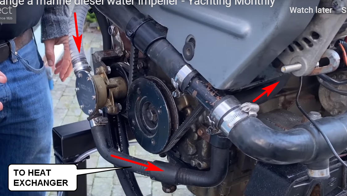

Hi there,
this short video shows why you are mistaken and the pump should operate clockwise:
in a nutshell, the water circulates the long arc, not the short one from input to output...
anyway thanks for the funny reply!

We'll have to forgive you for your mistakes here as the video maker makes a few minor slips with his hands which will confuse the uninitiated.
Notice at 1:23 minutes, the speaker loosely indicates the ingress is on the RH side of the pump and sweeps his hand from right to left. This is incorrect.
At 4:44 - 5:00 the speaker corrects himself and traces the direction of flow from the RH side of the pump off to the heat exchanger mounted on the engine
This will clarify all of your misunderstandings. The impellor turns CCW and the blades are swept backwards.
The flow in this type of pump is always across the short bottom of the casing and NEVER around the long arc.
Carefully notice what the speaker says at 5:40 as to how to bend the impellor blades as they are inserted back into the pump casing.
To finally show you how the impellor blades always bend backwards as they rotate, take your open pump and turn CW for a rotation and then CCW for a rotation. Notice that the blades always flip backwards to trail the direction of rotation.

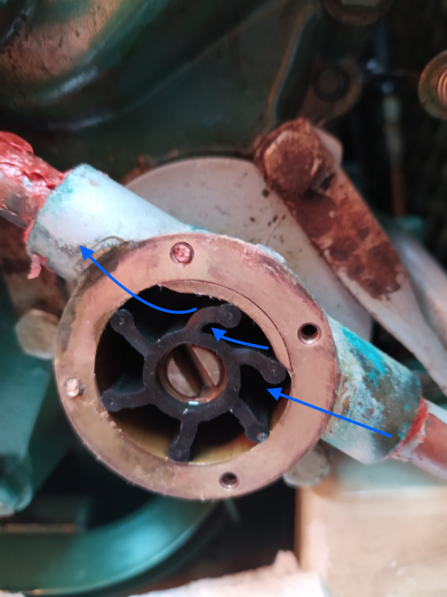

The speaker in that video is a bit unclear when he puts the impeller back in and suggests water flows over the cam. He probably got tricked when he opened the pump and saw the vane flipped backwards, exactly as @anastas saw. Water does not flow over the cam. @kloudie1 is probably right and the engine rocked back on shutdown.
Here’s how Nigel Calder shows the function of the pump-
The video shows a Yanmar YM series engine just like I have, and I know my impeller spins clockwise, bringing water around the long part of the arc. When I’ve opened my pump the vanes are dragged back in the direction you’d expect, but that’s just luck of the draw with the engine having not rocked backwards.

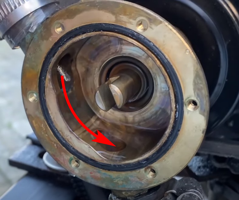

Interesting part of Maine Sail's post on impellers:
11NewImpeller
New Impeller
To install the impeller lube the entire exterior with glycerin. After lubing compress it with your fingers and seat it into the pump body..
I often hear of folks talking of using zip ties to pre-compress the impeller for insertion but I honestly don’t understand why one would need to do so. I’ve replaced impellers on very large Detroit diesels, Cummins, Caterpillars and even one lung teeny tiny Yanmar’s and all of those impellers went back in fine without a zip tie pre-compressing it. You really do not need to over think the re-insertion just do it.
If your impeller had vanes pointing in different directions when you took it out, as the photo of the old one shows, DON’T WORRY. This is rather normal and is due to the little bit of back spin a diesel can develop as it shuts down. Sometimes during the last revolution the engine may actually spin back a notch or two causing the impeller blades to be out of spin direction unison.
Even of you put an impeller in with the vanes completely backwards of the pumps rotation it would correct itself with the first bump of the starter. It is 100% urban myth/dock talk that impeller vanes need to be installed in the direction of rotation.
Pumps just like these, which use identical impellers, are used in industry every single day and the pumps are often forward and reverse pumps switching directions many times per day to drain or fill tanks, vats etc.. Please don’t beat yourself up over vane direction, it simply doesn’t matter..

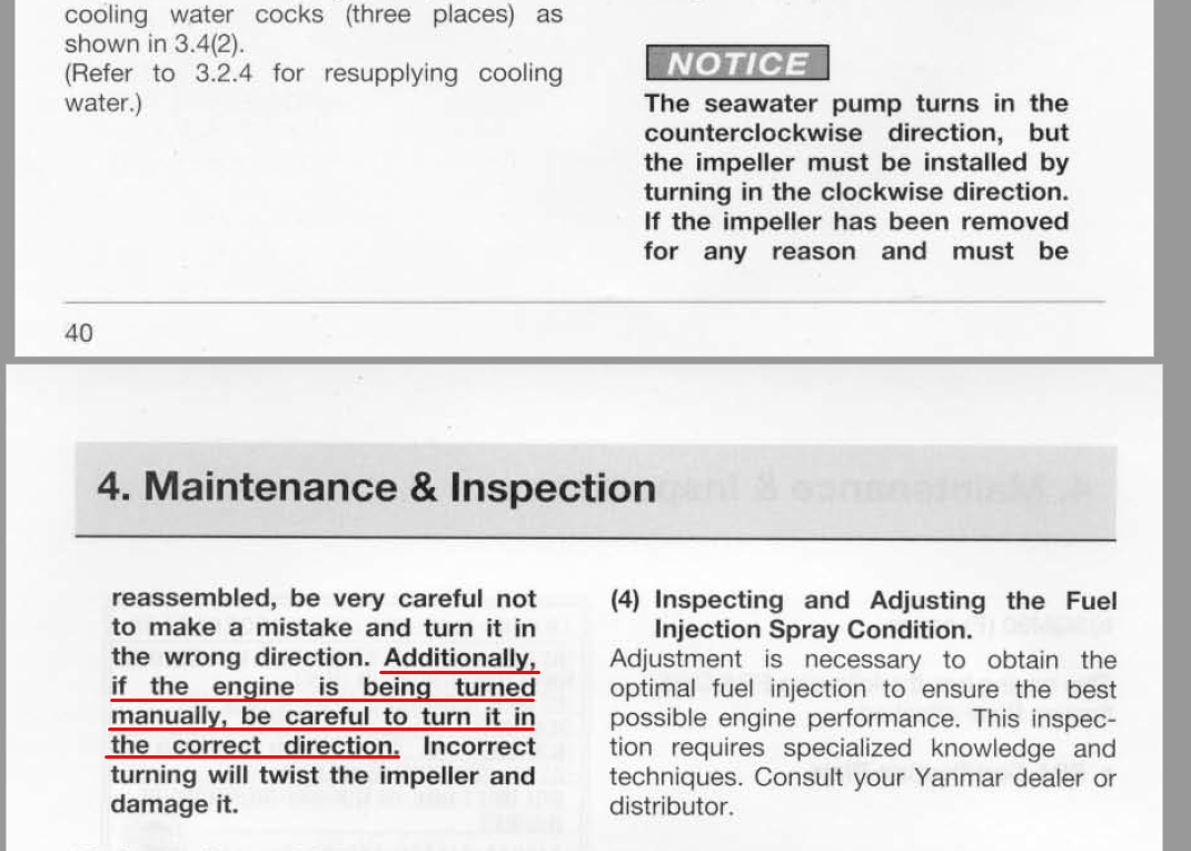

The idea of the pump backing up half a turn when stopping never entered into my mind and yet I have seen it many time as I am working on the engine and had someone stop the engine from the helm. And as far as old wive's tales being perpetuated, this is copied right out of the pages of a Yanmar maintenance and operation manual :
The vanes likely flip flop every time the engine stops and backs up half a rev. Label me as having learned something new today and thank you to all who described the flow as over the long arc.

No, vanes just flipped backward as Maine Sail said they sometimes do. The water still flows opposite the arrow you drew. (Or maybe the OP doesn’t know which way the water goes, but I think the phenomenon Maine referenced is more likely.)
Having said that, the broken screws and pink metal aren’t great signs for the life of the pump otherwise.
