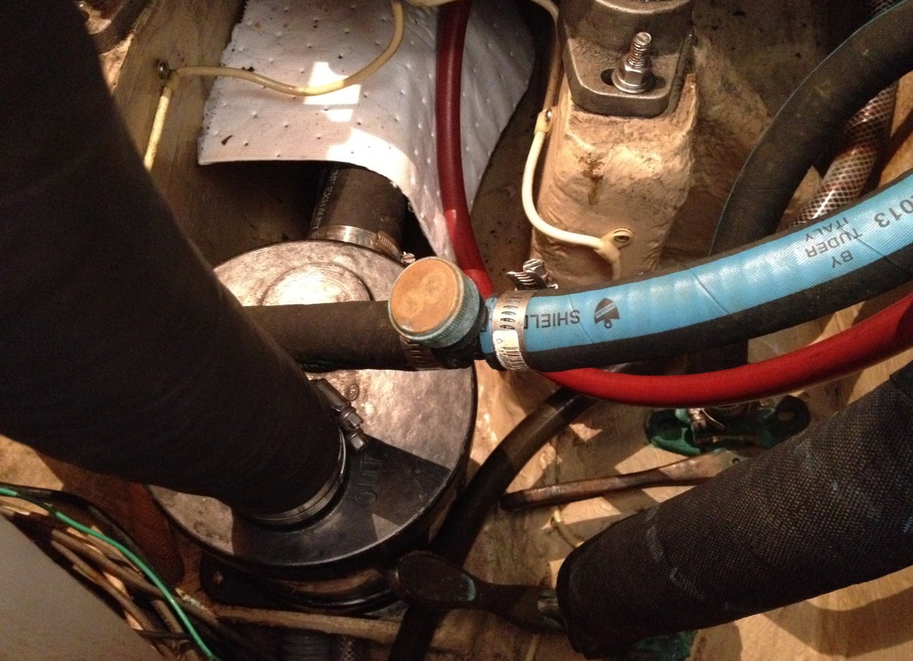

5 min to modify. Just put a capped T in the raw water line (pic). One that can have the "in" (female) side of a garden hose attached.
Then cut an old garden hose down to maybe 5 feet, or whatever short size fits your needs, and use a 5 gal bucket full of fresh water or mix with Salt Away etc. Make sure bottom of bucket is higher than the motor ie in the cockpit. Close the raw water seacock. Start the motor. The raw pump can auto siphon / self-prime. Never use a pressurized hose.
