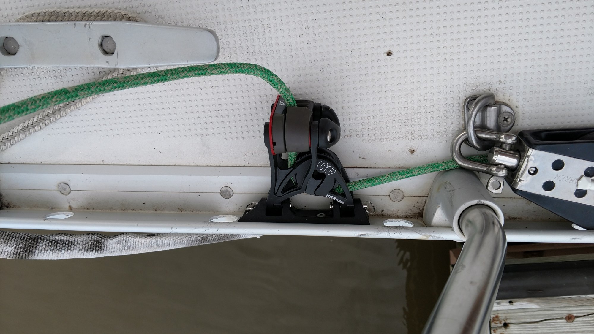

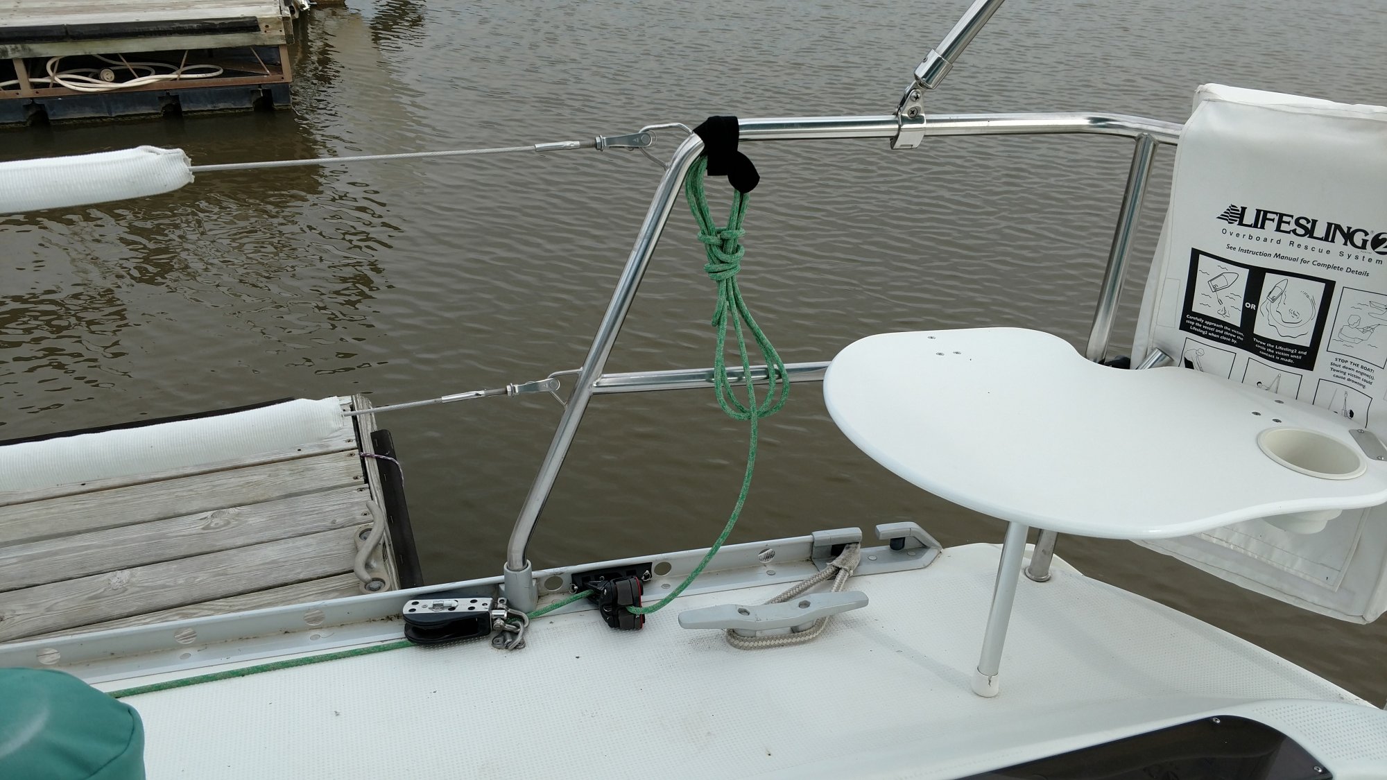

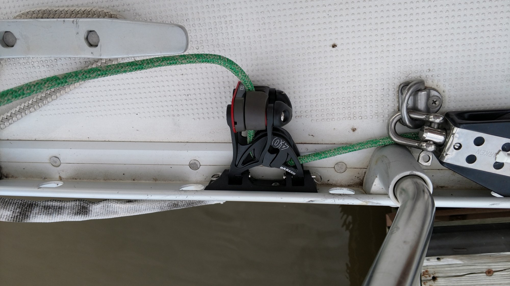

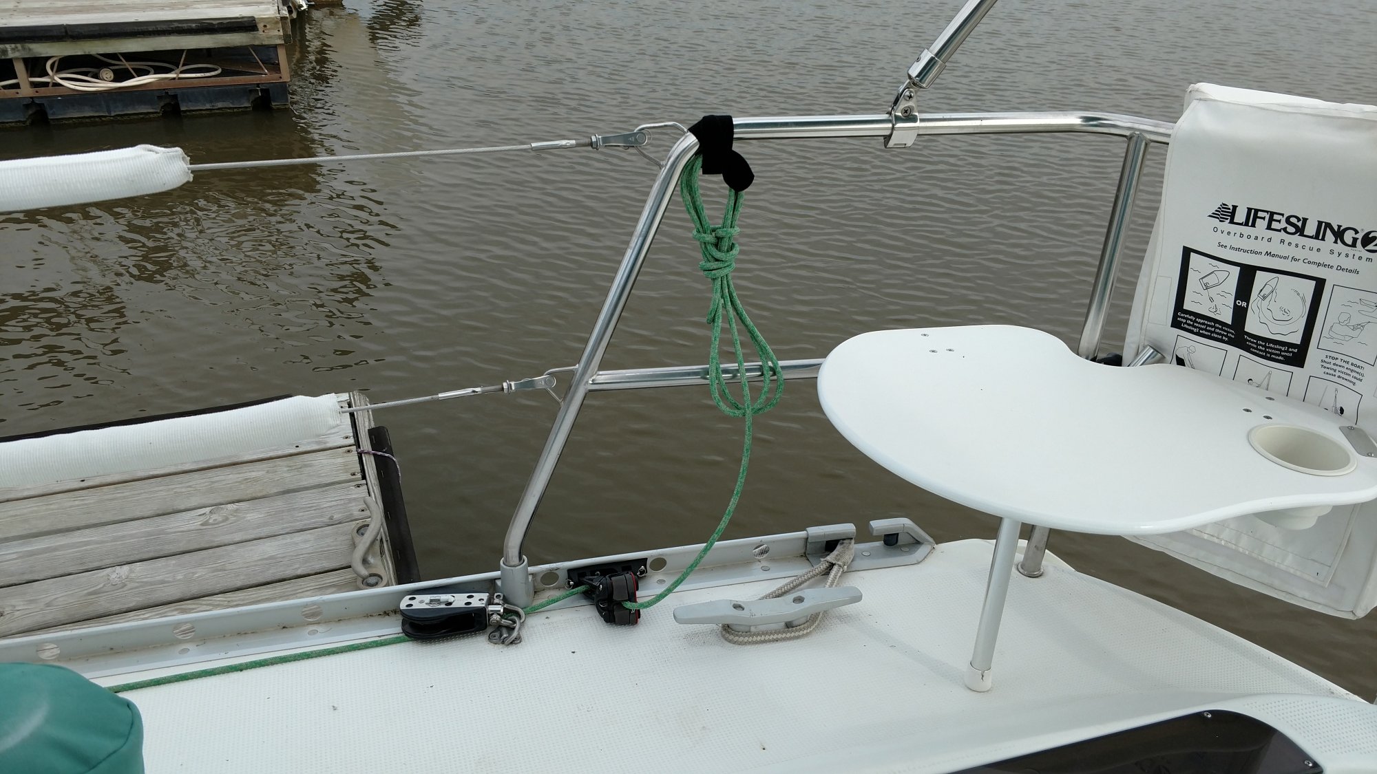

I use a harken "headknocker" mounted as shown in the photo. The pic is the one for the tack line for my Asymmetric Kite but I have the same setup on the port side for the furler line. Does not have a ratchet but I have not seen the need for a ratchet.
40mm Pivoting Lead Block — Cam-Matic® cleat | Harken

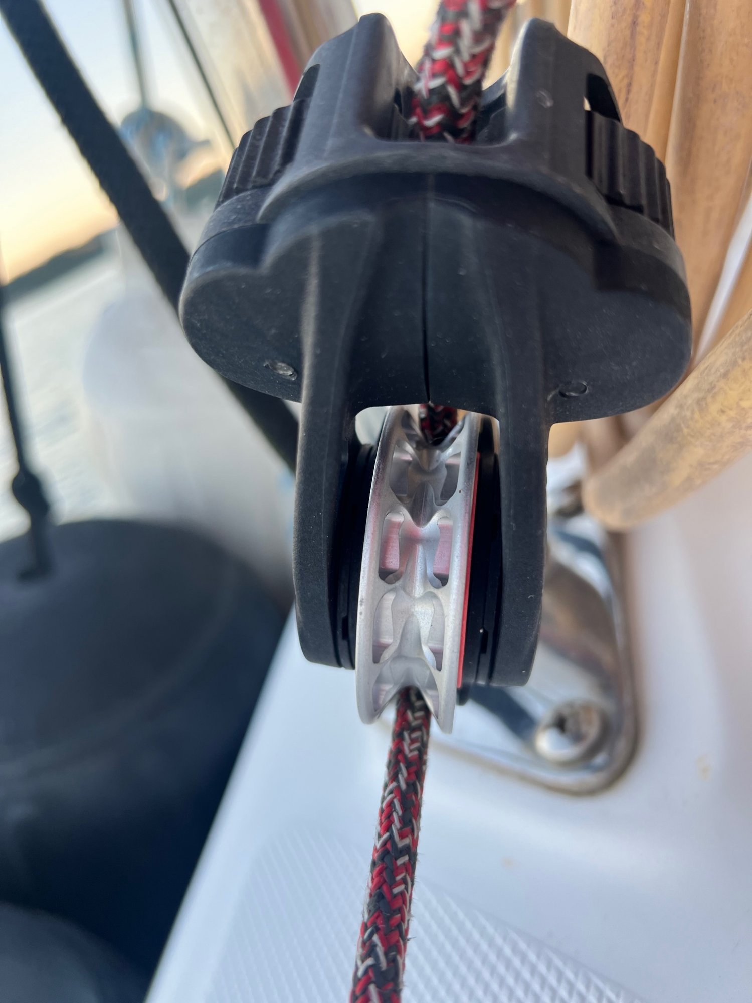

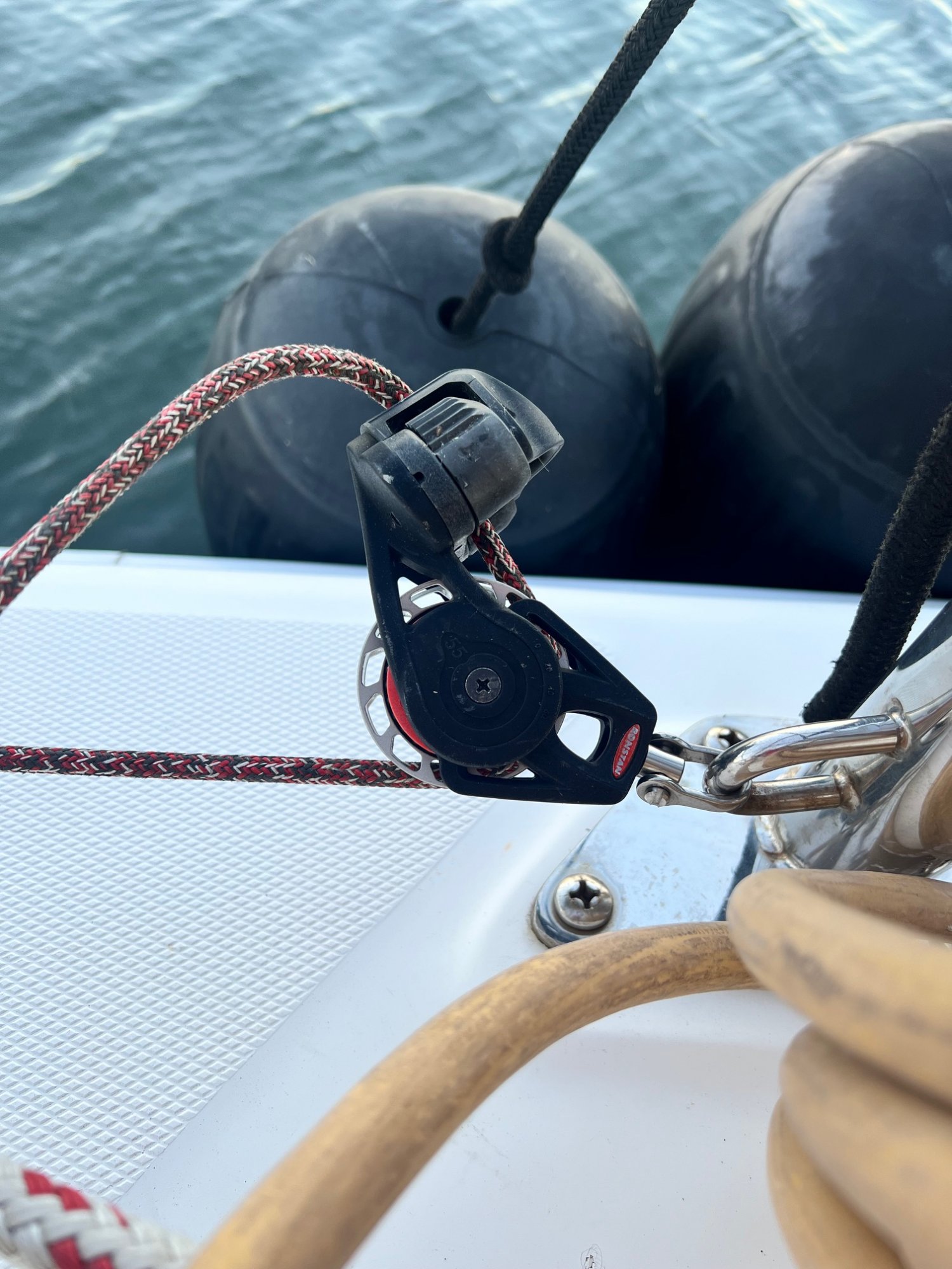

I also went with a ratcheting block and attached cam cleat.
Pics are attached. Note the tiny sized line currently installed, some kind of high strength dinghy stuff that I had and is not easy on the hands.
Anyway, for sure it has been helpful to have more 'one way' pull in with extra friction to help hold when grabbing a bit more to pull in.
Same for easier release when letting line out.
The cam cleat is also useful. Took a bit to get things aligned well given how the block floats and there is a regular cleat for permanent tie off.

Most ratchet blocks work the same, regardless of brand and age. You'd still have to get a feel for the right amount of tension, even with such a block. It's not difficult. You'll get it after a few tries
