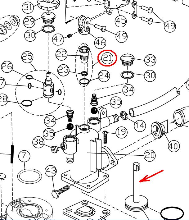

To use it: remove the 4 screws that hold the pump on the base and lift the pump just high enough to stick the nozzle on the tube into it...give the tube a healthy squirt--about a tablespoon.
Aha ..................... I see the light. I already have the 400 g. can of Superlube:
I also have a small grease gun collecting dust in the back of the shop. Attach a small diameter flex hose to the grease gun and it becomes a walk in the park to slightly lift the pump base and squirt Superlube around the interior of the cylinder. The rest of the fittings and small O-rings on the pump are much easier.
But ................. what if you were to disconnect the piston rod from part #46 and lift assembly #21 up along the rod to where you could insert the small diameter tube of the grease gun into the TOP of the cylinder and inject grease ?
Then you could take a stop watch and do a time study to see which method (top or bottom) is more efficient o_O !
Easier to lift the pump off the base once a year...and because that doesn't require disconnecting anything IN the pump, there's no risk of dislodging or disorienting something in the pump.
--Peggie
Jan 4, 2006
7,446

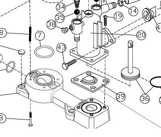

The only down side I can see from entering the cylinder form the underside, is any debris which MAY get caught between the top of gasket #39 and the underside of the pump base.
I'm 100% positive that by the time spring gets here, injecting grease on the top, as opposed to the bottom of the piston, will be the last thing on my mind and I will have been issued a clean bill of mental health for another year.
23,153
True, Ralph, but IIRC that (#39) is the FLAPPER VALVE, which Peggie recommends be replaced, too.
Dec 2, 1997
9,010
- - LIttle Rock
Hi Stu....No...I didn't. The nozzle on the tube should fit easily through the "flap." The method I describe is the way Raritan taught me to do it when I spent a couple of days in their shop.
--Peggie
23,153
--Peggie
Good news, thanks for that necessary correction.
