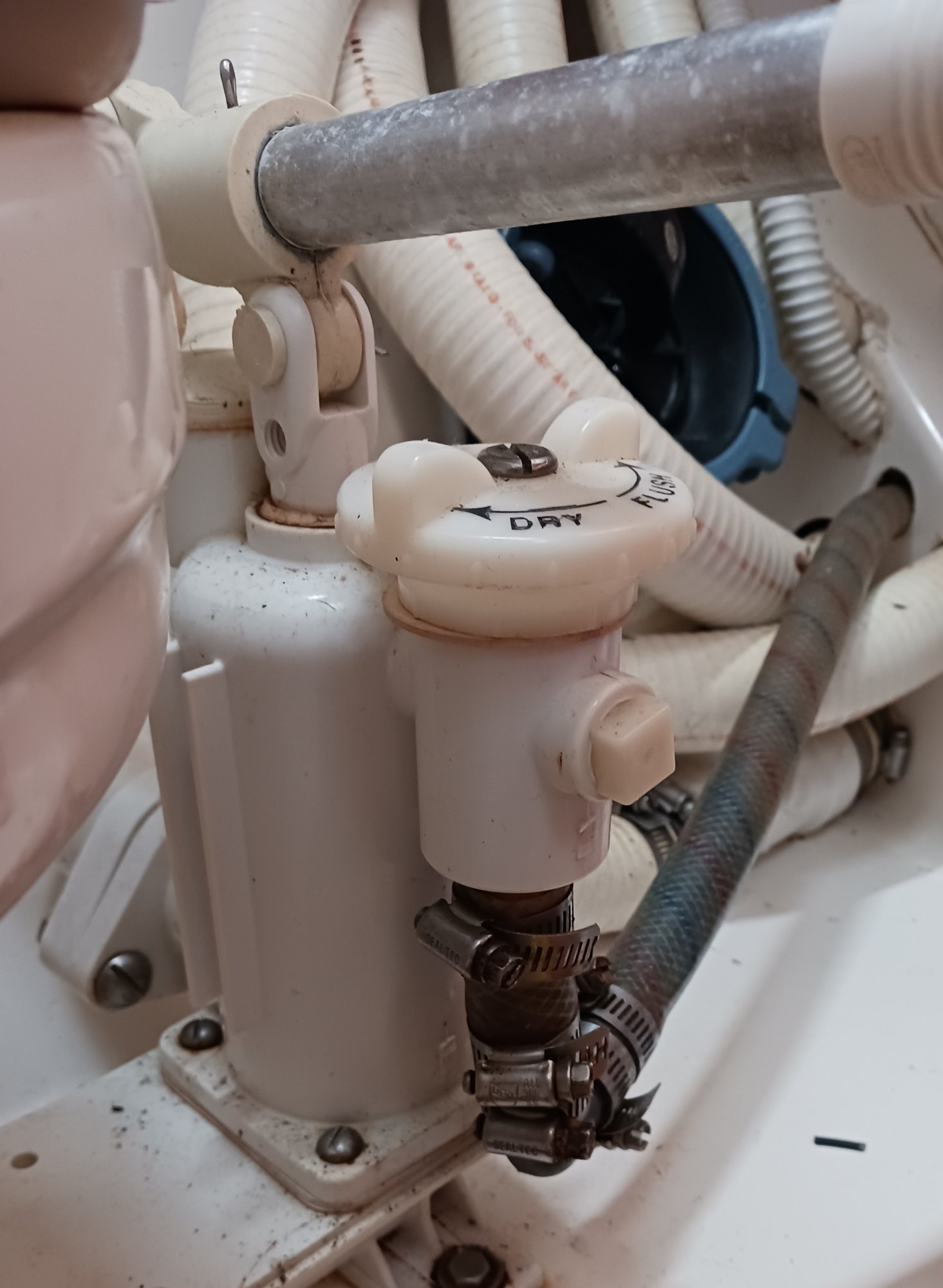

I think, I don't know if this is a Raritan I didn't see a model
It works okay Joker valve must be okay too because it hasn't backed up.
I did the salad oil thing, doesn't really help it's hard to pump, I don't know if a rebuild kit will improve that.
23,099
Yes, it is a Raritan. I suggest you get a manual downloaded from their website, then figure out what parts of the rebuild "kit" you need and don't need and just order what you do need. I was able to buy only the parts I needed from right here on sbo for my PHII. The "kit" has material that even their "rebuild" instructions don't say are needed. Learn more about the guts before you disassemble. Good luck, it's a fine unit.

The toilet is a Raritan PHII. You can download the owners manual from here Raritan SuperFlush Owners Manual (The SuperFlush is just the current version of the PHII...only the base has been redesigned...it still uses the same PHII Pump as the original PHII. A rebuild kit will cost you about $70. If you your toilet was built before 6/92, you'll need kit PHIIRK. If it was built after 6/92, you'll need kit PHIIRKC...and it's important to get the right kit because there are a few parts including the seal cartridge that are NOT interchangeable.
Looking at your photo, I strongly recommend you replace ALL your hoses if they're anywhere near as old as the intake line, and this time use sanitation hose (Shields or Trident flex PVC #148 is ok for intake line and holding tank vent line, but not for toilet discharge line or pumpout line unless you want stinking hoses in a couple of years).
