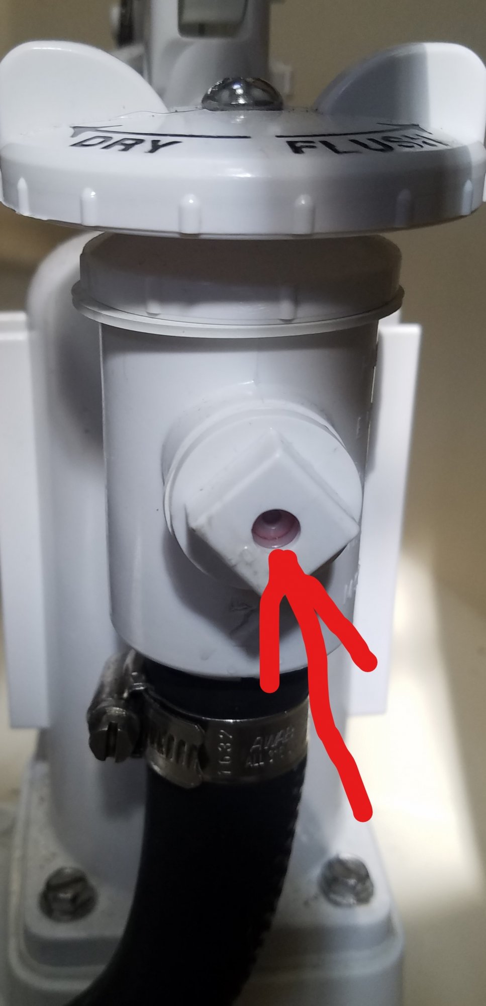

I recently installed a new Raritan PH Super Flush Head. I am very happy with its performance, but I noticed that randomly there is a sea water leak from this plug (pictured below). Originally I noticed it when the black water tank was full and I realized I had a clogged vent line, but the vent has been fixed and flows freely. Now the tank has been pumped and I still occasionally see seepage from the pink middle of the plug. I figure it is some sort of relief valve but I can't figure out why it is sometimes seeping sea water into the head. Any thoughts would be appreciated.

It's a reed type check valve that allows air to enter when you dry flush. I had exactly the same leakage when I installed the new Raritan this last winter.
Unscrewed the retainer and removed the check valve. Found nothing keeping it open. Re-assembled and it's never leaked since.
Go figure :rolleyes:.

The little square plug on the front of the pump is the air valve (part # 104W. It has a check valve inside that opens on the downstroke of the piston to allow a little air to come into the (unused) top half of the pump cylinder to stop the "vacuum kick." It sounds like that air valve is stuck. The cure: Straighten a paper clip and poke the wire into the hole in that little plug to push it loose...it's spring-loaded and you should feel it move in and out when he presses the wire in there. If that doesn't fix it, remove the square plug (it threads into the pump) and clean it. Wrap some teflon tape around the threads to seal it when you put it back.
Your toilet is a bit new to have air valve issues...if it happens again, give Raritan tech support a call. 800-352-5630
