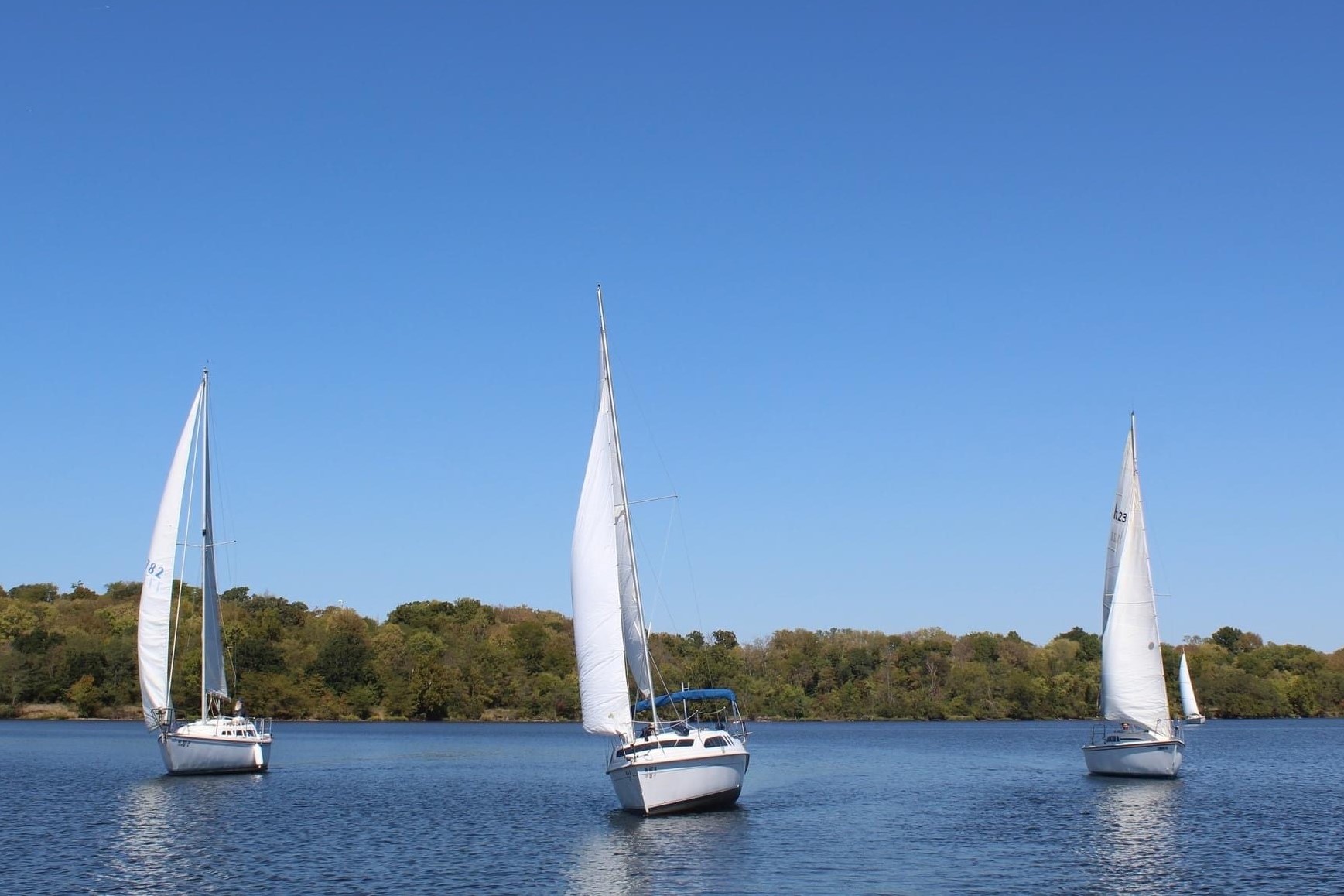

That's us in the middle. We came in 4th of 8 boats and had a lot of fun.
We would have come in third, but that little H23 passed us toward the end. Grrr.Nice! Hooray for the water ballast boat.

Chris: I enjoy looking at pictures that show sail trim. I don't know the weather conditions that day but I think you could have squeezed a bit more speed out of your boat - not a lot but some. The boat on the left is a masthead rig and his engine is the jib. It appears his jib is drawing (he should eliminate the wrinkles) but his main is flat and does not match his jib. If he trimmed the jib for the wind conditions and then adjusted the main he could pick up some speed. If the skipper checked out your boat he would have known a adjustment is in order - you've got heel and he's flat. I don't like to see race boats with fenders - makes them look slow!!That's us in the middle. We came in 4th of 8 boats and had a lot of fun.
Thank you! I'm a beginner and I love getting feedback like this. The winds were light and shifty. We had intermittent lulls where we even felt adrift for a few minutes at time, and then they'd pick back up. On one or two occasions I called for my wife to dump the jib to avoid lee helm as the breeze started back up. I had actually eased the halyards slightly, having read that it can help with light winds.Chris: I enjoy looking at pictures that show sail trim. I don't know the weather conditions that day but I think you could have squeezed a bit more speed out of your boat - not a lot but some. The boat on the left is a masthead rig and his engine is the jib. It appears his jib is drawing (he should eliminate the wrinkles) but his main is flat and does not match his jib. If he trimmed the jib for the wind conditions and then adjusted the main he could pick up some speed. If the skipper checked out your boat he would have known a adjustment is in order - you've got heel and he's flat. I don't like to see race boats with fenders - makes them look slow!!
Your boat is a fractional rig and the engine is the main. Originally I thought your main matched the boat on the left but I'm not sure. Maybe it has some draft that I can't see because your boat has some heel. Next time out go to full hoist and eliminate the wrinkles. Your jib matches the boat on the left and I wonder if you can adjust your jib. You should set your main first and then adjust the jib - just the opposite of the boat on the left.
I wish I could see the sail trim of what appears to be a masthead rig boat in the left background - his look pretty good. If he was matched against the boat on the left he'd be faster.
Chris: Thank you because I never know how some skipper are going to accept suggestions.Thank you! I'm a beginner and I love getting feedback like this. The winds were light and shifty. We had intermittent lulls where we even felt adrift for a few minutes at time, and then they'd pick back up. On one or two occasions I called for my wife to dump the jib to avoid lee helm as the breeze started back up. I had actually eased the halyards slightly, having read that it can help with light winds.

There are only 4 elements that ALL the sail trim controls for the main and jib adjust. With the main, which you have to concentrate on, the various controls adjust various elements. With the jib, the fairleads adjust all four elements.
Easing the main halyard in light air actually didn't accomplish anything other than bagging out and adding wrinkles to the main. You messed up what little air flow you had.
Do you have a traveler? One of the easiest way to deal with a wind gust is to just lower the traveler until the gust passes and then put it back to it's original position when the gust passes.

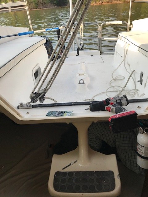

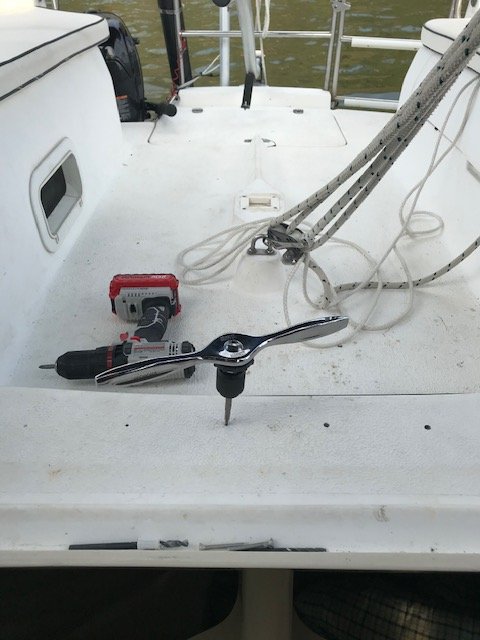

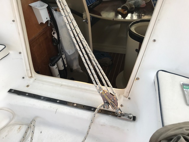

I installed a simple "homemade" traveler on my H26.... HUGE increase in upwind performance. If the H240 is like the H26, you have an embedded aluminum plate under the bridge deck. You can drill and tap&dye (add threads) to the plate to insert bolts and a T-track. I bought the T-track used on eBay for $20. Another $10 in screws and bedding compound and I had a traveler.No, I don't have a traveler. It's a pretty simplistic setup on our little boat. Thanks for the tips! I'll check out your book. And maybe I won't share them with my fellow sailors. Ha!

Rgranger: I did the same thing on a C25. It had a little pee pee traveler bar that was useless. With boats under 22' a sailor can get away without some of the controls found on larger boats. I think the dividing is about 24' to 25'. In that range you need more controls. Certainly once you hit the 27' range you need the same controls on the 30' and above.I installed a simple "homemade" traveler on my H26.... HUGE increase in upwind performance. If the H240 is like the H26, you have an embedded aluminum plate under the bridge deck. You can drill and tap&dye (add threads) to the plate to insert bolts and a T-track. I bought the T-track used on eBay for $20. Another $10 in screws and bedding compound and I had a traveler.

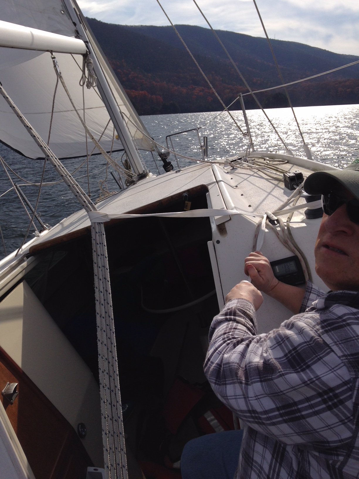

If you want to experiment with how this will affect your boat's performance before you go to all of the trouble, try bringing your main sheet over to windward using a line attached to the windward winch... like this....
...you should feel your boat "jump" a little, stand a little flatter and pick up speed. The effect will be even more pronounced with a proper traveler.
Edit: I actually bought a pair of T-tracks for that $20. I might still have the other in my shed. Happy to send along for postage (if I can find it).
Thanks...I like your barberhauler test set up!!!
Wow, that looks like a great improvement. I'll have to study my situation a little and see. That's a very generous offer - thank you. I'll let you know if I decide to do something.I installed a simple "homemade" traveler on my H26.... HUGE increase in upwind performance. If the H240 is like the H26, you have an embedded aluminum plate under the bridge deck. You can drill and tap&dye (add threads) to the plate to insert bolts and a T-track. I bought the T-track used on eBay for $20. Another $10 in screws and bedding compound and I had a traveler.
