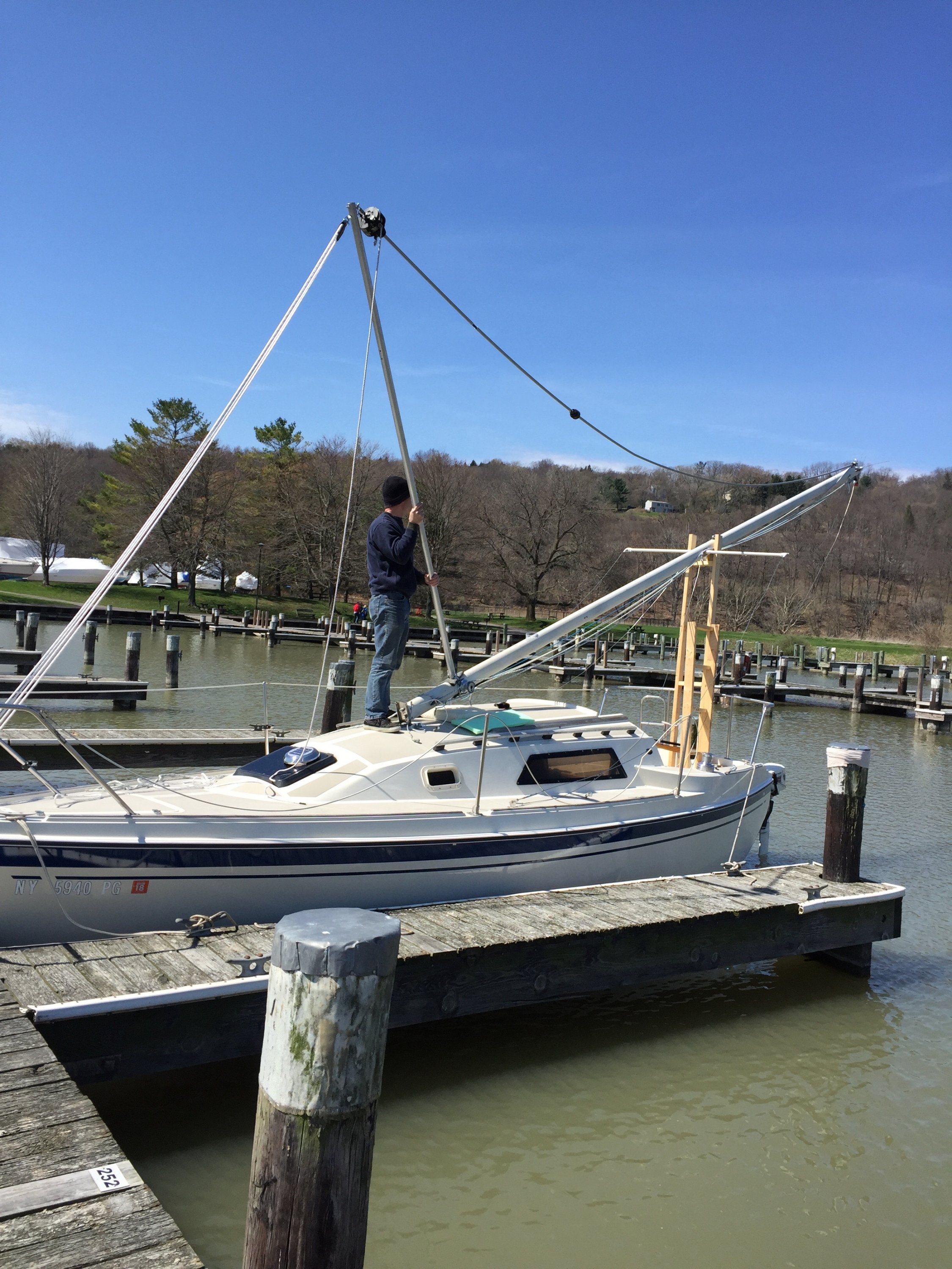

Attach your back stay if you are raising the mast from aft of the step plate. Attach any upper or lower shrouds that are directly AT or AFT of the mast centerline. Thus, as you raise the mast by hauling the gin pole to the deck, the back stay will stop it at vertical, and the shrouds will stabilize it laterally.
Most gin pole setups pull the forestay to the deck. Sounds like yours is a little different.
You can YouTube gin pole mast raising. The gin pole will hold the mast, and you can steer it with the gin pole as you raise it.
In the above photo, the forestay with furler attached is connect to the top side of the end of the gin pole. The 4:1 block with cam cleat (boom vang setup w 70 ft of line) is attached to the underside of the gin pole at one end and the forestay chainplate at the other. Hauling the line pulls the gin pole to the deck which hauls the forestay and hence the mast with it!
Note: the shrouds are midline with the mast on the Oday, so they can stay attached during raising and lowering. The back stay is also attached to stop the mast at vertical. Once the mast is vertical hard against the back stay, have someone hold it, or run a halyard to the bow pulpit to hold the mast. Then disconnect the block and forestay from the gin pole. Connect the forestay to the chainplate. You are done!

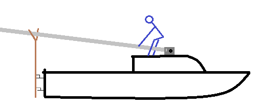

CatCapt:
I don't know how big of a guy you are but if you are at least 185 or so, you should be able to get the mast raised by simply using a mast crutch that gets the angle up a bit for a head start and then pull it up with your arms. I've stepped the mast of my Mac 22 like this with no problems at all. The mast crutch I had was a 2"x4" with pintles that slipped into the gudgeons of the rudder. Then on the top of the 2"x4" I screwed on a piece of plywood that was cut out to accept the mast. (I would use the crutch to trailer the mast also). Put the base of the mast in the tabernacle, the crutch will effectively raise the mast about 3'. That little bit of angle really takes the pressure off and makes it a lot easier to lift. Face backwards with your legs on either side of the mast, bend your knees, grab the mast between my legs and stand up and take two steps back. The entire process takes about 10 seconds. Before you start, run the jib halyard to the bow's chainplate. Then once the mast is up, snug up the halyard so the mast won't fall, then you can take your time going forward to secure the forestay.
