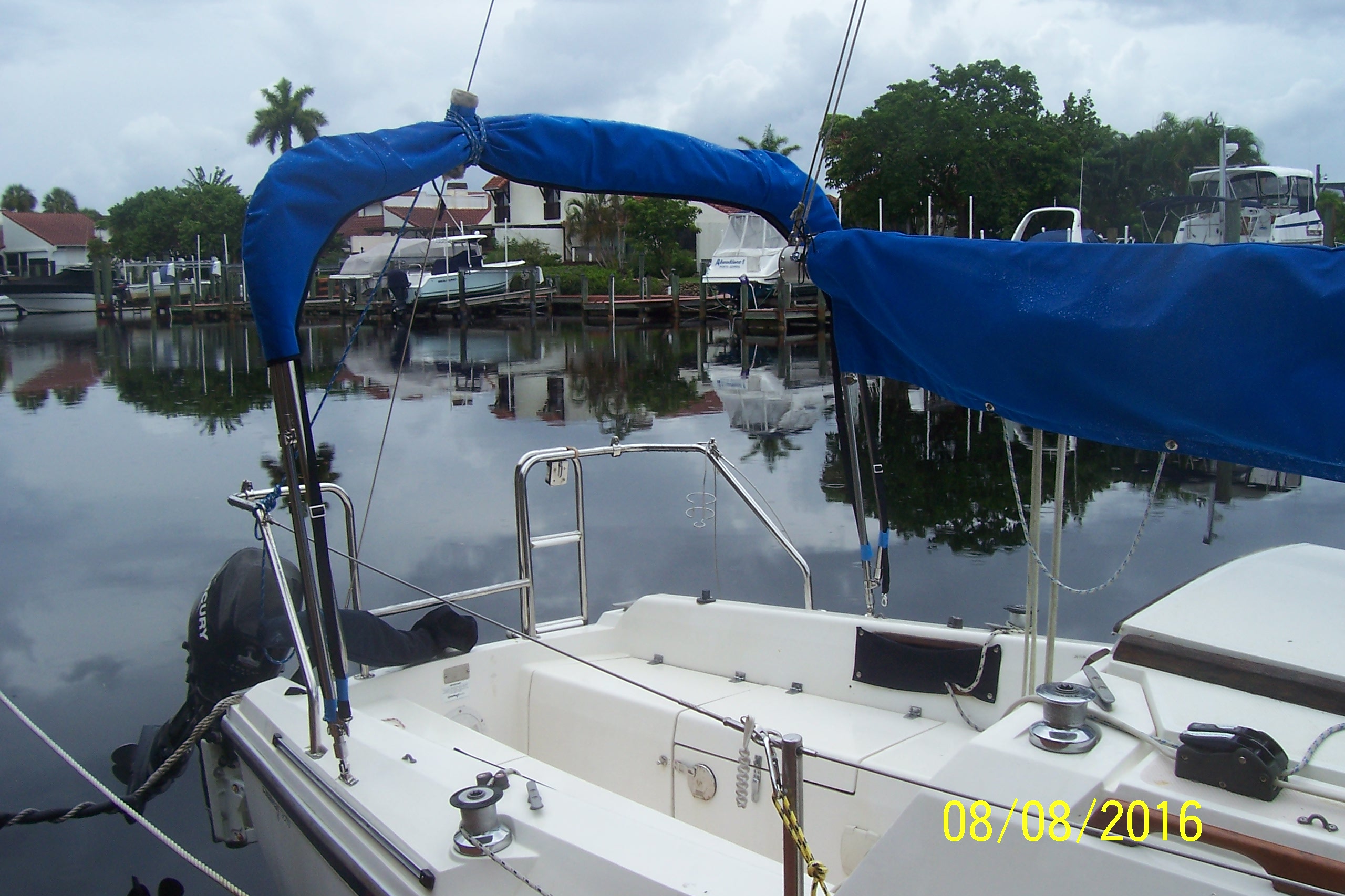

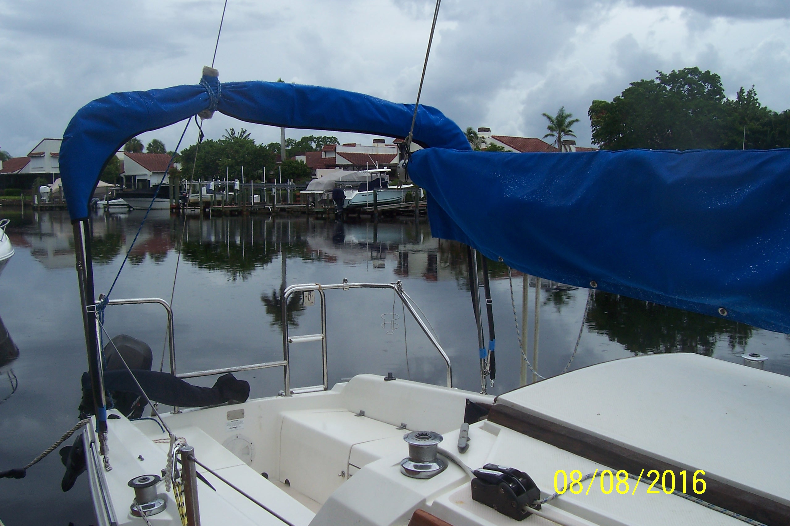

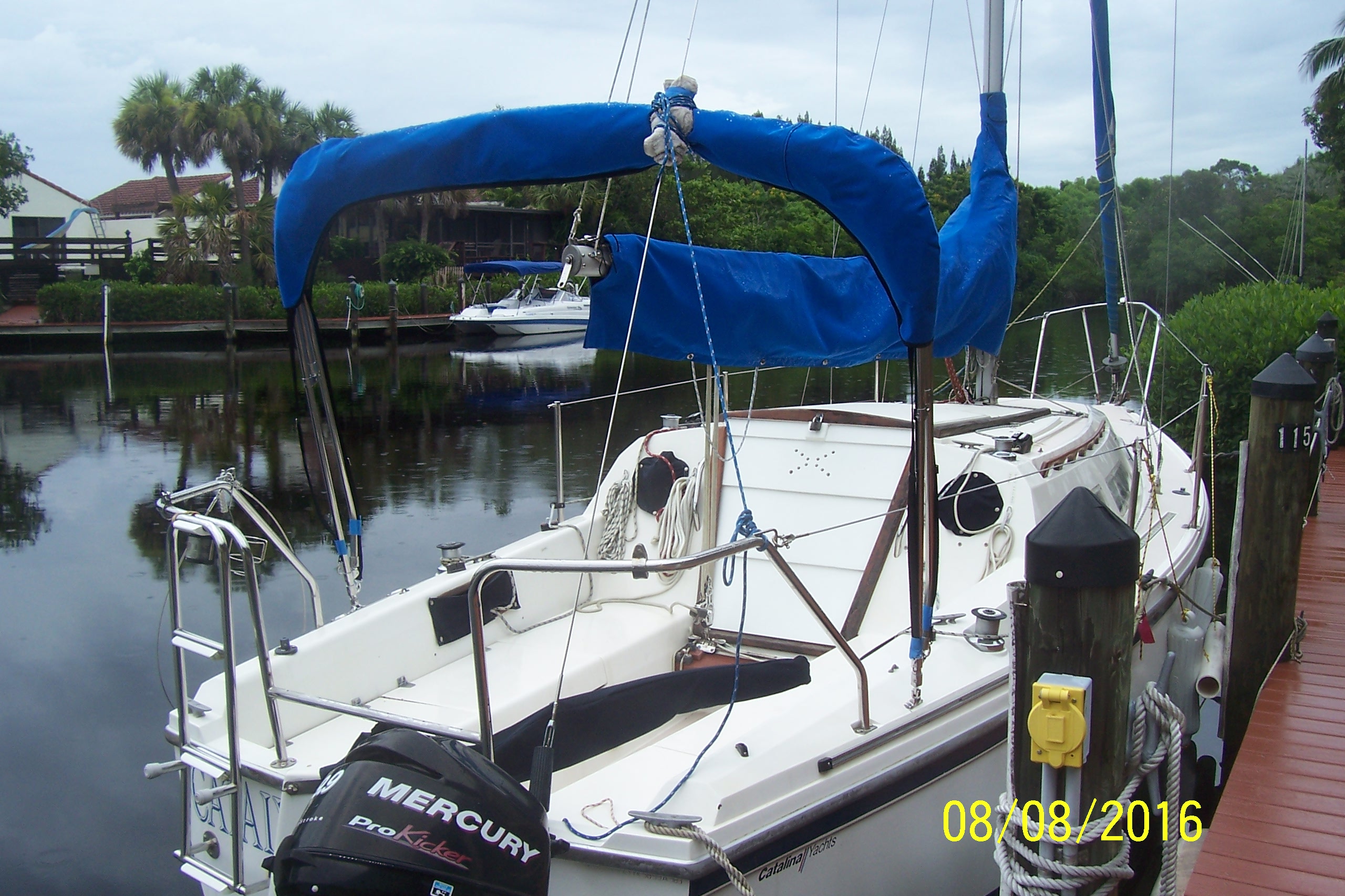

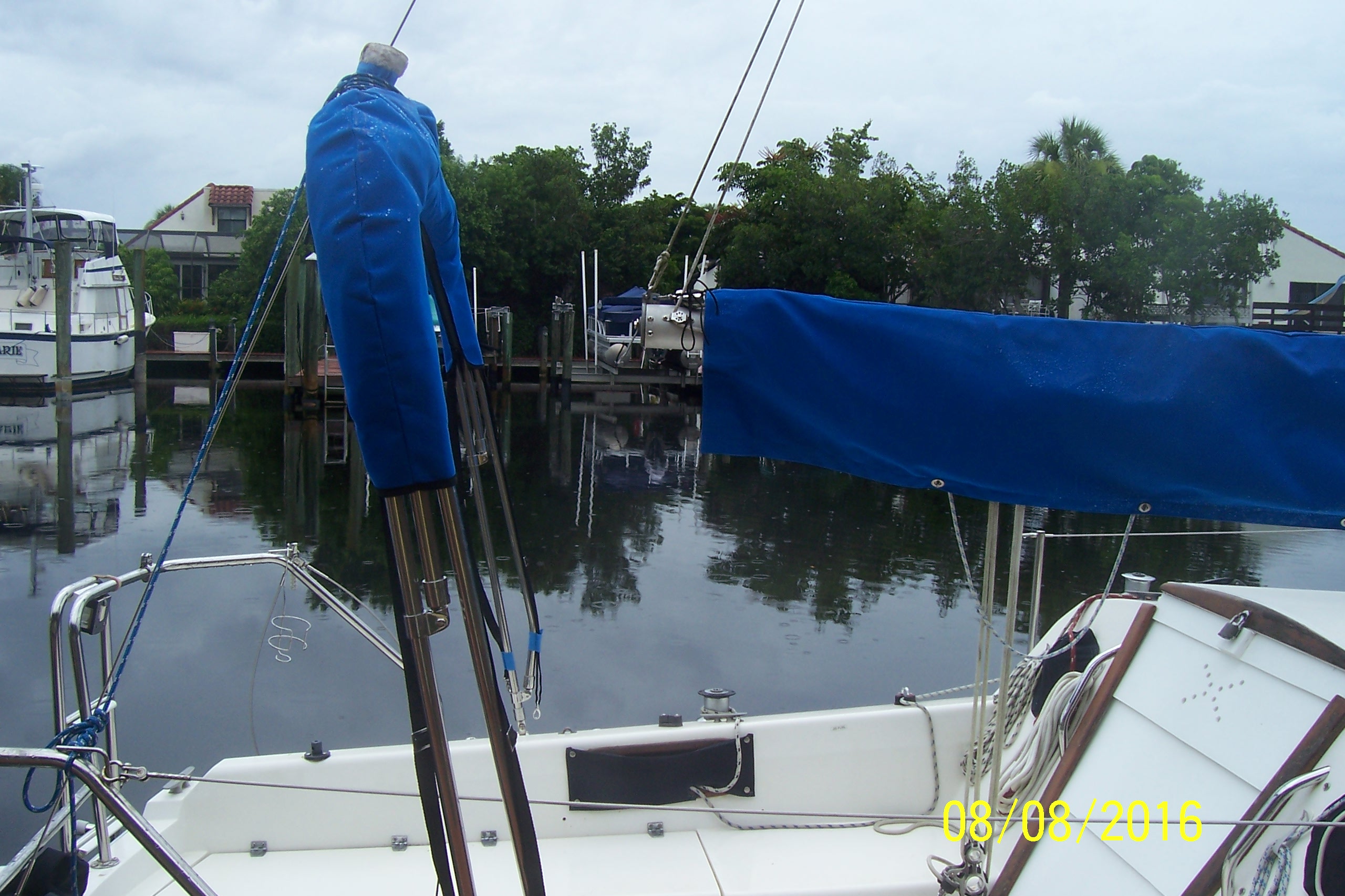

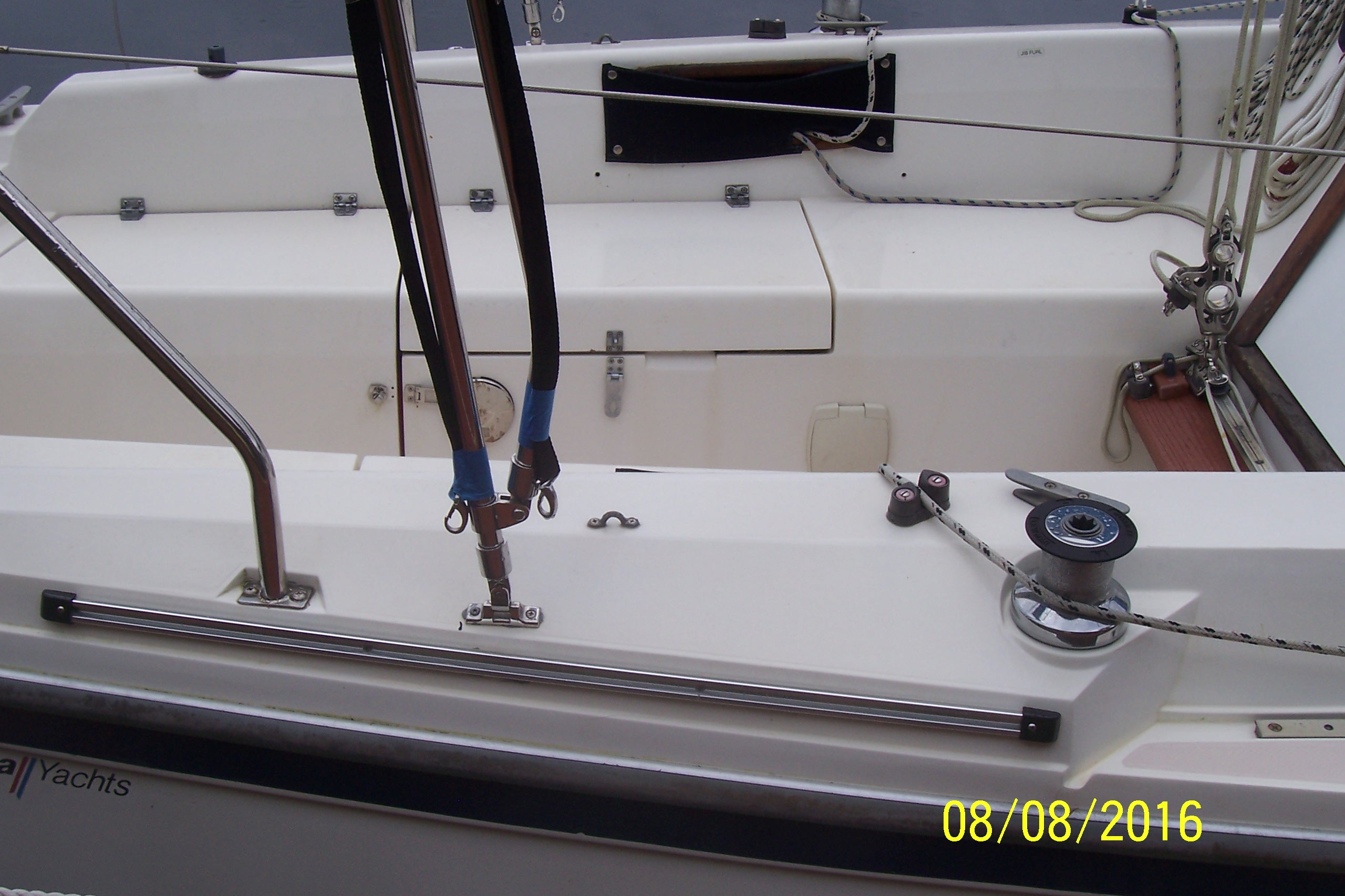

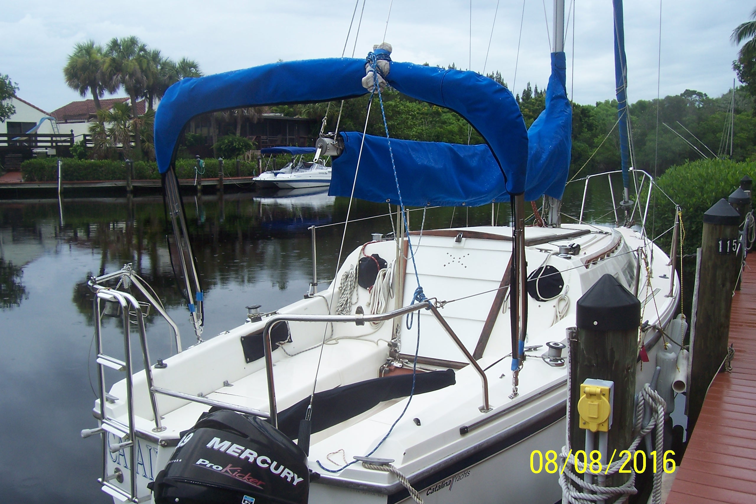

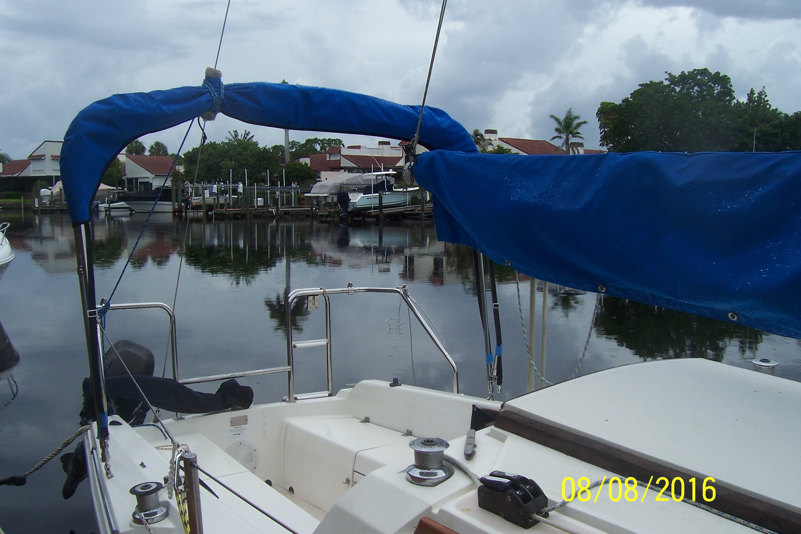

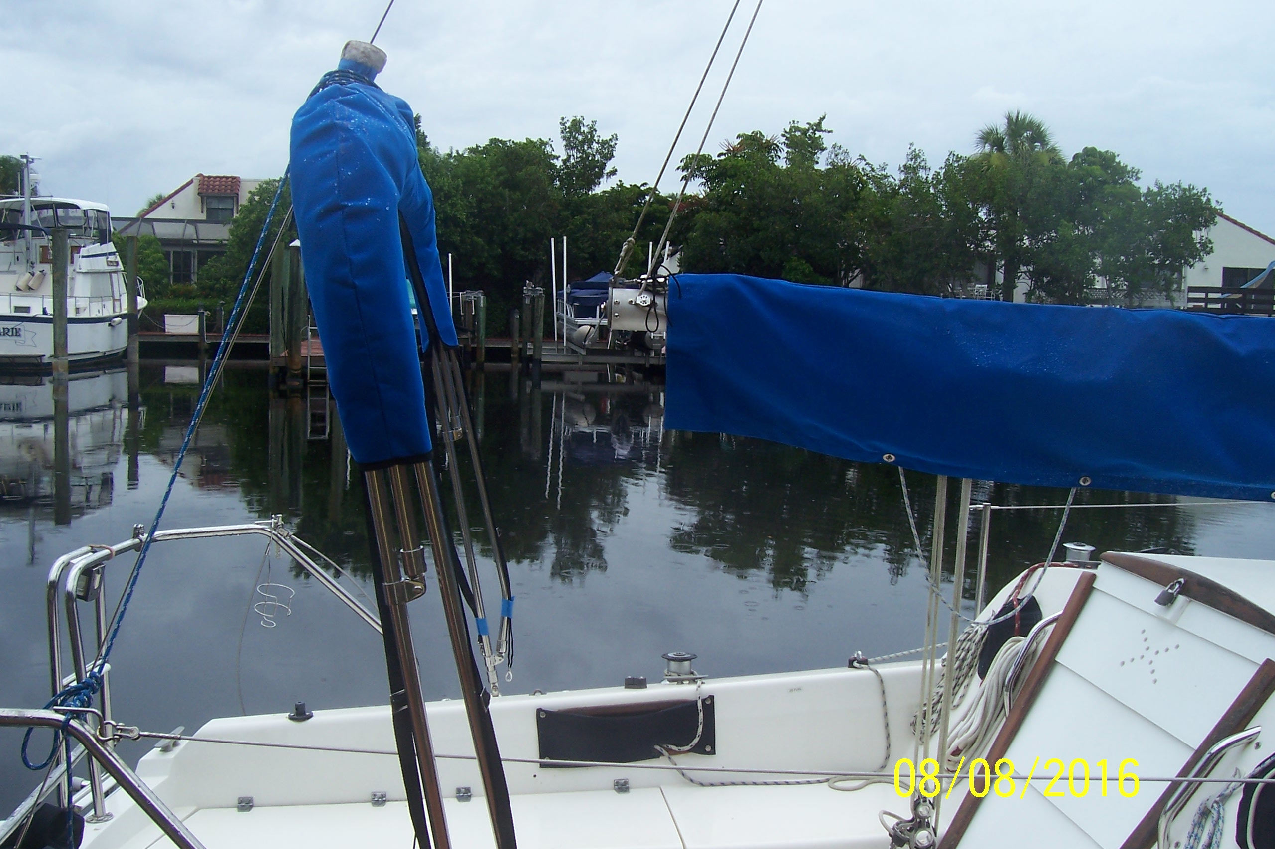

Some photos of the actual situation:
  • The mainsheet has been moved forward to the companionway and that limits where the forward end of the bimini can be. I plan to have a canvas person set up the bimini opening for the backstay.
  • The unit I ordered is 6' forward to aft and so covers a majority of the cockpit. The width worked out OK. The literature from CD said that the bimini height above the coaming would be 36". This would have worked. Obviously, from the attached photos the height is quite a bit more than 36".

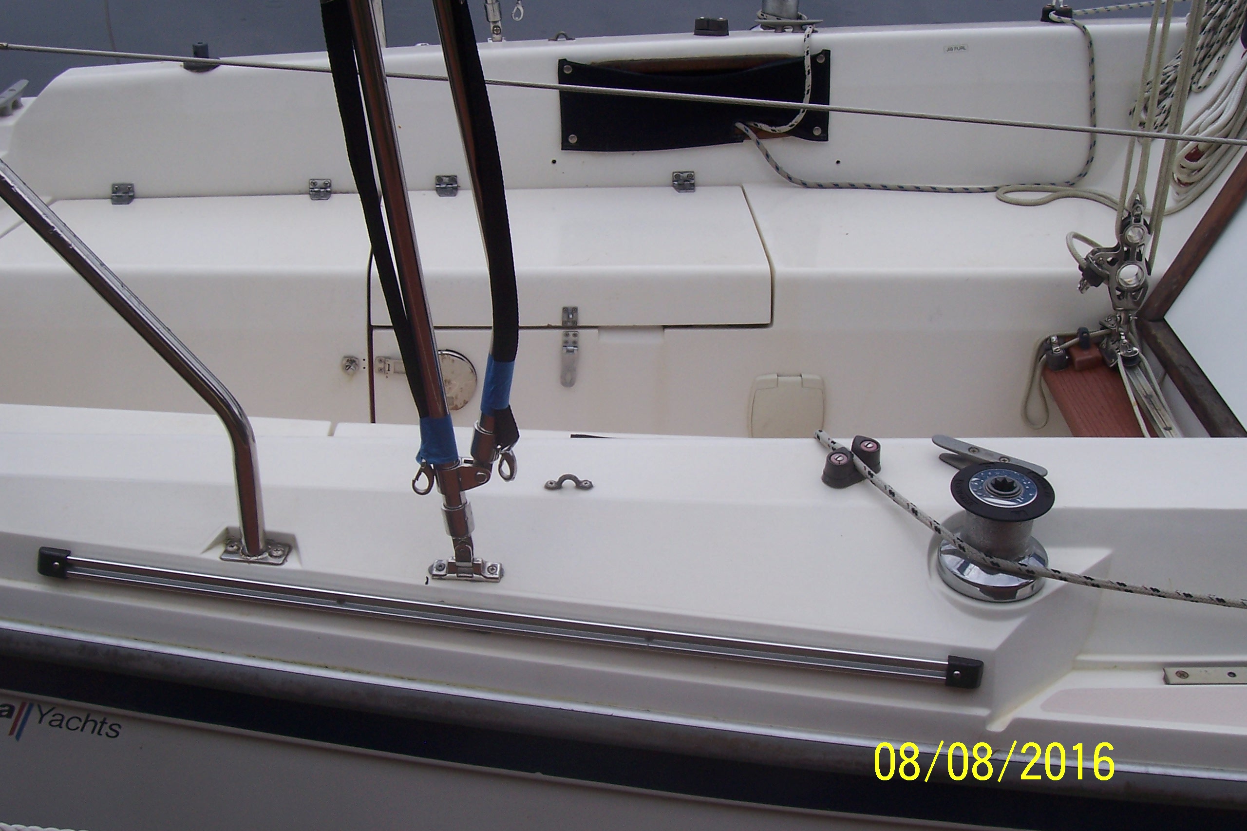

  • I wasn't too happy mounting tracks on the outside of the coaming because the mounting screws were attached only to unreinforced fiberglass. The brackets that were supplied with the unit mounted on the top of the reinforced area to provide a stable base.
I'm not sure of what the best way to handle this situation would be. Shortening the ss bimini supports seems like a big project if it can be done. Shortening the main 18" would make the sale area still greater than the standard rig.
HELP!!!

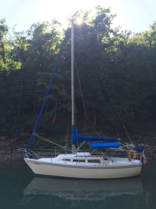

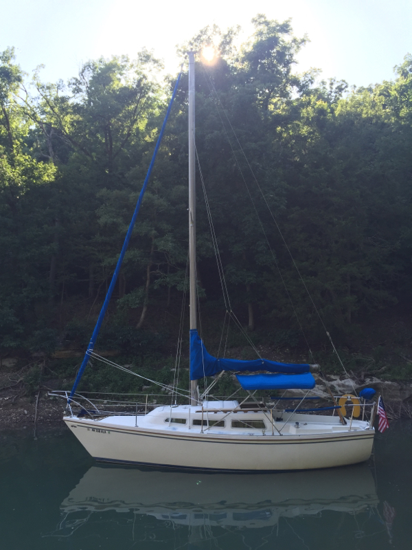

Here's a pic of the Bimini installation on my C-27. Bit sure if it came from CD or not, however one modification I have made is to fit a pair of their sliding mounting brackets that allow the Bimini feet to attach to the toerail. This works well and is far stronger than the previous deck-mounted fittings which pulled away. Reading this thread I may need to move it further backwards to get more of the cockpit in the shade. As-is it clears the boom well but think it's been cut down to do so.
