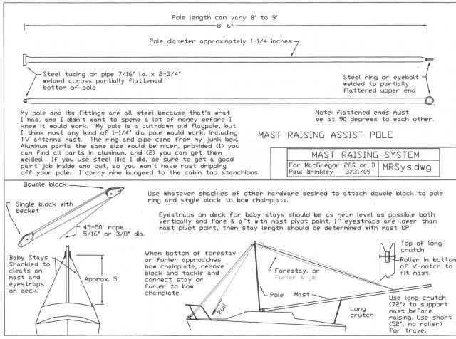

my previous boat was a Mac25 with a heavy 28ft mast... to keep the mast from lateral movement the mac system used baby stays... they attached to the mast like the shrouds, about 4 or 5 feet up from the bottom... they attach into the deck even with the tabernacle for the mast... as you raise the mast they are taunt, not tight like the shrouds when they are raised... on the mac system you do not undo them once the mast is raised, but I have been told on other boats you remove them... I have read where others have added these baby stays using rope or hard rubber bungies... also here is a picture if the mac25 mast raising system for you to see... with this system n place, raising and lowering your mast can be done all by yourself...

The problem with baby stays for lateral stabilization, is that the attachment point of the stay to the boat must be precisely in line with the pivot point of the mast. Otherwise, they will prematurely tighten or loosen. There are many systems that folks have rigged to accomplish this. The Precision 18 is reasonably close in design to a 19, and I know there are some discussions of this for the P18 if you google around.

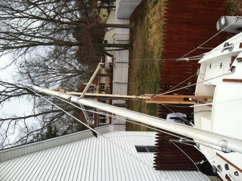

I attached a picture of a crutch I built for my 22. It allows the mast to sit approximately 9 feet above my transom. I then attach a boom vang to the mainsail halyard and bow chain plate. I place my shoulder on the mast as I reel in the halyard. My shoulder prevents lateral movement.
It works great for me.

The mast crutch supports the mast relatively high. It allows me to stand on the cabin stop behind the mast base. While in a squating position I place my shoulder on the mast. As I stand up Im pulling on the boom vang that has one end secured to the bow cleats and the other tied onto the mainsheet halyard.
Basically I use my shoulder rather than baby stays.
