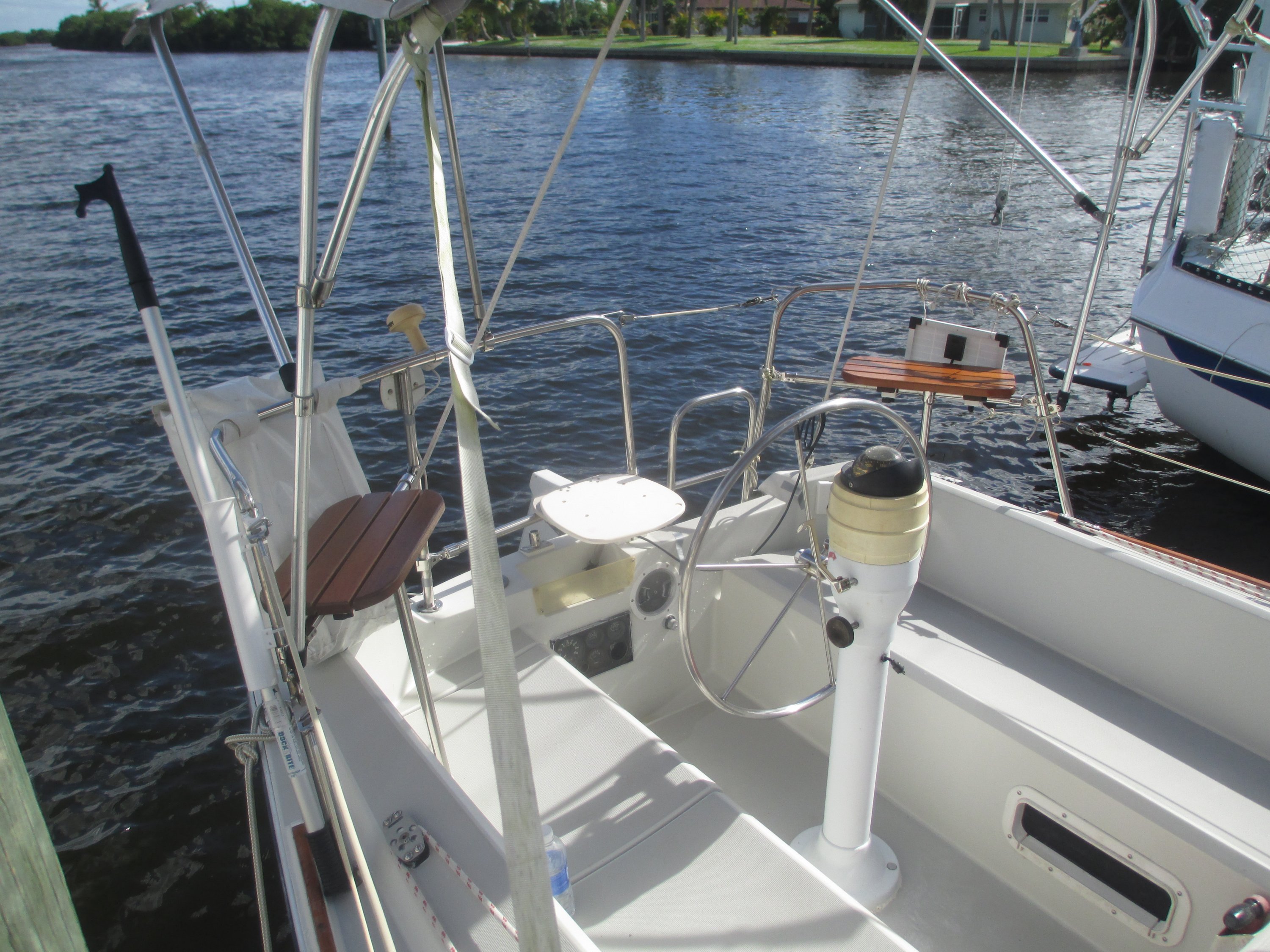

Personally, I do not like the large helm seats that are like armchairs. We often sit on an extra boat cushion for an added 2 inches of height. I did make a helm seat for one of our boats. On our Oday 272 the seat mounted on the lower rail of the stern rail bars. It attached using two of the rail clamps like hold things in place on the binnacle guard. For a third leg I cut a small piece of ss tubing and mounted it in an angled ss rail base. That leg did not need to go to the cockpit sole. It fit into a coaming shelf that is molded into the transom of the boat. The seat was made of starboard from a second hand shop and my wife made a foam pad and a cover for it. It was secure and pretty much out of the way because we could stand forward of it and aft of the wheel. It was not a work of art, but serviceable.

The picture of the 272 shows the helm seat and the stern rail seats which were all secured to the rail using the rail clamps under the seat. Easily removable when necessary. 31seahorse

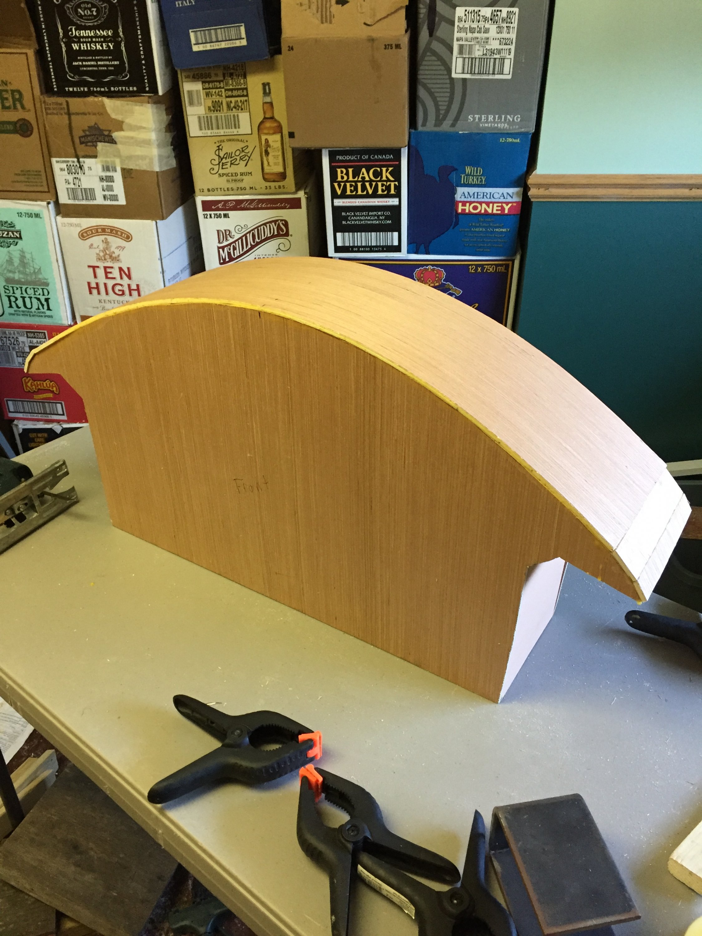

This is mine in fabrication. It is for a 272. It is made from 5mm ply which I will fiberglass. I will build a small storage compartment in the lower stalk part. My wife is already making me a nice pad for it.
Hey 31Seahorse... I really like that seat!
