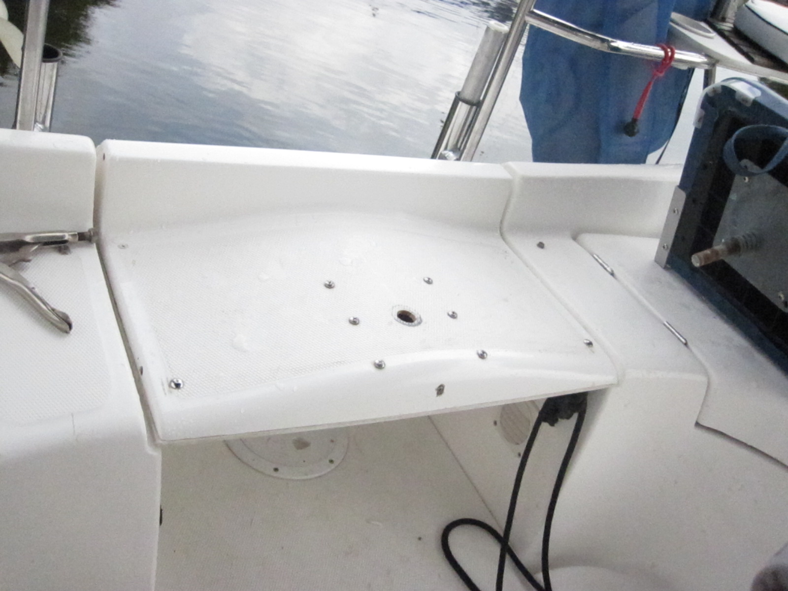

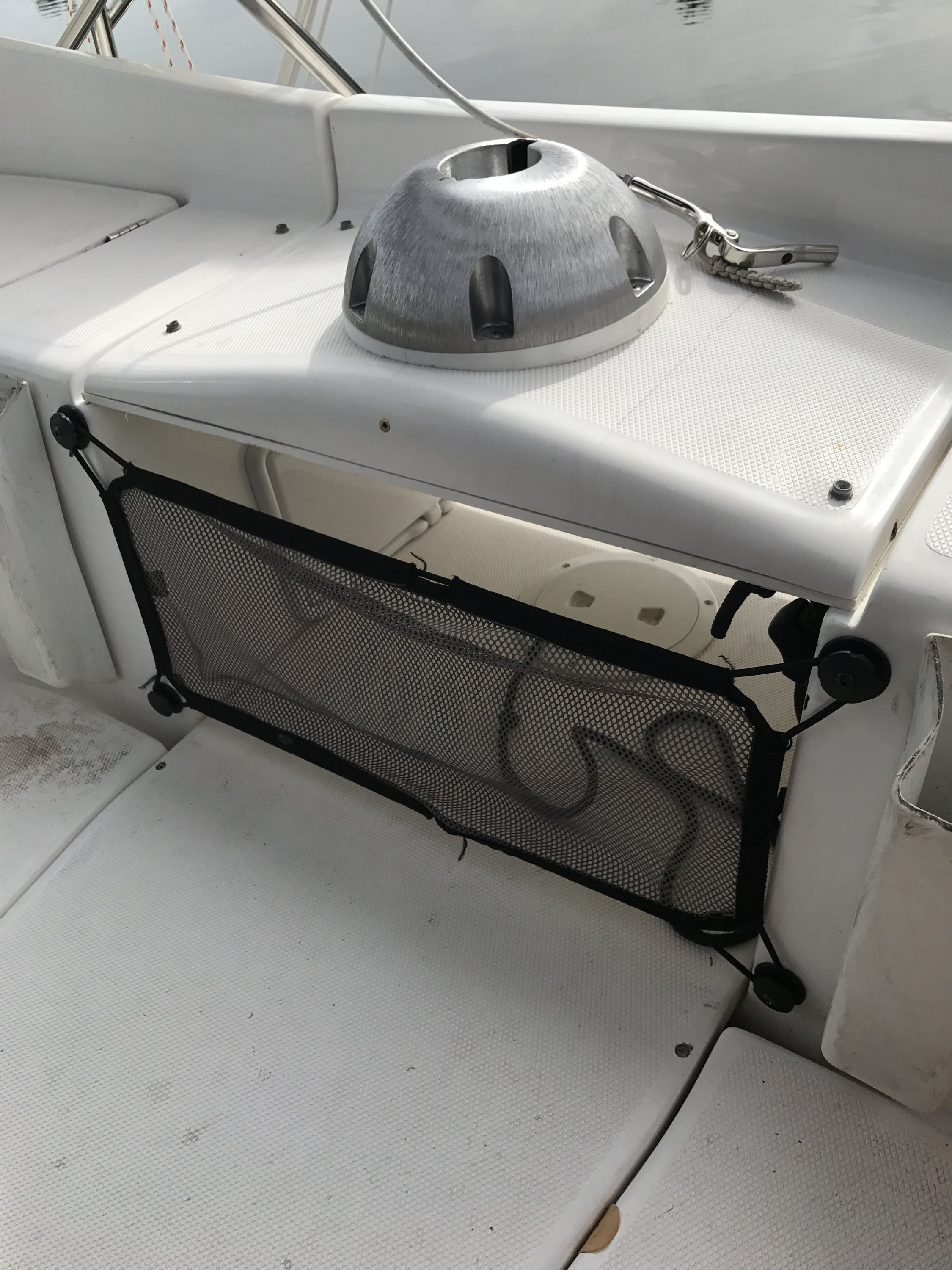

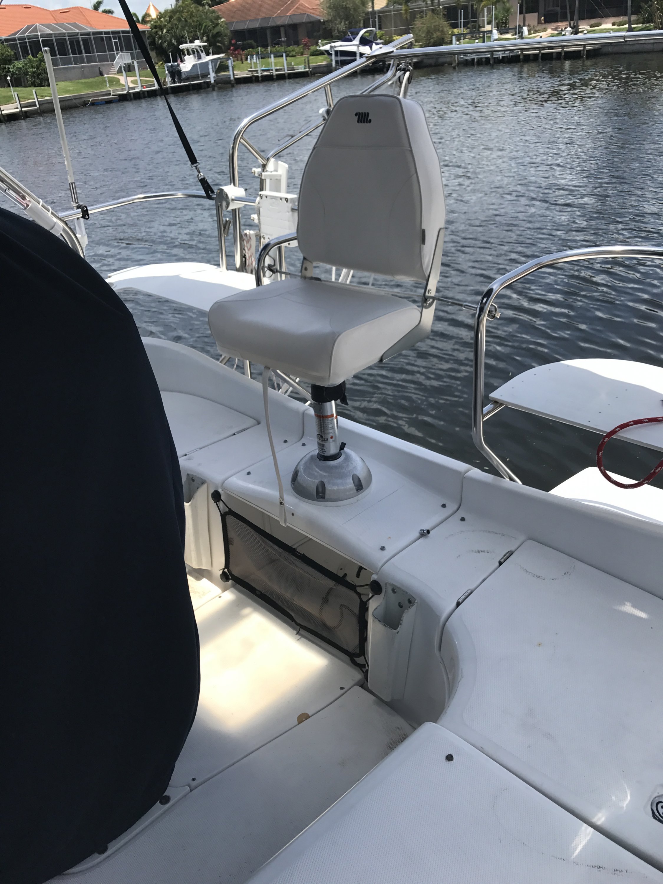

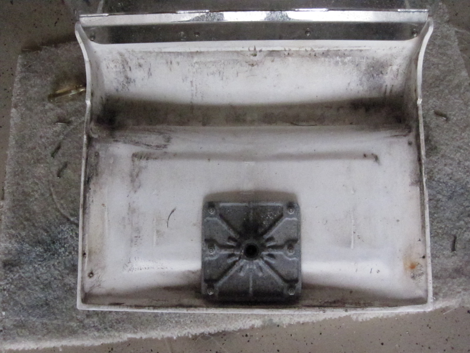

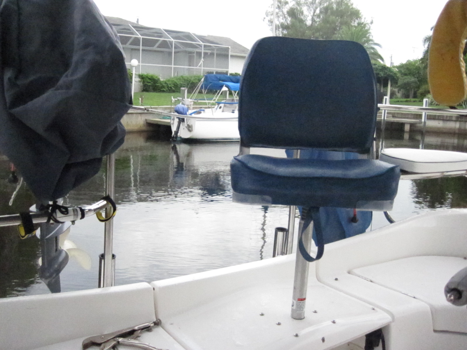

Here is one that I did. The seat bottom swings down and out of the way when accessing the swim platform! I did not want to cut a big hole in the fiberglass seat so I mounted the receiver on top of the seat.

Cobalt79, I have Hunter 36, and followed Seadaddler's example and installed a Springfield Standard Hi-Lo pedestal. Fairly easy installation, just make sure you measure carefully before cutting the hole for the pedestal. It makes even short sails much more comfortable. And being able to quickly remove the seat means access to the swim platform and stowing the pedestal and seat when not in use.
That is a nice set up would you mind letting me know where you store that beautiful seat when you are using the swim platform?

Seadaddler,
I'm interested in the mesh attached across the opening under the seat. Is it a purchased product or did you have it made?
Jun 23, 2013
271
Beneteau 373 Newport
Oops, sorry Seadaddler,
Just realized that the pictures showing what I am interested in were from Nodak7.
So, Nodak7, where did you get the mesh?

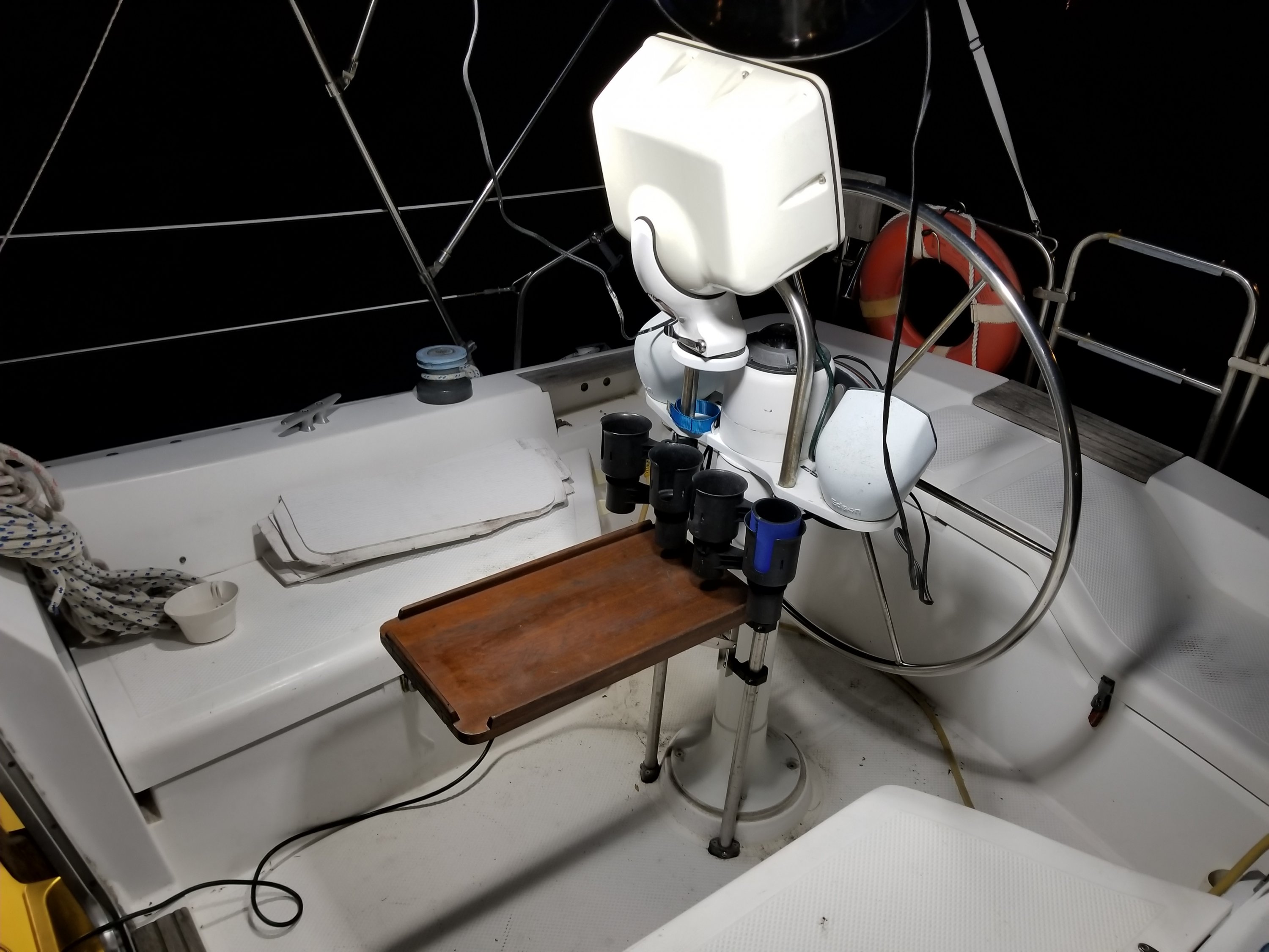

Not a Catalina owner but I saw this on a cat 30 for sale

Newport the mesh was from a auto store to keep a load secured. I do not recall which one though. Works great for keeping the dog in and "catching" stuff rolling around the cockpit.
Thanks, I'll check my local stores. I need it to keep the grandkids and their toys in.

I got all my parts at Walmart and a fancy chair would be nice but with the folding cheaper seat it is easy to stow and it does swing around for viewing 360.
my install wasn't that easy taking a part the swing down seat/step and think Nodak7 looks easy to bolt to top of seat.
I don't fine myself sitting back relaxing too much and fine I do like it for getting a break from standing long periods of time but do move around a lot while sailing.

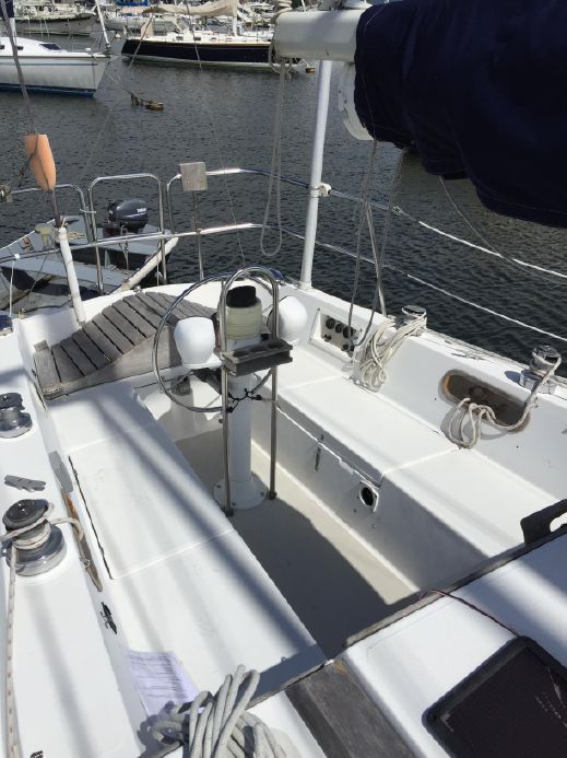

On the Hunter 31, they built that hump into the cockpit seating.
