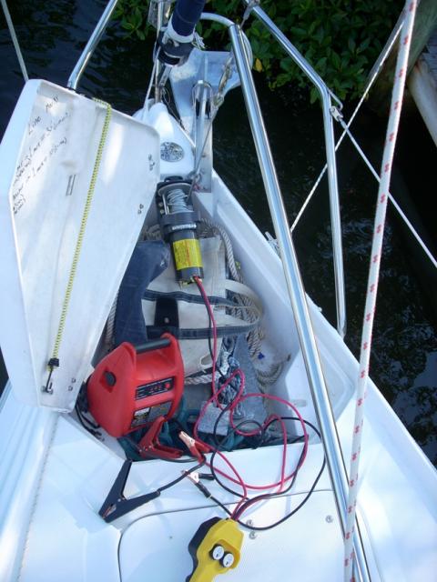

I had to replace my standing rigging and I had the rigger install Hyfield levers on the upper/lower shrouds at the same time. Pictures are under Boat Info/Owner Modifications/216/H216 Quick Shroud Setup - Install Hyfield Levers. Of couse, this is applicable to boats other than the H216. I am super pleased with the result. Along with my electric winch modification, I can raise the mast, attach the forestay, then install and tension the shrouds in a very small number of minutes...all done easily and safely.
This was well worth the money. With my winch and levers, I have now taken the hardest and most time consuming part of the boat setup/knockdown and made it simple, fast and easy.

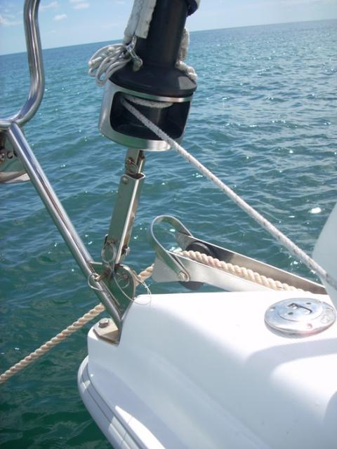

Been doing this on our H260 for years and it's the cats sass. 12v Harbor freight atv winch w/remote $50, jumpstart batt pack $30, Folding closure for the forestay from CSJohnson.com $40, shorten the forestay the length of the closure $20. Best money you'll spend and very impressive at the ramp. The winch is way over rated and has a built in brake to safely stop at any point. Always use common sense and be safe.

Michael, I'm curious - how does the folding closure on the forestay help? The winch is awesome!

I'll draw the mast upward with the winch until I can pin the open folding closure at the bow. While the winch still has part of the forestay tension I'll fold the closure into the closed position and put a safety pin in it. Caution is required as it's drawing the rig into it's properly tensioned range. Always put tension on the forestay with the winch before releasing/opening the closure to lower the mast. You'll only miss this step once.

I don't know about a 216 but my 260 needs a tremendous amount of tension to create that added slack required to insert a simple forestay pin. The rig tension is set perfectly to spec and even with the winch bearing on it I still need the slack from the open lever. It's a welcome addition.
