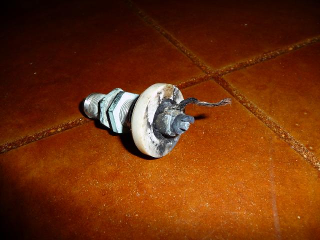

10,253
Dead VHF
Attached is what the Shakespeare antenna looked like after my hit. Only the base left. Fried the radio and blew the bulb in a nav light and in the reverse polarity indicator on the panel.. I was lucky.
Oct 13, 2006
75
Hunter 30_88-94 Port St. Lucie, FL
Interesting progression. My radio died; fuse or power; lesson in Ohm's Law; must be lightning.
A lesson in Ohm's law would explain a blown fuse or a bad switch. But a radio that will not power up on any power source and a bad panel switch in the same circuit would make me suspect an outside force acted on the damaged components in the circuit. Lightning being the prime suspect to be investigated before the finals in the new radio are burned up transmitting into a dead short of an possibly damaged antenna.
