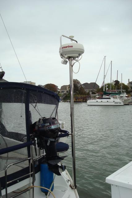

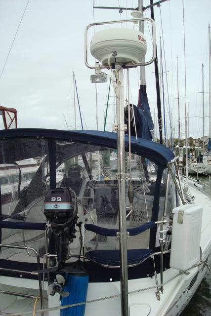

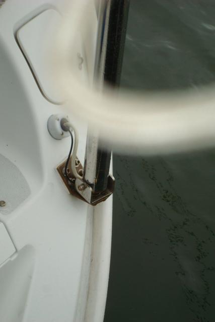

I made my own radar tower a couple of years ago and used the Garhauer tower as my model. Like Ed said, the bottom bracket mounts to the transom. I actually bought my support struts from Garhauer and the thing is rock solid. Unless you have major obstacles in the way and can't do a bolt on application, I'd stay away from going through the fiberglass deck.
Look at the link (Radar Tower Accessories) and you'll see the mounting struts you can use.

The Garhauer pole is great and should work fine-but use the transom mount instead of going thru the deck. We've got their pole on our 356 with the optional engine hoist and it works really well, very well designed and sturdy. The engine hoist is removable if you want to stow it.

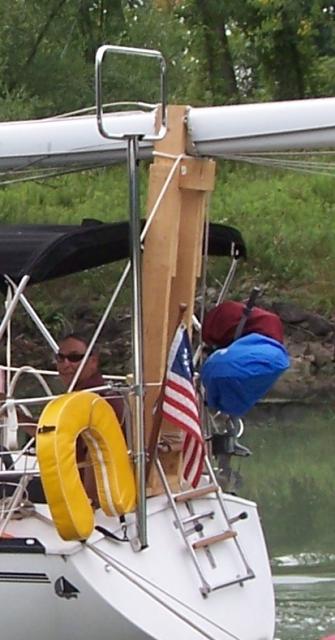

Jun 2, 2004
5,802
Only stern picture that I could find. You really cannot see the rail support very well. Nor the fact that you could add a second one to the lower pushpit rail. Pic is in the Erie Canal on the way to FL with Mike A. at the helm.
