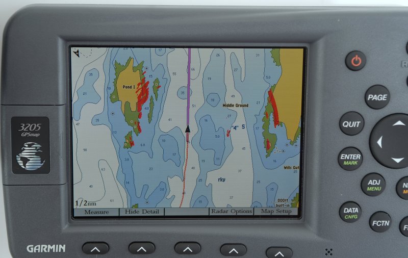

Not necessary..
It's not necessary but it's certainly a good idea. We sailed for years and years without either radar or GPS/Loran and we did it in the fog quite often. It's nearly impossible to avoid fog up here and in the old days you just dealt with it and used your skills, you know, the ones most no longer know or practice these days..;)
We do sail a lot more in the fog than we used to before instruments, and it's to the point where it does not even phase us, and the advent of plotters and good small boat radar systems makes it more comfortable.
As for running aground you'd better get that squared away before you head North. In this day and age of cheap plotters there is very little excuse for running aground. They draw little power and can be mounted at the helm so you can check them often.. If you run aground up here it will usually end your trip!:D
P.S. Radar overlay is one of my favorite features of the new plotter/radar displays!!
If you hit rocks using one of these you might be a good candidate for a Darwin award..;);)
