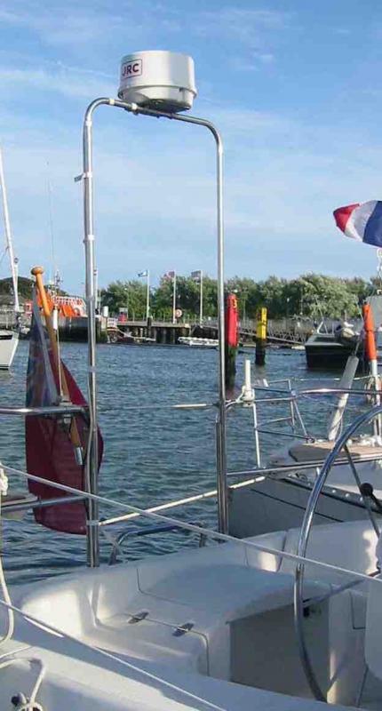

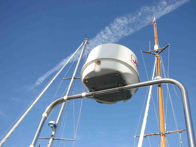

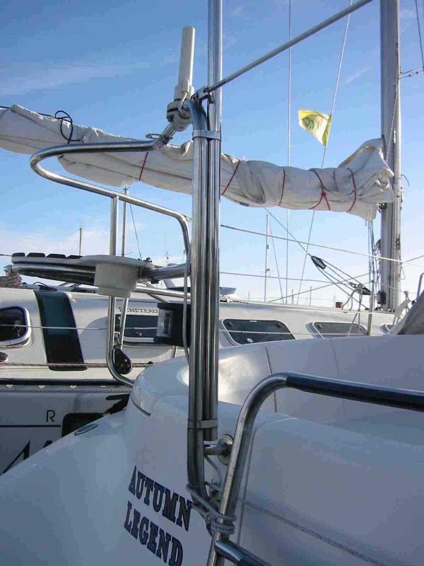

My approach to the same problem.
This was my approach.
Just a simple 11' length of 1" diameter SS tube and 4 jubilee clips - plus a friendly metal worker capable of making a 6" radius 90° bend.
Yes it is not too wobbly and over the years it has withstood some pretty ferocious weather.
And yes, before you all ask, is it strong enough? Well, coincidentally it was subjected to the ultimate test last year. Autumn Legend lives on a mooring between piles on the strongly tidal Hamble River. A passing??? sailing school yacht managed to lay its boom against the radar 'U' arch shape whilst travelling toward my bow. This resulted in his mainsheet hooking over my radar arch which then brought his yacht up all standing about from six knots. My arch was bent over the cockpit at nearly at 90° - yet the sides of my pushpit withstood this excess loading.
i.e. In extremis the 1" tube of the arch is strong enough to support the small radar yet not so stiff as to allow the pushpit to get damaged - fortuitously!
Some .jpg pictures and a .pdf drawing for your amusement - your width across the pushpit uprights may be different, otherwise much else will be same.
