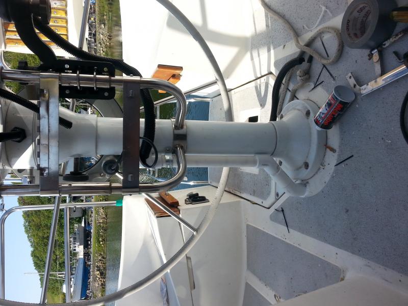

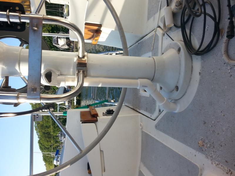

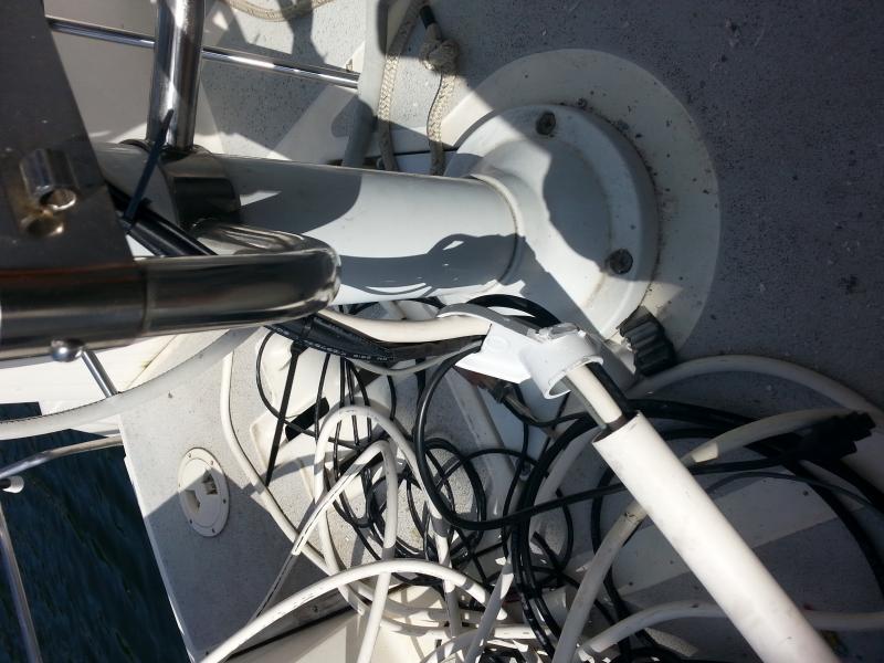

I had the exact same issue, and decided that I didn't even want to think about running cables through my pedestal. With my solution, the wires were routed directly into the lazarette.
Now I have a Hunter 33.5, but this may give you some ideas.
Attached is my solution to this problem:
1" PVC, two 45 degree couplers, and a service cap to keep out water. The cap was painted white using white epoxy paint (was grey). A mistake I made was thinking that I could route all those wires with the PVC tubing together. Not even close! I had to route the wires through each section of the PVC tubing apart. In addition, they became tighter as I stuffed them all in there. To ease the running of the wires, I used SailKote as a lubricant.
What is not shown is the final 4" PVC that went through the deck. Later, I sealed it up with 5200.
Sorry for the side-ways images... Tilt your head [grin].
I hope this helps!
