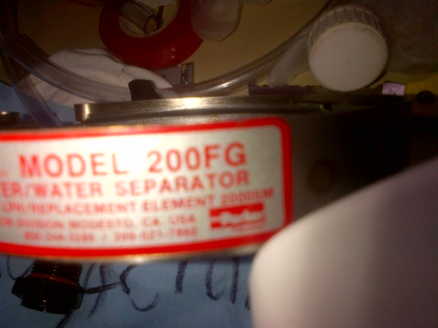

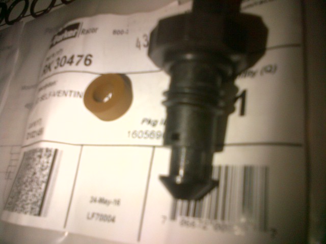

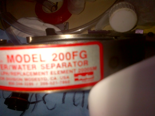

For 4 years the self venting drain value at the bottom of the Racor 200 FG was constantly damp with fuel even after I tightened it - as tight as I dare. Air in the Racor has been an increasing issue and became a major one at the end of last summer. In May, I replaced the old copper fuel lines and today I am going to install a new drain value. See pic

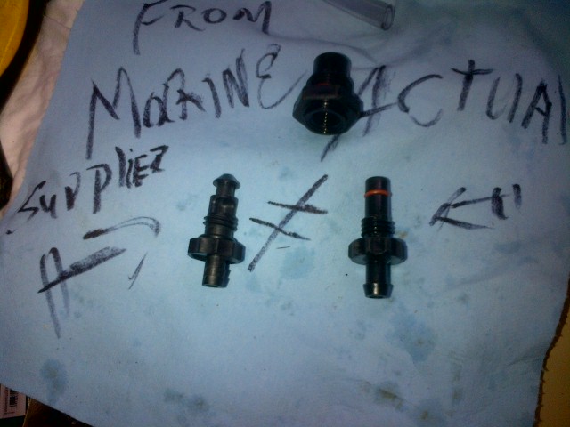

To my surprise the drain value arrived last Friday with no O-ring so I swung buy a few parts shops and pick up a variety of rings that appear to fit on the new drain. See pics of those rings on the new value and the selection in another photo.

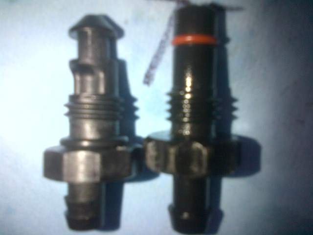

Wrong Part arrived. I gave the supplier the Racor part number (11780) and I noticed the difference (30476) but figured it was a updated product.
There are some serious differences like one is right-hand tightening the other is left-hand tightening.
Best I can do for now is to visit a few diesel shops and see if I can replace the 2 O Rings on the drain that is constantly damp with fuel. One is visible in the photo and the other is on the piece in between the 2 drains.

Got a dry plug. Applied Harvey TFE Pipe Paste on threads and did a very big tight install. 3 days later and no detectable dampness.
