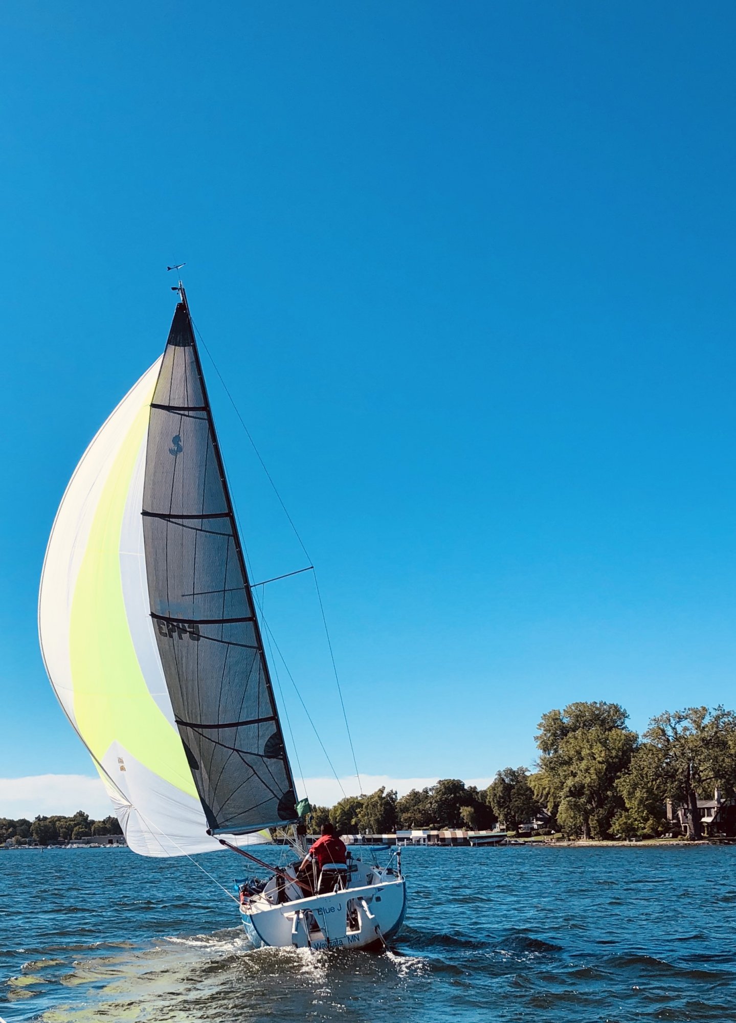

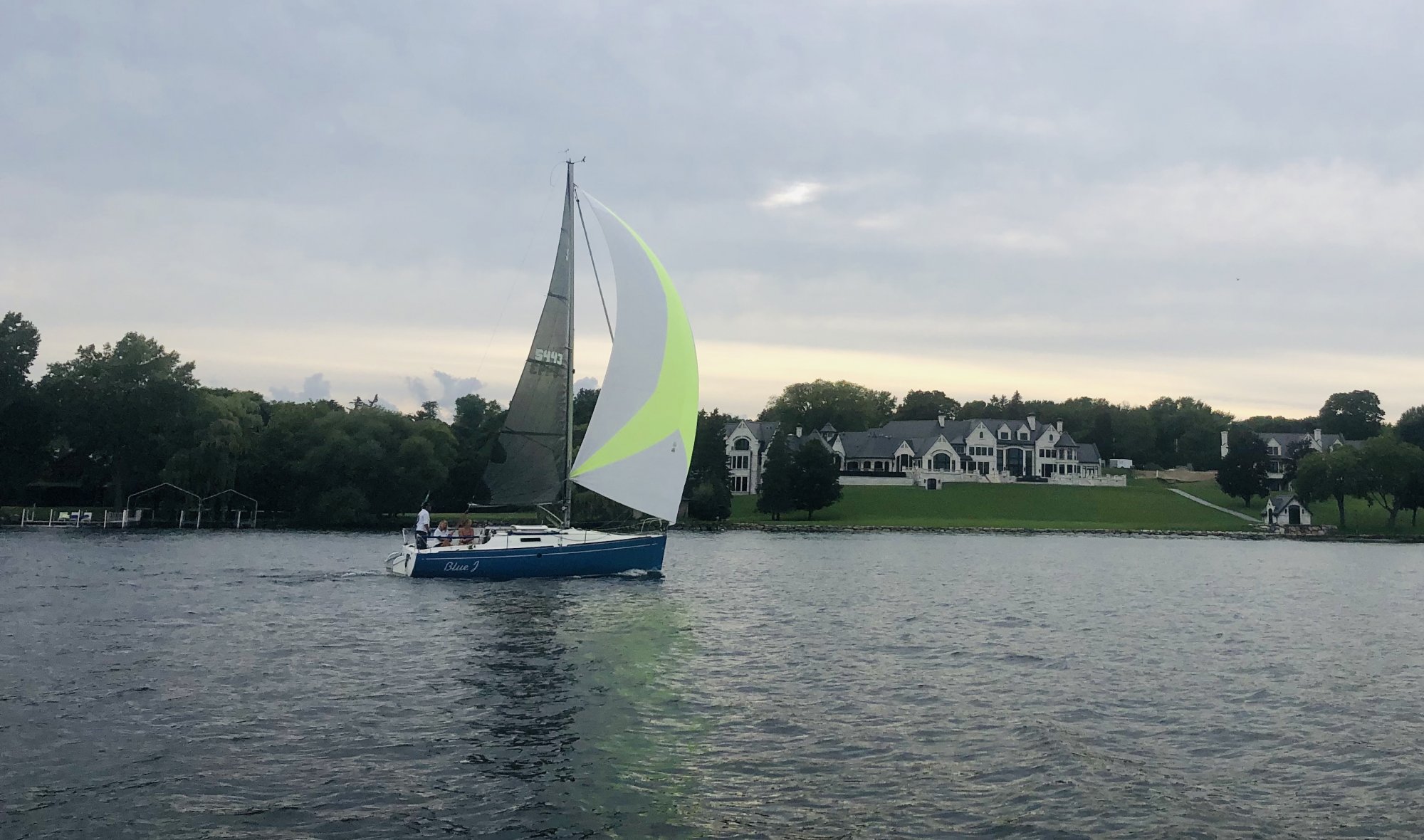

Last Saturday our club held its around-the-island race, with starts for each fleet. This year we introduced a short-handed (1 or 2) fleet so more boat can get out with less crew mixing. I was going to solo-sail BlueJ in that fleet, but missed the memo that said only Sunday, Monday and Thursday racing would have a short handed start. So my choices were go home, go cruise, or go big. The first half of the race was light and shifty (not fun while short handed) but at the top the of the island the breeze broke into the teens and it was a BlueJ day all the way home.
Pop the kite for the middle 1/3 of the race, 3 jibes down the channel!
The a blistering beat home to the line!

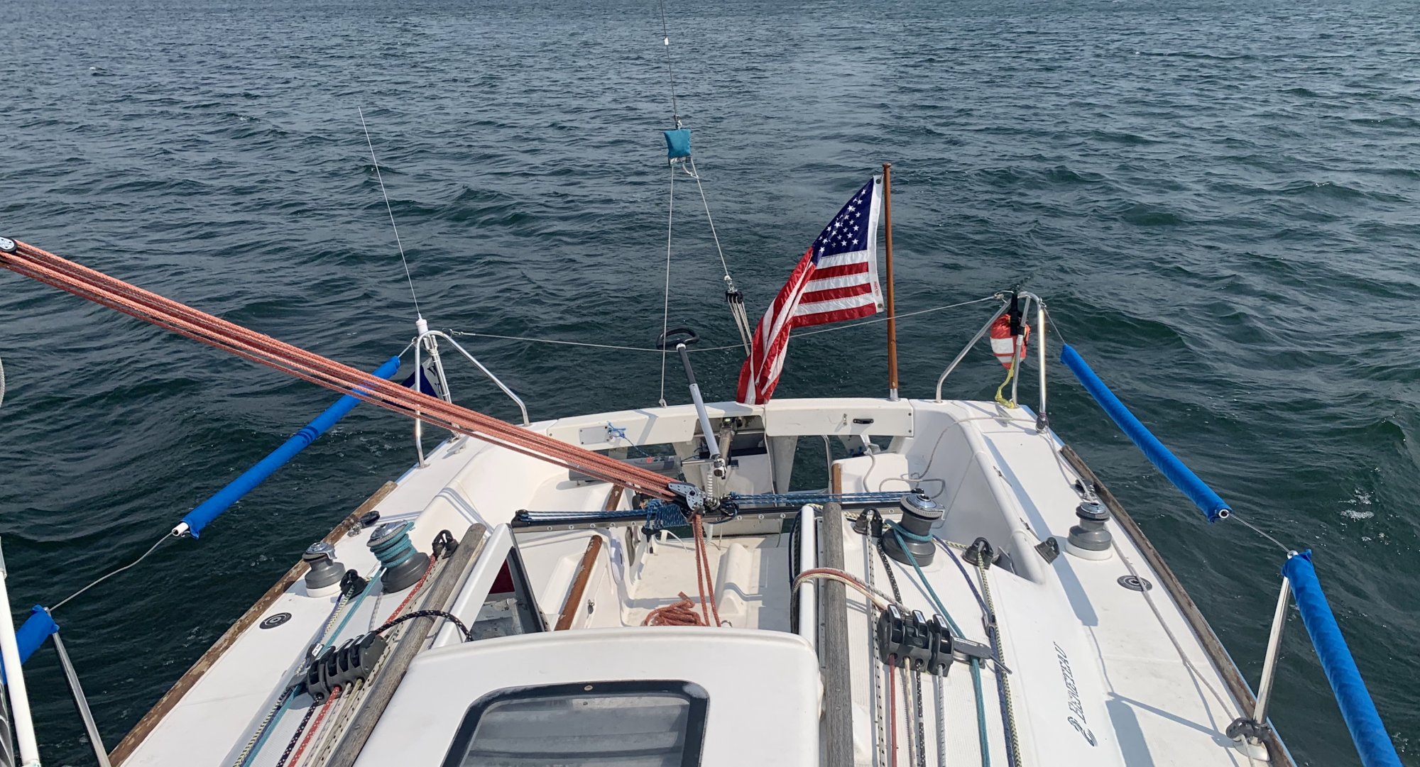

In the picture below, you can see the ST2000 AP, but also the TillerClutch and line. The TillerClutch is absolutely key if you have a tillerboat; its like a wheel lock on a wheel. Flick on and flick off. The Davis Tiller Tamer is not in the same league. If you have and can use a AP, get the remote if one is available. The Raymarine one (S100) is OK, but nowhere as good as the NKE one for sailing. The NKE one will also turn the boat head to wind if you MOB, a potentially lifesaving feature.
Just in front of the tiller is the mainsheet and traveler. Placed here allows trimming while driving from either rail, and also easy jibing by throwing the mainsheet over while steering with you knees.
The winches on the side decks are for 1) spin sheets, and 2) jib sheets when cross trimming the headsail. Having them here again allows you to drive while trimming and maneuvering.
At the companionway are the jib sheets (when not cross trimmed) and ALL the control lines and halyards. ALL. Unless there is an issue, I never have to leave the cockpit to do any maneuver. Most I can do from behind the traveler. If I do have to come forward of the traveler, I can either 1) take the tiller with me with the extension 2) lock it momentarily with the TillerClutch. Per the playbook, no action north of the traveler takes more than 15 seconds. If a control line does not come back to here, or a trim control (like jib cars) do not have a control line, run them. BlueJ has like 20 lines that come back, but then I never need to go forward.

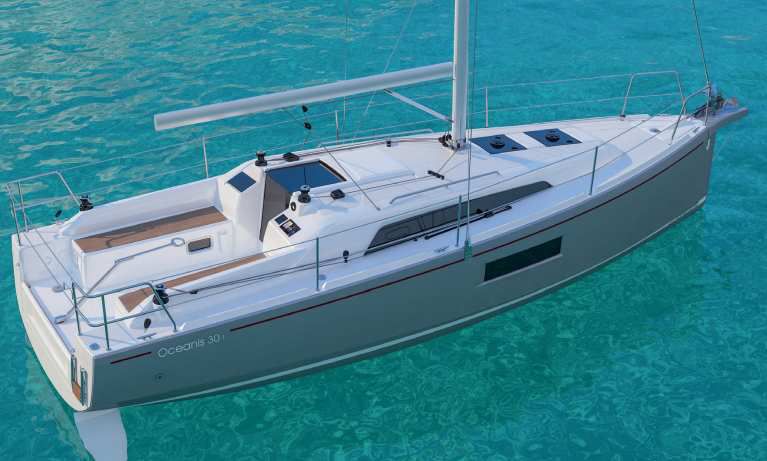

A potential breath of fresh air, the new Oceanis 30.1 is available with either dual wheels or a tiller. I'm very interested to see how many go out like this here vs Europe, where I'm sure 90% will be tillers. Designed by Finot/Conq, its really a big BlueJ
