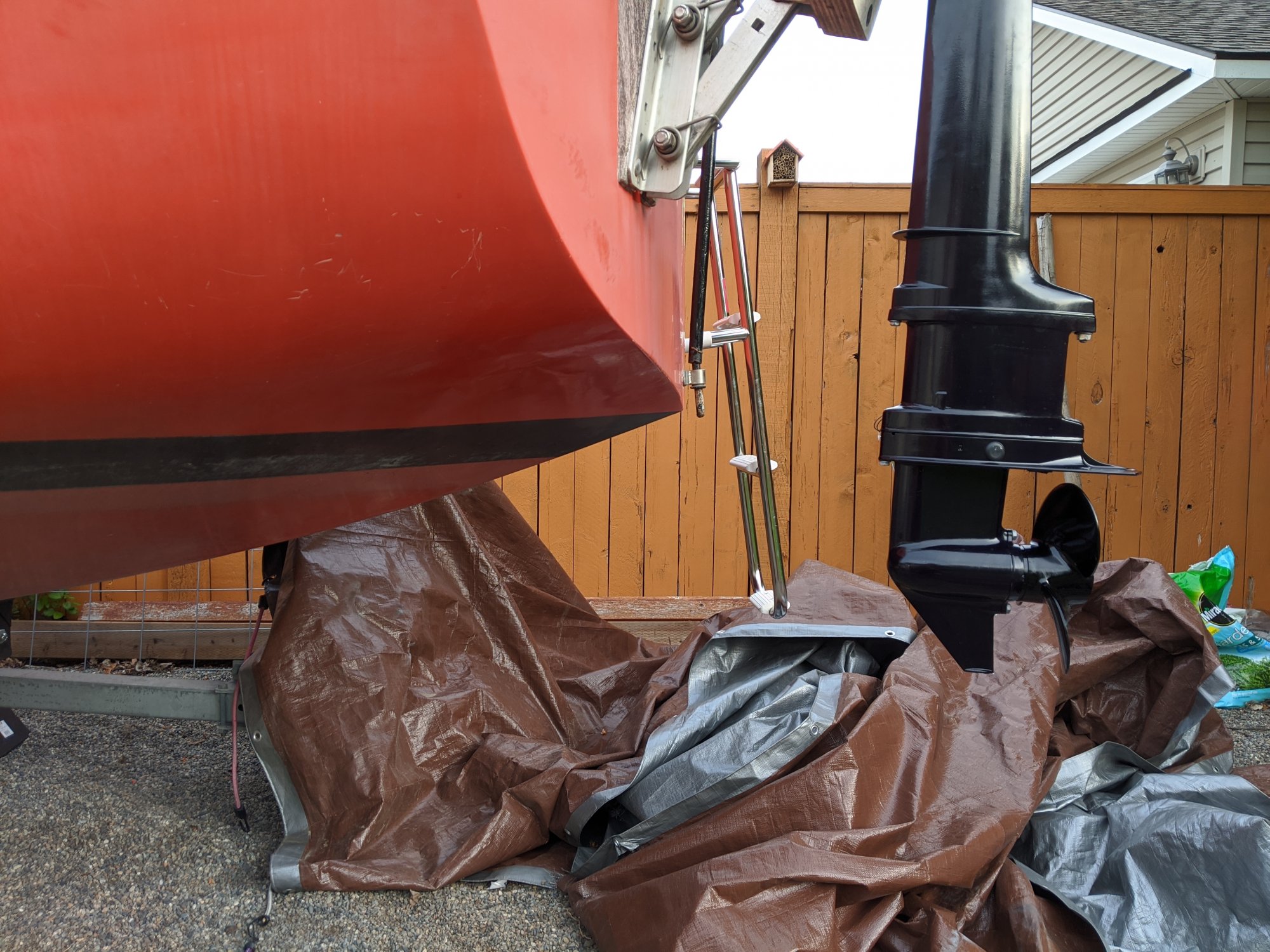

I just bought a new Tohatsu 6hp SailPro XL (25") shaft. I'm pumped about it. Before I bought it I measured, measured again, eyeballed, and tried to look for info online to figure out the correct length for the shaft and depth for the prop. I got it home today and put it on the boat and it looks and feels too long. See pictures. In the "closer" picture the motor mount is raised, in the "further" picture the motor is dropped. They are terrible photos, sorry. Any advice on proper outboard length and prop depth would be appreciated!

It does look like a 20 inch shaft would work for you. It's more work, but you might like the benefits of raising the mount. You could do it by rebolting the motor mounted higher on the transom, but also by replacing the mounting pad with a taller one. I can't tell if you could simply mount the motor directly to the transom.
You don't show what it looks like in the raised position, would you be able to tilt the motor with the stern rail there? Would raising the mount make that easier or harder?
I am not a motor guy, so I can't give you the best advice, but it looks to me like the difference between the 20" shaft and your 25" shaft is the 5" extension added just at the cavitation plate. It may just be a matter of removing that extension, to turn your 25" into a 20" shaft.

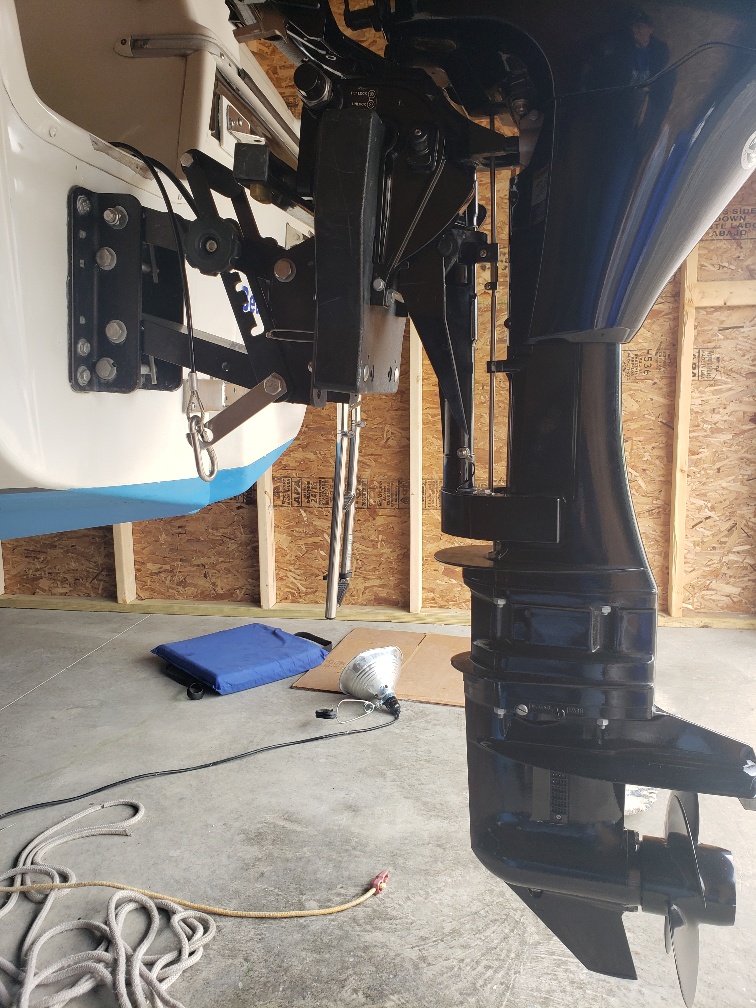

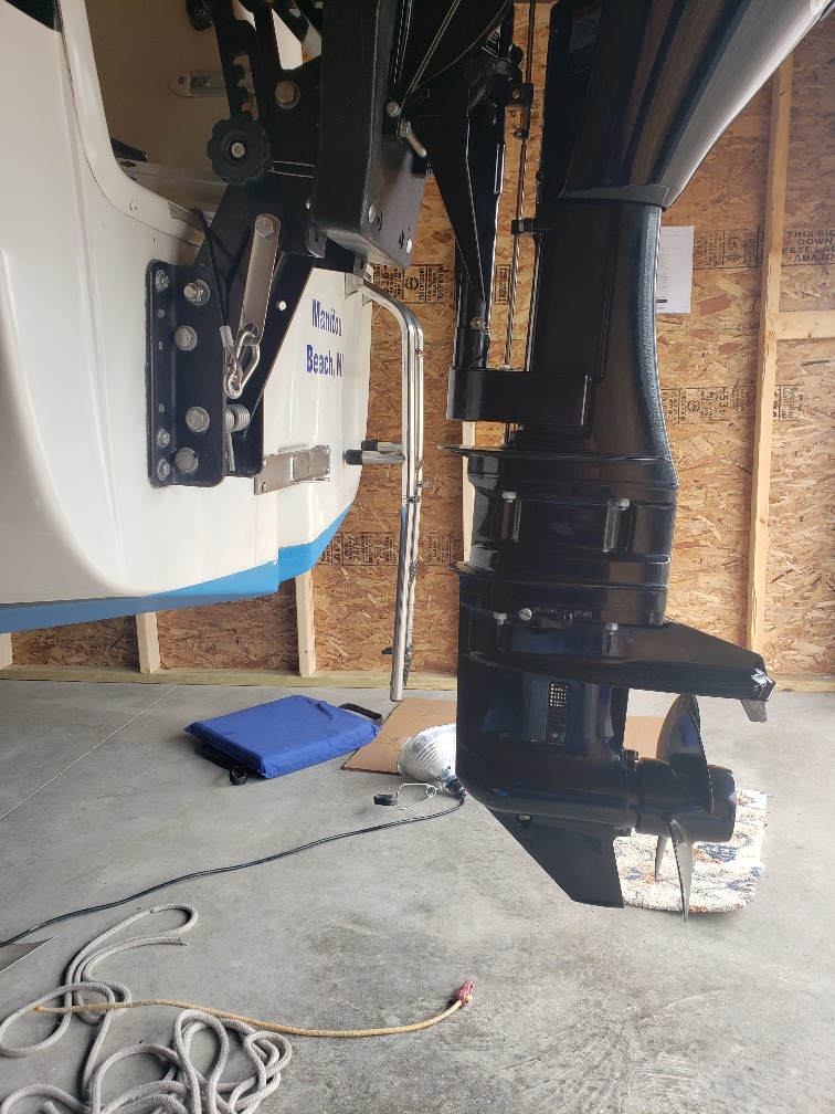

Here are a couple of pics of my 9.9 on my Mac26C. I slip on a small inland lake and rarely lower the mount. We go to either Lake Huron or Michigan a couple times each summer. I need every inch of depth to keep the prop in the water when it gets rough. When we are sailing, we tilt the prop out of the water so there is no drag.
