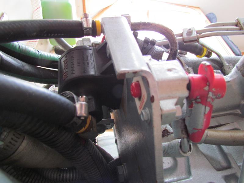

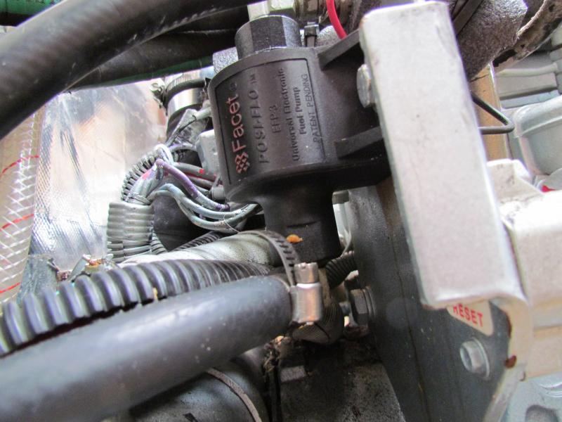

hmmmm, I might have to stop by NAPA and see what they have.This is the pump I installed 4 years ago.....works fine.
I think it was $30 a Napa.

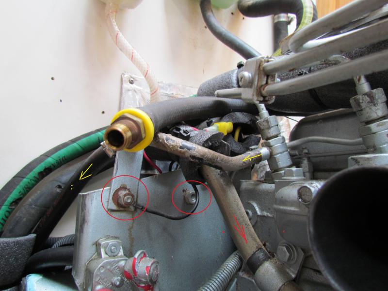

Yup, just installed the facet pump from napa and it was a direct fit.Model won't matter. Get an electric pump from NAPA or I replaced mine with one from a Kubota dealer for $50.
