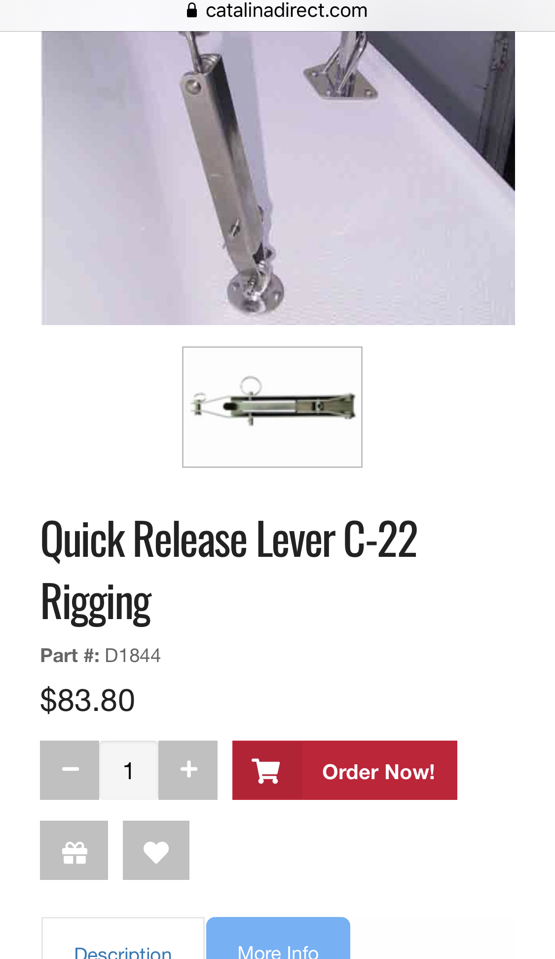

I came across quick release shroud shackles for a Catalina 22. I thought it would save about 15 minutes in setting up. I ordered one for my MH 22 since my mast and boom are closer to that compared to the 216. It is close but too short and the thread diameter is too small. Has anyone done anything like this?

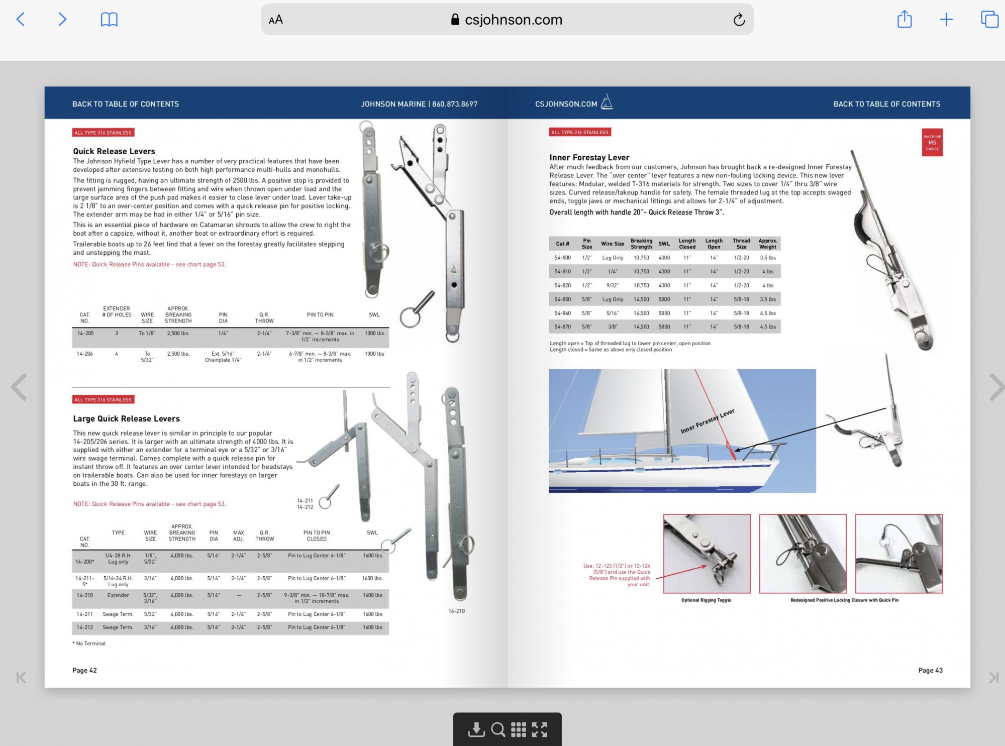

Is this what you are trying?
It looks like you take the existing turnbuckle off the swaged on stud and thread it on. I would assume that’s why it’s too short. The thread on the end of the stud would need to match the levers so that’s also a problem.
Those levers are designed to work on the standing rigging of a Cat 22 not your Marlow-Hunter 22.
You might be able to find something to match here

This is the page in the Johnson catalog link from above.I have no idea if these were the ones he used.
