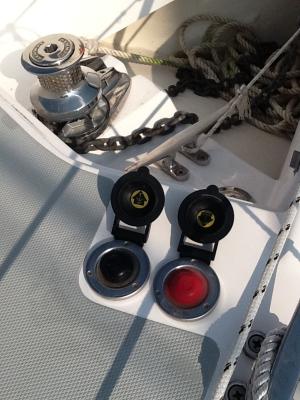

I have a factory installed Lewmar on my 2009 H36#207. Have used it about 20 times without issue. I'd be happy to answer any questions you may have on operating the windlass; but can't help with istallation.

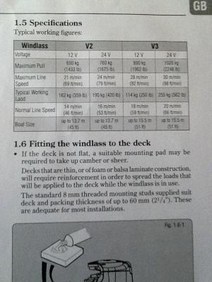

I believe it is the V2; however, it appears that the V2 and V3 share the same footprint, only the specifications are different.
Here is a shot of the manual that came with my boat and the link to the PDF from Lewmar if you don't already have it.
Good luck!
Steve
http://www.lewmar.com/Product-literature.asp

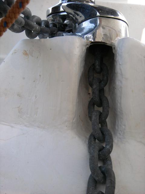

I have also a LEWMAR on my H36
I have also a Lewmar and works fine (I used it last week-end with 30 meters of chain). The only problem found on the Windlass was the gap left for the chain. After many trials it was impossible to store correctly the chain without help (with my hands). I had to cut the fiber glass under the windlass, then made a nice gap with a correct angle wich allowed the chain to falled directly without any help. I built it very strongly with two types of fiber glass and finally put some gel coat. Nobody can see the difference but now it works !!. :dance:
