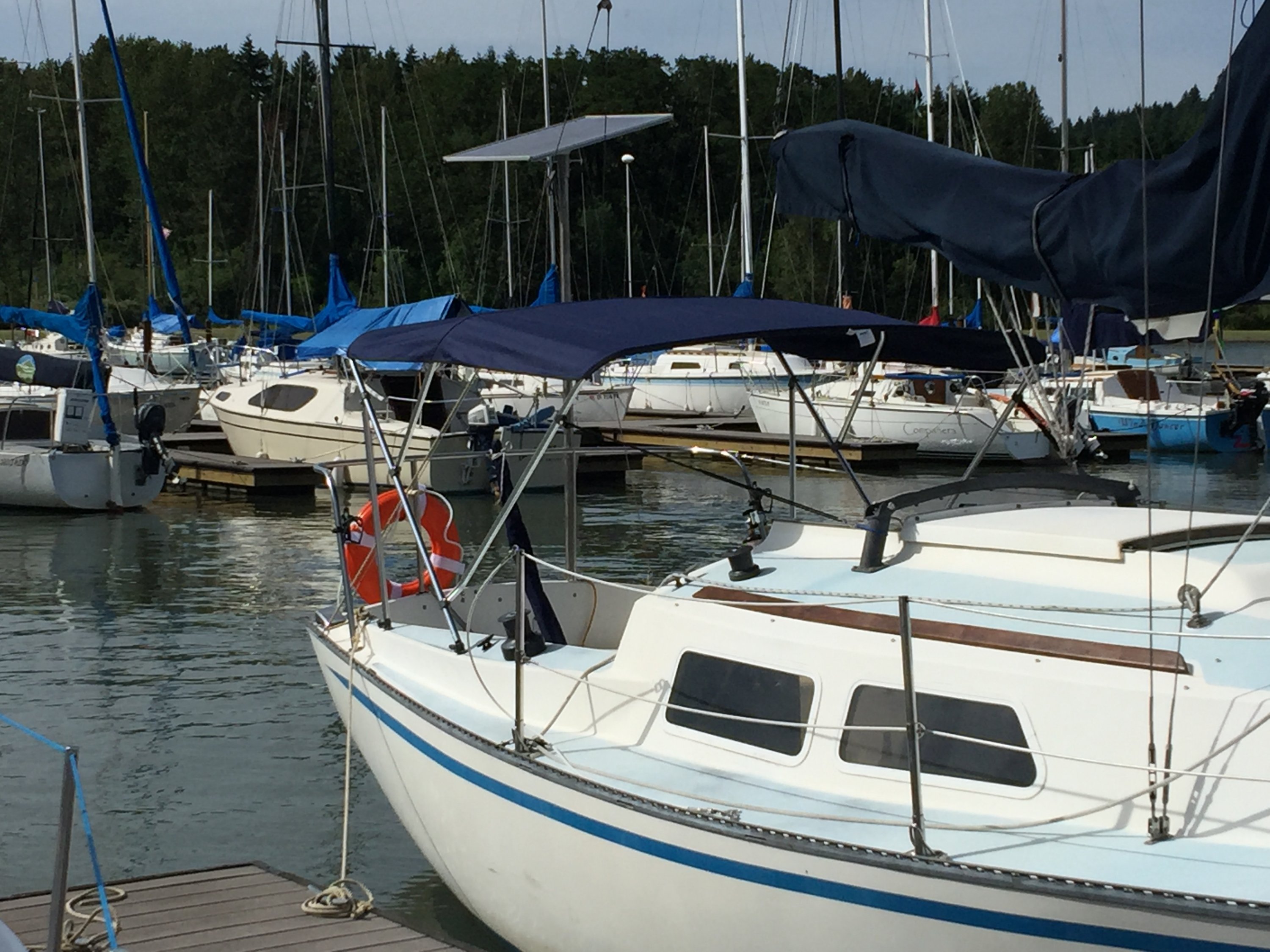

Hey,
My boat is on a mooring. This year I bought new batteries (2 for the house and 1 for engine start) . I bought that exact unit from Defender. I just want something to keep the house bank charged up when I am away from the boat. It is fine for that. It is too small to run a fridge and other high energy loads.
Barry
