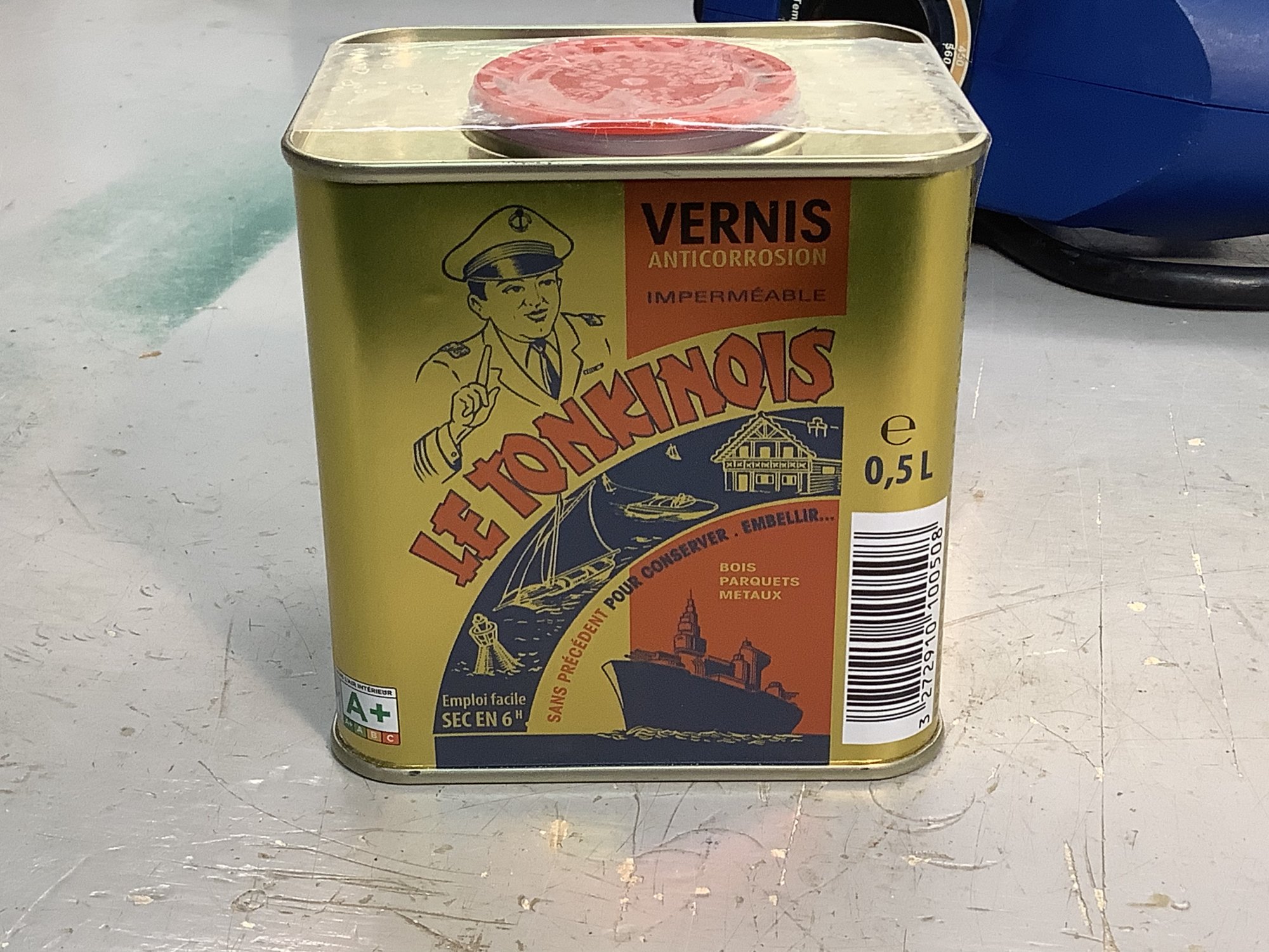

I’ve used Cetol for last 6-7 yrs. Towards the end, it looked like brown paint and it started to fail big time. The best way I’ve found to strip a finish is a heat gun and a scraper. Much faster than sanding. I‘m now going to an oil blend called Le Tonkinais or someting like that. Pic attached. It’s a mix of tung, linseed, and tropical oils invented by the French Navy in Viet Nam 100 yrs ago. They are still using it. The big decision maker is that the oils are boiled killing all mold spores which causes oil to eventually turn black. When it starts losing it’s luster, time for a coat.

Mark, I'd like to get a follow-up on this product. both, as to how easy it is to apply and how it looks. Maybe a picture.

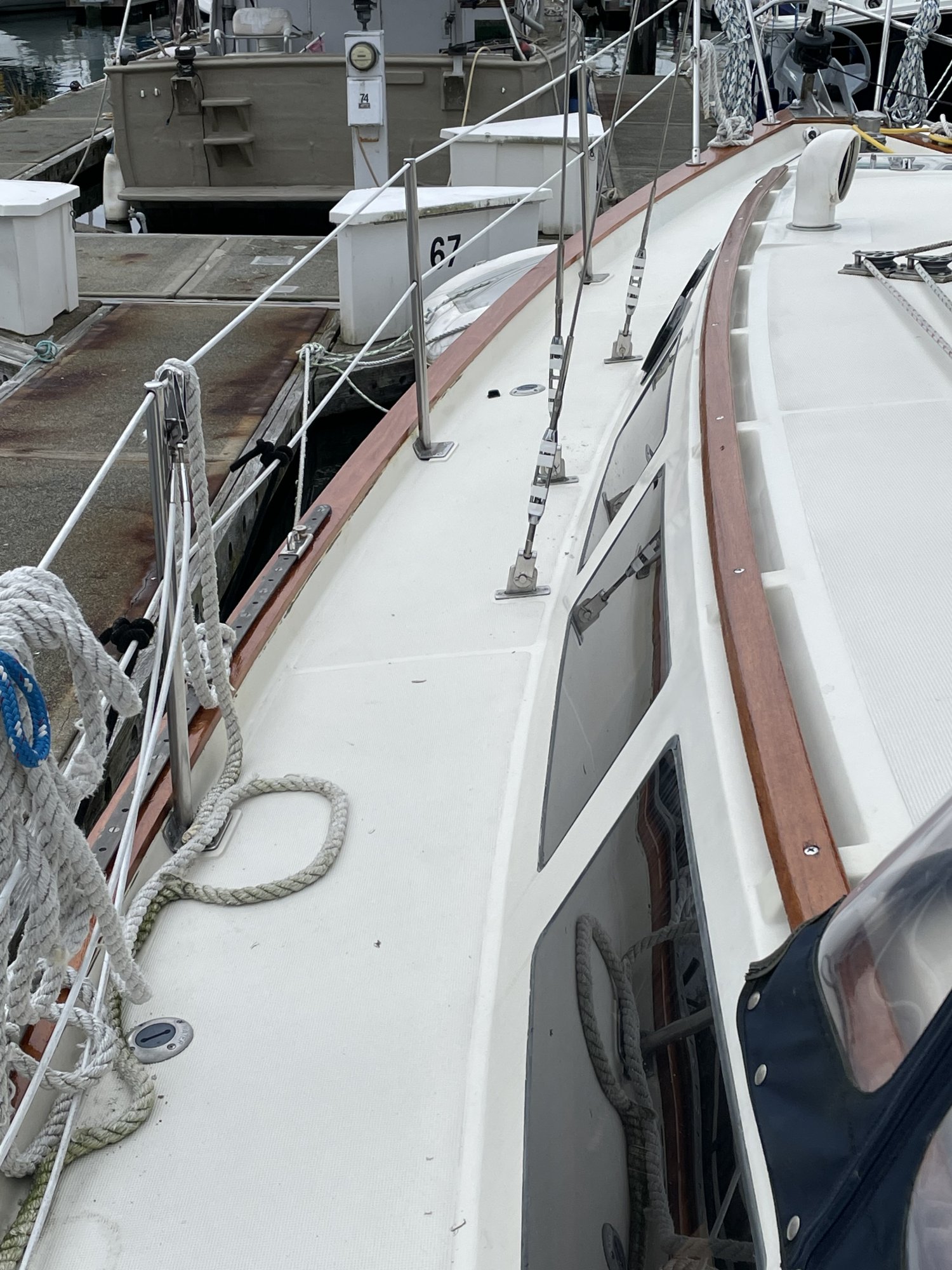

It’s pretty easy to apply. Be wary of vertical surfaces as it can start to run afterwards. Just keep an eye on it. Best results are with a foam brush. The pic attached has four coats. It is not a new highly varnished surface as the boat/teak is 43 yrs old. If I
take it down to all virgin wood, I would not have any wood left.
