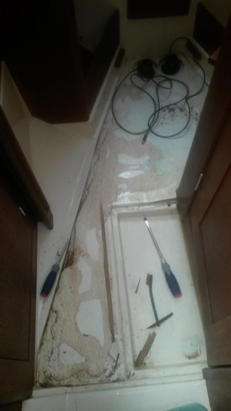

I am currently replacing the sole in my H31. The section in my v-berth is the only section that remains to be done. So far, all of the other sections were screwed in, no glue.

Thanks, DSELR, that's good news. Please keep me posted. I'm curious to see whether that piece can be removed without interference from the bulkhead between the V-berth and the head.

I went ahead and removed the sole in the V-berth over the weekend. Its a different arrange from the rest of the boat. It's 1/4" thick ply because the liner is raised in that area and supports the sole.
